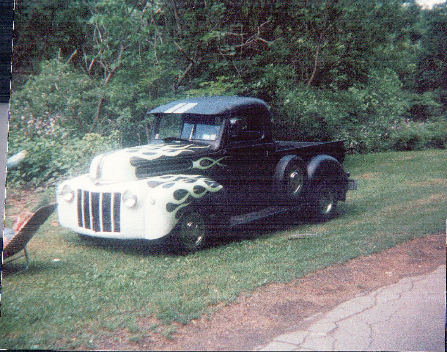

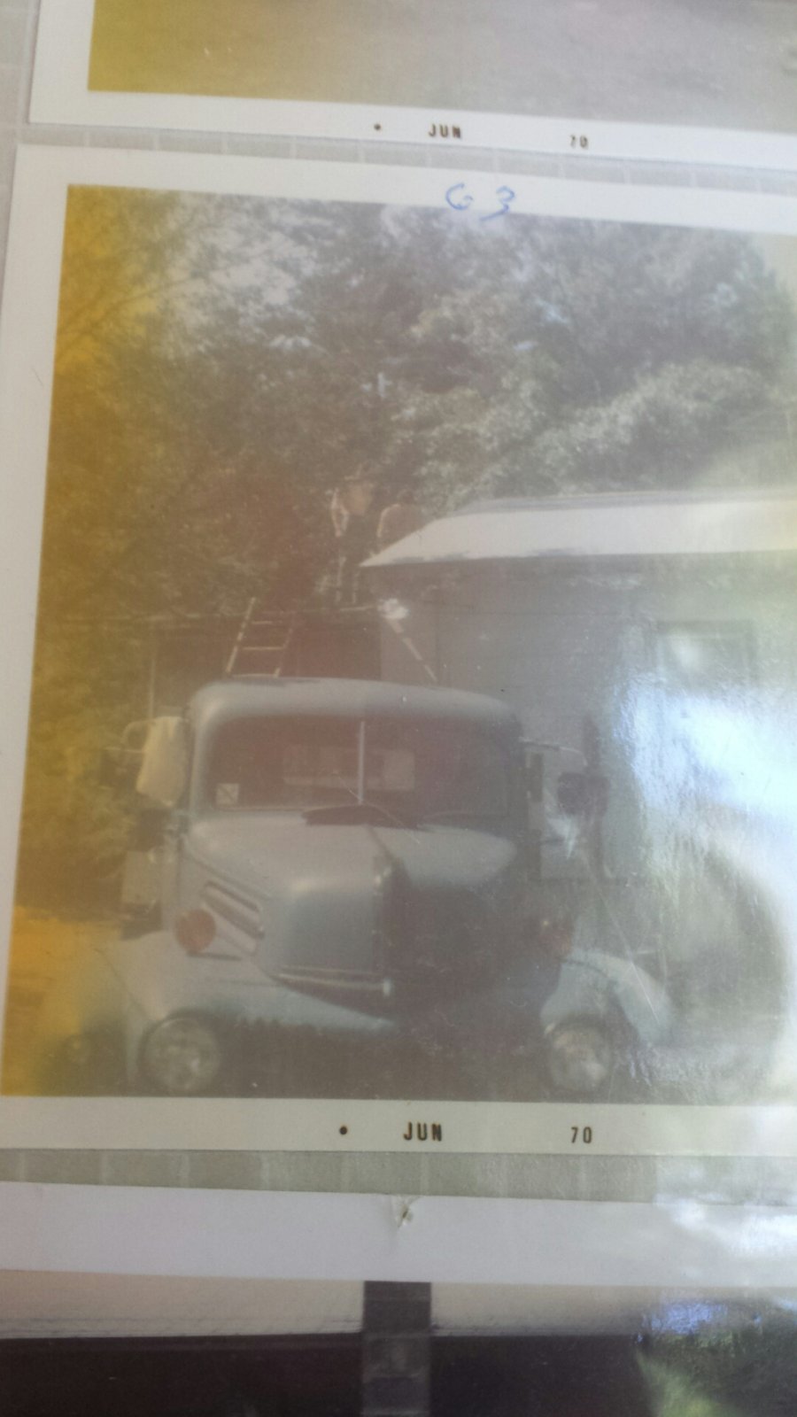

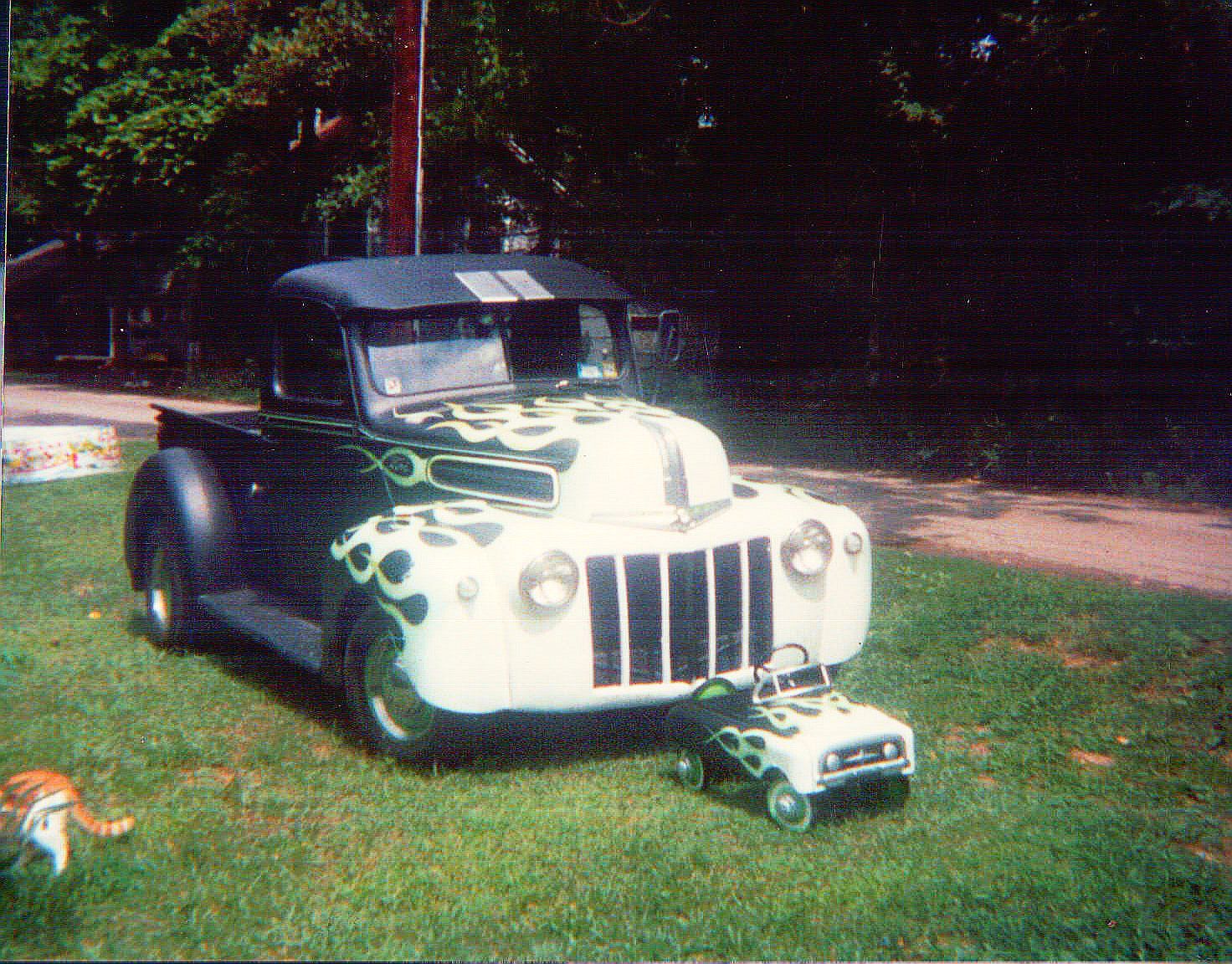

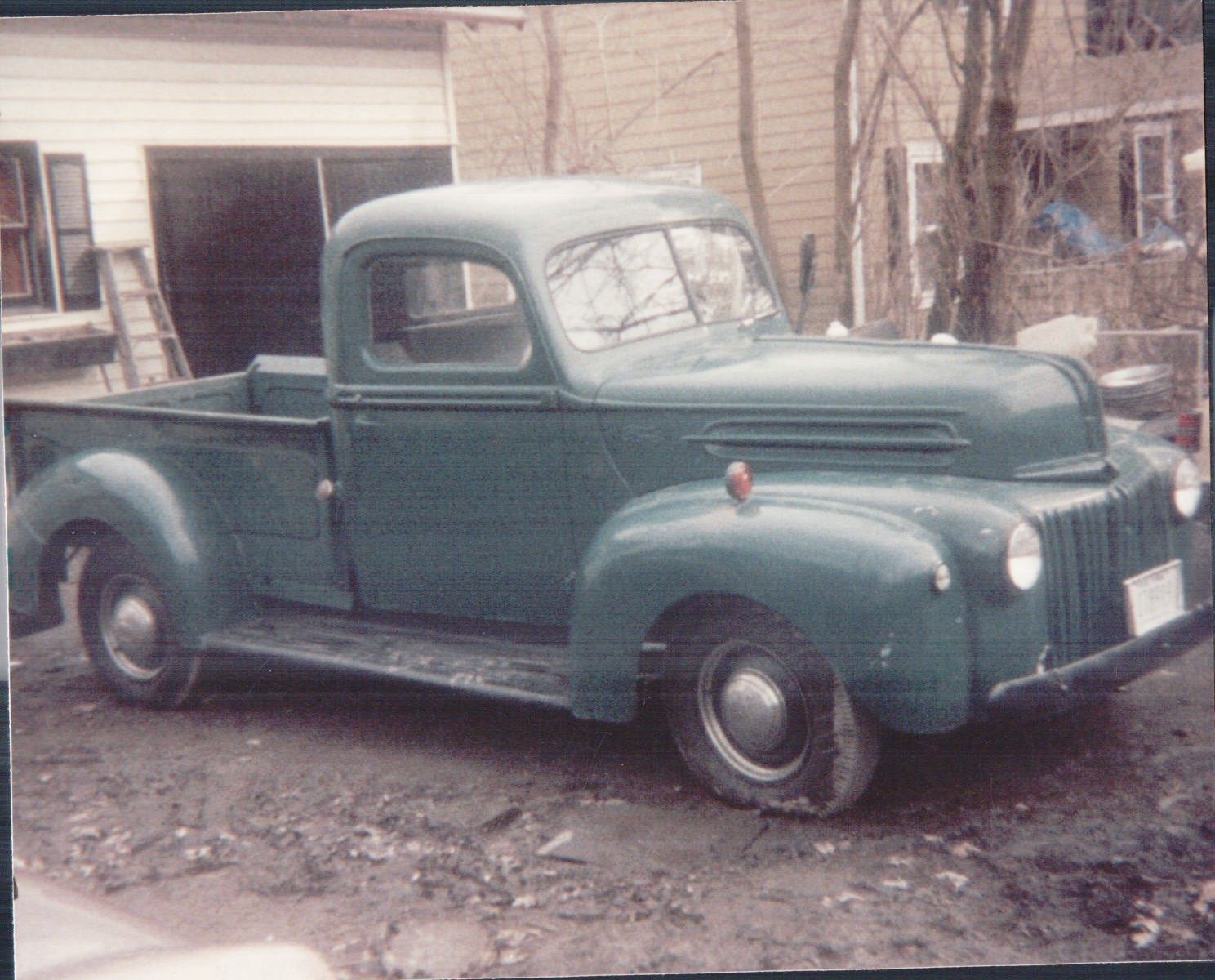

    I acquired this truck in about 2013 or 2014, its a bit of a family heirloom if you will. My grandfather had purchased it from my great uncle in the mid 60s and used it as a daily driver until 1971. While he had the truck he had swapped the original flattie 6 for an 8ba and a ford t9 4 speed out of a much larger truck.
    By the mid 70s he had Given it to my uncle who, for whatever unknown reason, decided to toss the 8ba in favor of a 360 FE and a 3.03 3 speed. he very much butchered it into the truck and left it as an unfinished project to sit in the garage for another 50 years.
    That's where I come in I always wanted to do something with the truck. I always thought it was cool. I had never seen another truck like it before and made it a goal of mine to figure out what the truck was when I was about 12. All throughout highschool I didn't do much with it other than just unearth the thing from the pile of **** that had ac***ulated on it after 50 years. I was in highschool I was broke, didn't really have any actual clue how to work on cars, and had lofty goals to make it some bad*** fast thing. Well as the years kept piling onto me I learned a lot, and that my goals then wouldn't be able to happen on a reasonable timeline. by this point I had it stripped to a bare frame and really understood that the amount of fab work that I would need to do to just get the thing to handle the dead stock 360, and that was really above my skill level and budget. this is where I will actually start this build thread.
