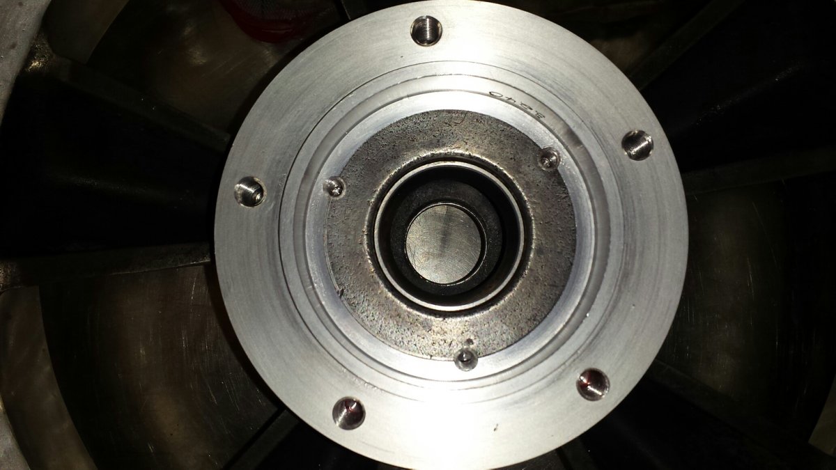

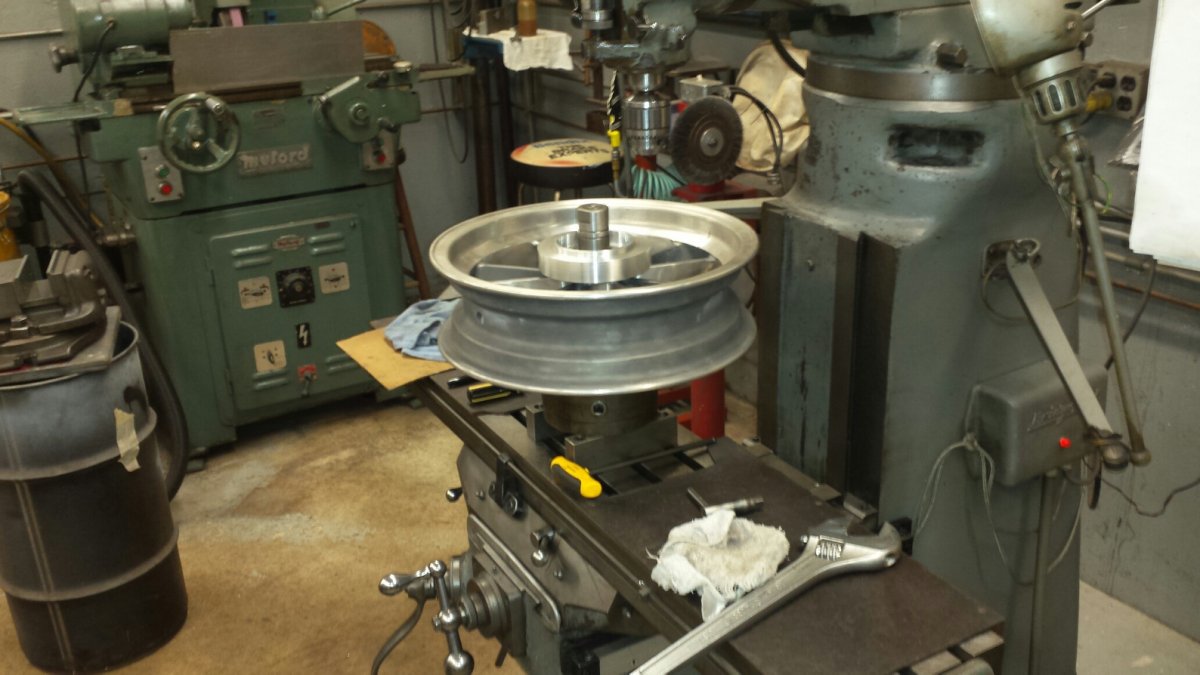

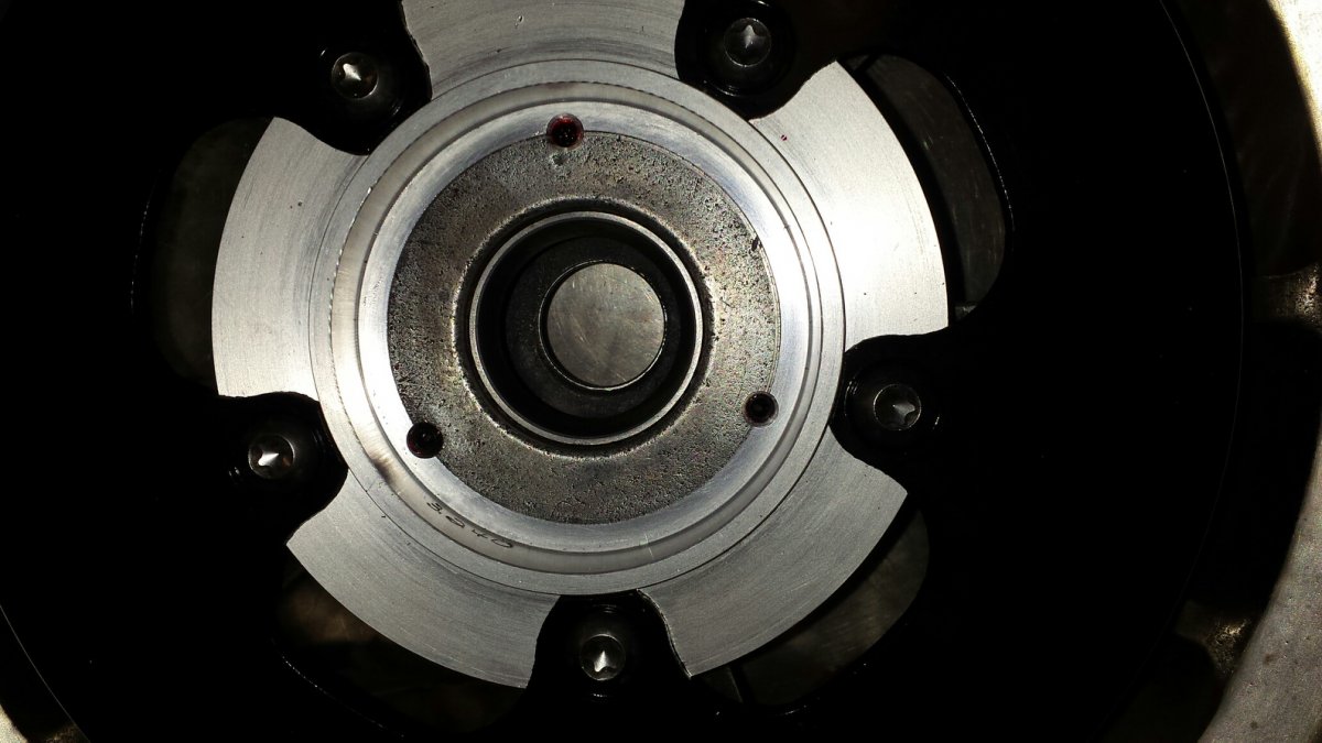

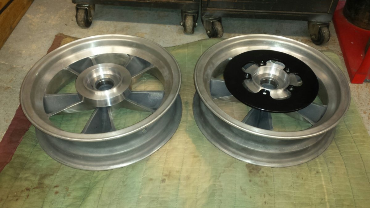

  11. a radius was put on the inside edge. The adaptors are done. The wheels went into the freezer. The adaptors in the oven 250 degrees. set for 15 min. 20151023_204054.jpg
    els likes this.
  12. They slipped right on with a .0025 interferance fit. They were checked axially and radially. only the rotor bolt holes need to be drilled and tapped for this job to be done. the tabs will be welded on after the brake pads are shimmed so the rotors are perfectly centered. its great these old wheels can roll again with the modern brake upgrade. old school cool and safe. 20151024_120755.jpg

    Sorry to see your wrecked coupe. Loved it at the meltdowns. Thanks for taking the time to post all this info and pics. Very interesting to see all the details you are doing. Will the rotor hats be pinned to the wheels or just pressed?
    els likes this.
  14. Thanks the meltdown was a great time. I want to have the rebuild donein time to go back next year. I will post more pics as i get them from tim. He is going to drill and tap holes at the parting line. He calls it a dutch joint. He plans on shipping them monday.
    els likes this.

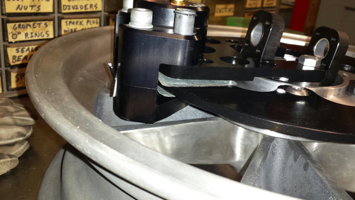

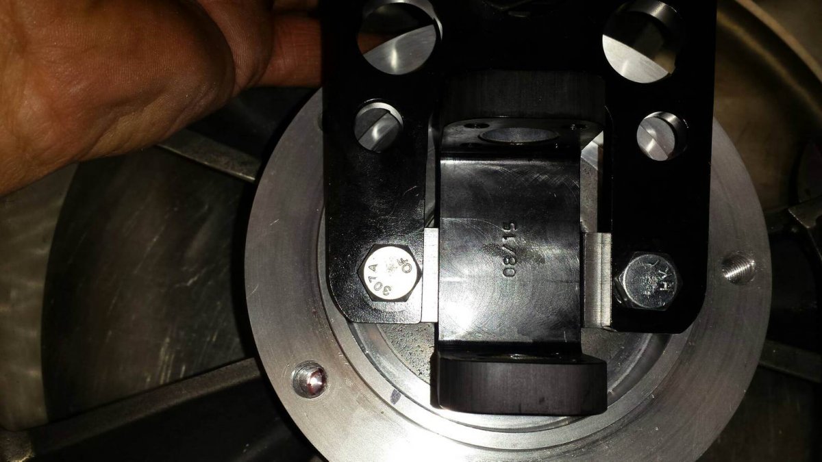

  15. just the tabs that hold the caliper in place need to be welded on. then this project is done. 20151025_172927.jpg
    els, rawcjw19, loudbang and 1 other person like this.

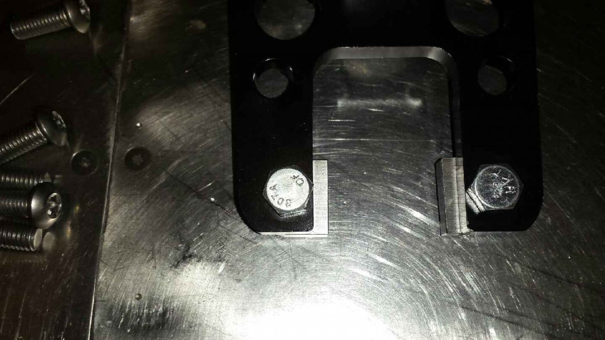

  16. 20151025_210204.jpg 20151025_225037.jpeg 20151025_225648.jpg 20151025_225635.jpg 20151025_230143.jpg 20151025_230130.jpg 20151025_230028.jpg Its all done. I hope all these pics help out anyone that wants to adapt brakes to a wheel that was not designed to have them. I now have wheels that are safe and rule compliant. Tim harris did a outstanding job. He was also kind enough to stop his work to take all of the pics. As a bonus he included his drawings when he sent the wheels back. Now the wheels go back to the polisher to finish them

  24. I stopped by the ch***is shop today with my wheels and brakes. I needed the tabs tigged onto the spindles. it all needs to be mocked up and shimmed into place first. i didn't want to weld them on with my mig welder. the tig looks so much better. they did it while i waited. While the parts were cooling off jim and i discussed whats next on the ch***is. on the way home i stopped to meet up with mike the polisher. now that the brakes are done the final polishing can be performed. sometimes i feel like I'm a general contractor organizing all these small projects. 20151029_163532.jpg

  25. With this pic the brake project is officially done. The caliper mounting tabs are on. Who ever said front brakes cant go on spindle mount americans. 20151029_212224.jpg
