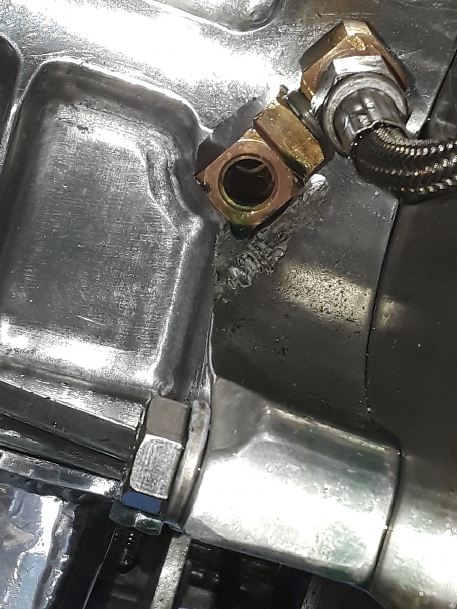

  10. For the play by play color comentary here goes. The first p*** of the day was just a burn out and a part throttle walk down the track to make sure everything worked.
    P*** two the idle is higher than normal. We were working on that in the pits. We are still not sure why it's doing that. We have a few more things to check out. We left kind of soft. It shifted fine. The engine went flat in the upper rpm range. When It feels like a rev limiter comes on its usually too rich. At the stripe the car moves hard right. I pulled the chutes to straighten it out. I'm glad I have two now. It oiled the drivers side of the car and soaked the tire. We found the oil pressure sensor that screws directly into the oil galley had some how fell off. With 100 plus pounds of pressure behind it the oil was blowing out of a 1/8 pipe hole. I had a plug so we put it in for the next p***. We went through alot of brake cleaner to clean things up.

  19. A pic of the oiled tire. The car was a mess. Also a pick of the drivers side engine. This is at the mid plate. The braided hose goes to the oil pressure gauge. The hole is were the efi sensor screwed in. That's a big hole for alot of oil to come out under pressure. 20180707_145802.jpg 20180707_155929.jpg

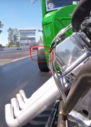

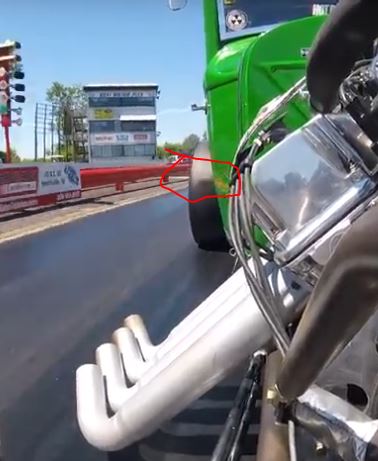

    Just as a precaution look at the two videos from the front axle to the rear view. The p***enger side slick looks like it has a bulge or "flap" hanging out you can see it very well in the first rear view one pulling up to the line and a little less in the second because it's getting darker. And again in the video Cara Marie posted above this post you can see it best when you stop down the track and start to reverse it is still visible.
    At first I though maybe a wet spot from the water trough but it never goes away.

    Believe me I'm NOT BEING CRITICAL I just want you to be safe and not have problems with a bad tire. :)
    Got some time and grabbed some screen shots of that tire. It is MOST noticeable in the first video when backing up at the 0:32-0:39 mark it really sticks out. But it is visible in all of the videos. It looks like the edge of a recap that is starting to separate but I know it isn't.
