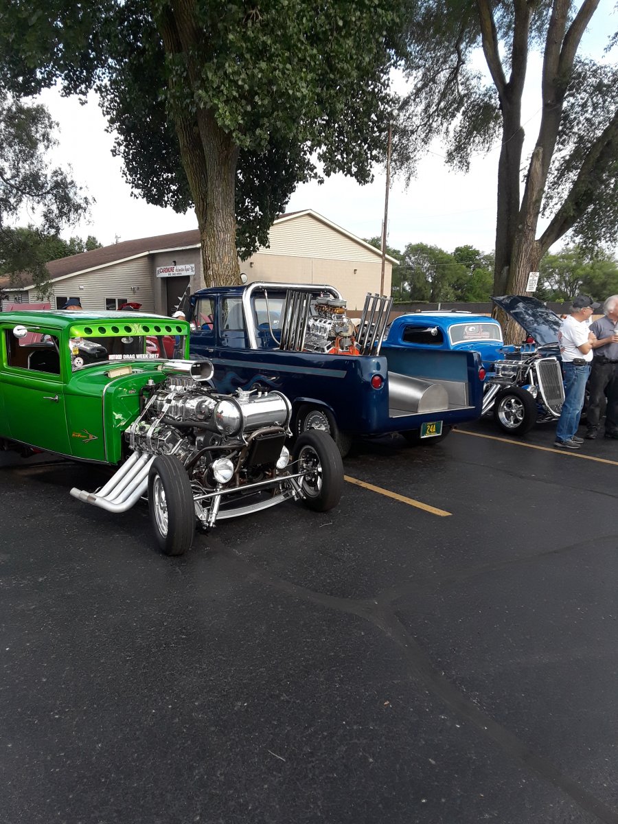

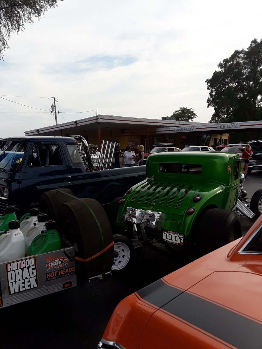

  27. The first leg of today's trip went perfect. It's 90 plus degrees out with high humidity. With the trailer loaded up and the trunk lid on the engine ran at a cool 165. Getting stuck at the gate in traffic it got up to 180. The last few years we fought the heat every time we drove it. That's why we started taking off the trunk lid.
    The efi tune up was unchanged from the 392. Driving it to the car show Thursday night showed it was lean. I was on the phone last night with Andy Starr from hilborn electronic sales.we discussed the tune up and decided to increase the entire fuel map 15 percent. It runs better but needs more fuel. I will increase the map by another 5 percent before we leave for the next stop. 20180804_115138.jpg 20180804_115151.jpg

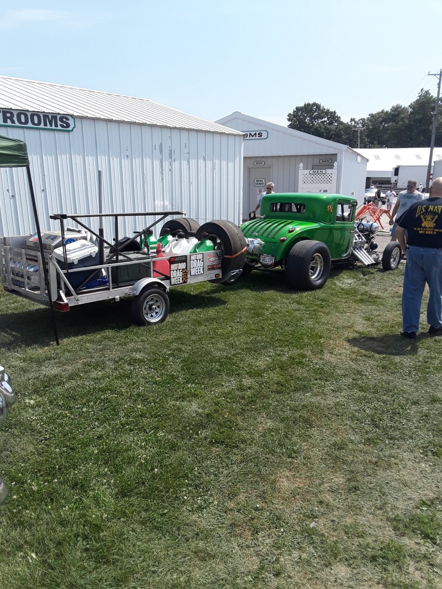

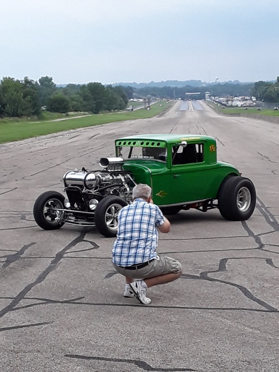

  28. 20180804_183146.jpg Part two of the drive went even better. The extra 5 percent fuel that was added made it run better. We stopped at gusses drive in located in East troy Wi. While there we added another 5 percent fuel. Two more blown cars showed up. One was a rear engine bbc wheel stander the other a coupe running mechanically injected alchohol. The alchy coupe is owned by al McFadden. He was a nitro funny car and dragster driver. I haven't talked to him in a few years. He ran the last non hemi nitro dragster to qualify at a nhra event. He did It with a Ford shot gun engine during the early 90s. It was cool to catch up with him. The last leg of the drive was up i-43 north into Milwaukee then south down i-94 into oak creek for the show at Georgee porgies. This leg would be all free way driving. Again the car ran better still without any problems. It takes time behind the wheel to get it all sorted out. Things went great today as we get closer on our tune up. Alot has been learned in the last few days. 20180804_172130.jpg 20180804_172153.jpg
