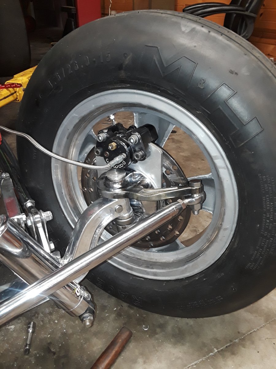

  20. It was over before it started. We got to the track and unloaded. The car was along side the trailer and my crew man noticed the driver side brake caliper looked funny. The bracket had broken allowing the caliper to shift. I took it apart and we drove to a friends house to weld it. As we were putting it back together a pro mod crashed big time. Flite for life was called. The guy broke his pelvis and collapsed a lung. He was unconscious and not doing well. The local sheriff thought he might die so they did a investigation as though he would. Turns out I heard good news today he has survived. After all that we loaded up and came home. It was 90 plus degrees and high humidity. Just miserable conditions. The track was down for hours and still down when we left. To be extra safe I'm building new stronger better caliper brackets. I took the guys crash as a sign not to risk it with my welded up parts. The brackets do to the welding changed their shape a little bit. The caliper was no longer moving freely on the pins. I didn't want to risk having a caliper lock up. While it ****s we didn't make a p*** I feel fortunate we found this before drag week.

  23. The brake bracket design worked out perfect. The new one piece caliper brackets are much stronger piece. Everything is now in line. The old ones that broke were spaced to the outside and welded together.

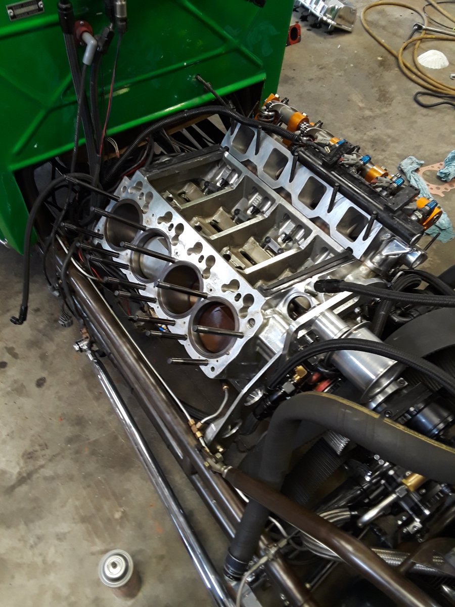

    I reused the head gaskets last week when I put it all back together after the hone job. They were leaking some coolant so tonight we pulled them off. I do have a spare set of new cometic gaskets.
    Since the heads are off I'm going to put .125 restrictor in the heads. Do to the rings having .040 gap there is some blow by on the street. It's hard for oil to run down a return hole that has positive pressure the opposite way. The br*** bolt will be cut and drilled to size. A slot will the be cut in so it can be screwed into the heads deck. We have a little bit of work to do on saturday. It should all be back together by Sunday. I like to let the silicone set up for 24 hrs if possible. If everything goes good the trailer gets loaded Monday. We leave for drag week on Thursday. 20180831_220350.jpg 20180831_220427.jpg 20180831_220412.jpg 20180831_221725.jpg 20180831_222259.jpg

  27. Some things you cane explain. I was upset last week when the caliper bracket broke. It started a week long project to make new ones. They turned out great. When I took apart the p***enger side it was also broken. The brackets were between the spindle and rotor so they are out of sight. When I was putting it all back together the outer bearing was making the wheel wobble. You can see why. I'm glad I found these things before next week.
    A days work and it's all back together. Street driving for final testing Sunday. 20180901_191755.jpg 20180901_190937.jpg
