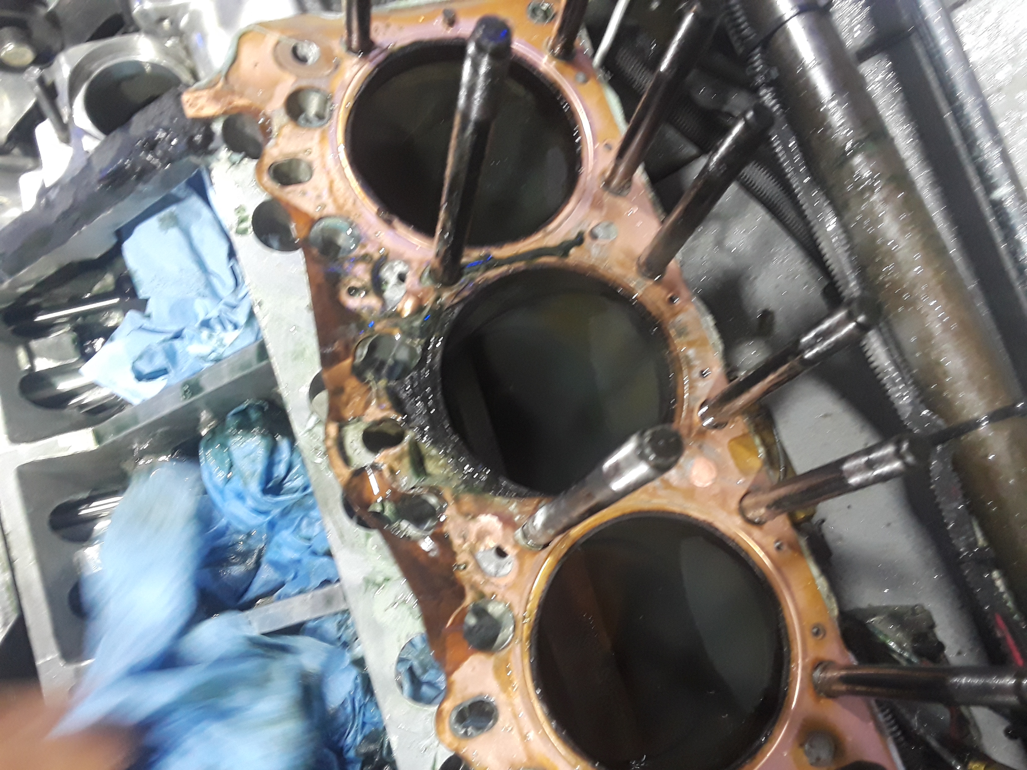

  6. There is no limit on helpers away from the track. We made it to Charlotte. We pulled up under the lighted over hang and got to work. In about 20 minutes the head was off. The cylinder and piston are ok. This cylinder was still firing. We have all the tools and supplies to fix it. The problem is the heads deck has some material removed from it. No amount of silicone will seal this up. Were done. We had the car set for some power. The mag had 42 degrees of lead. The nitro was 78 percent. When I went to the lanes I was told to go to lane 10 by the track personnel. As it turned out the unlimited cars were in lane 3. They prep the lanes every time for those cars. Lane 10 had the street cars. I sat in the car for over a hr and a half. The unlimited cars ran then the sun came out and the the track went away. 20180911_195004.jpg 20180911_193500.jpg

    Very sad - could you TIG fill that and file it back down? Or would that be too sketchy?

  14. It's too much to file. The head is easily fixed. The o ring wire is removed first. The low spots welded. The head is decked a few thousandths. Last new receiver grooves cut. On a fuel car this is very minor. I knew something was wrong as I crossed the finish line and saw stuff hitting the windshield.
    When you set out on these adventures anything can go wrong. Either you accept this fact and go for it or you stay home and never experience living out your dreams. I dream big and it doesn't always work out. When it does it's all worth it.
    Coach Vince Lombardi had a great quote. A man is not judged for getting knocked down. It's how he gets back up.
    I already spoke to roger. The head will be fixed soon.

    Ive been wrong before, and since I am married I will be wrong again. I thought for sure that you would have it fixed this morning, but I also know how long it takes to het a head fixed that got wrecked. What caused the head to get eatin away like that, was it the Nitro, was it a spark ark, or just pressure? Good to see ya went after it again. Thanks for the show.

    I know of aluminum heads cut all the way to the outside with a furrow you could pay a finger in, and repaired. Just goes to show the heat nitro can create. Sorry about the bad luck but look forward to the next act. Really one bad*** car and driver.

  28. The damage was caused by steam. The gasket leaked causing communication between the water port and cylinder. There is no black death anywhere. In the future the water will be drained out prior to a run.
