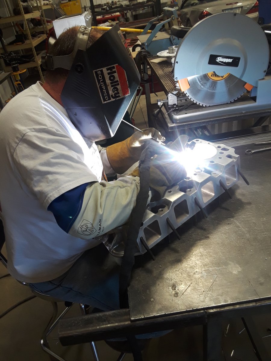

  26. 20180914_134542.jpg 20180914_143120.jpg 20180914_165241.jpg 20180914_181119.jpg 20180914_181129.jpg 20180914_185945.jpg 20180914_185952.jpg 20180914_190952.jpg Any one that regularly follows this thread knows I don't waste time fixing problems. I was up early to make the five hr drive to cedar falls Iowa. It was determined the best way to fix it would be to weld the low spots. One of the crew members from the orange crate dragster has a shop in cedar Rapids. Scott is a incredible welder and was willing to stop his work to do his thing. It only took about 15 minutes. While it cooled we caught up on our lives.

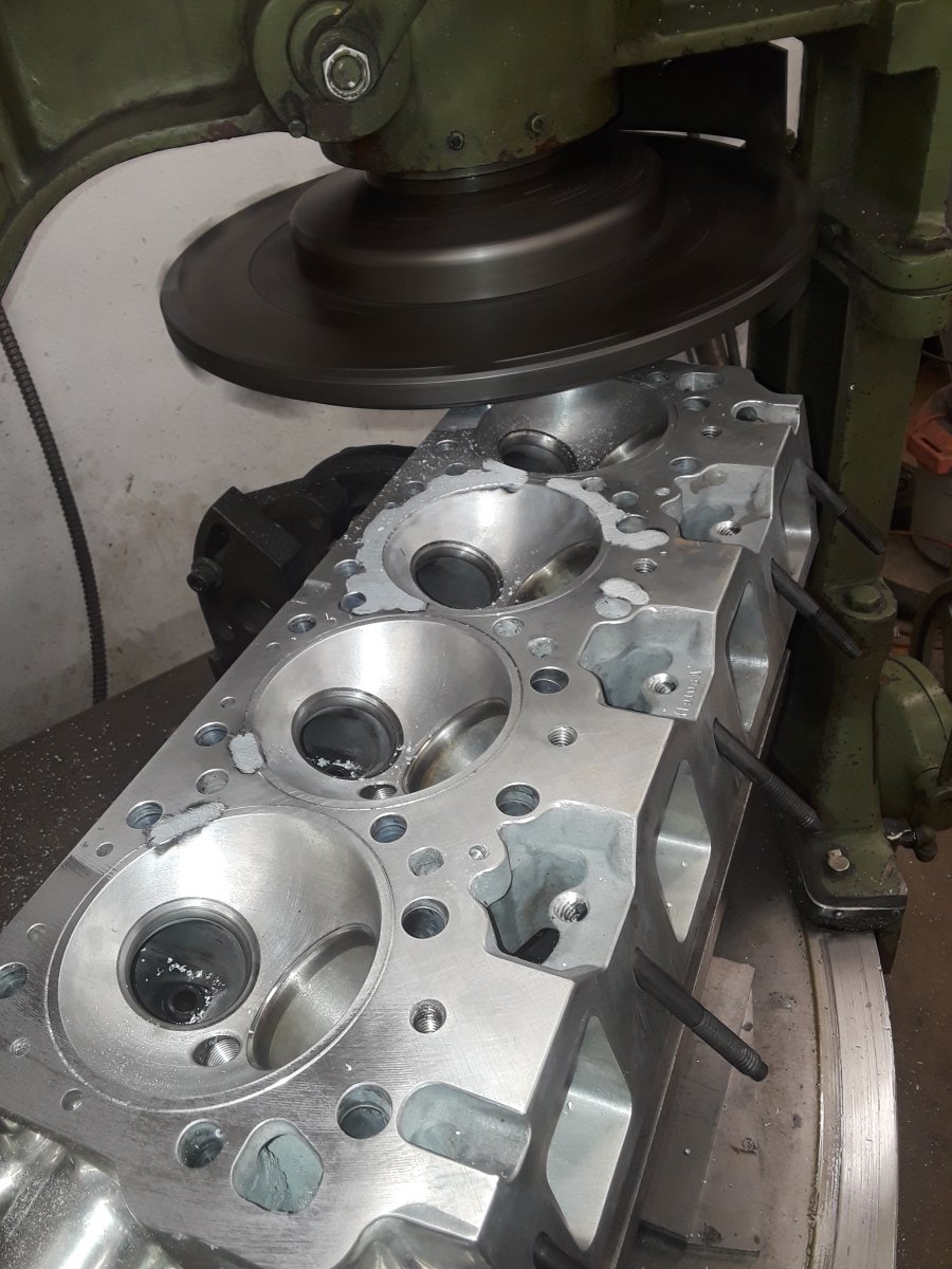

    Up next was the resurfacing. It took .005 to clean it up.

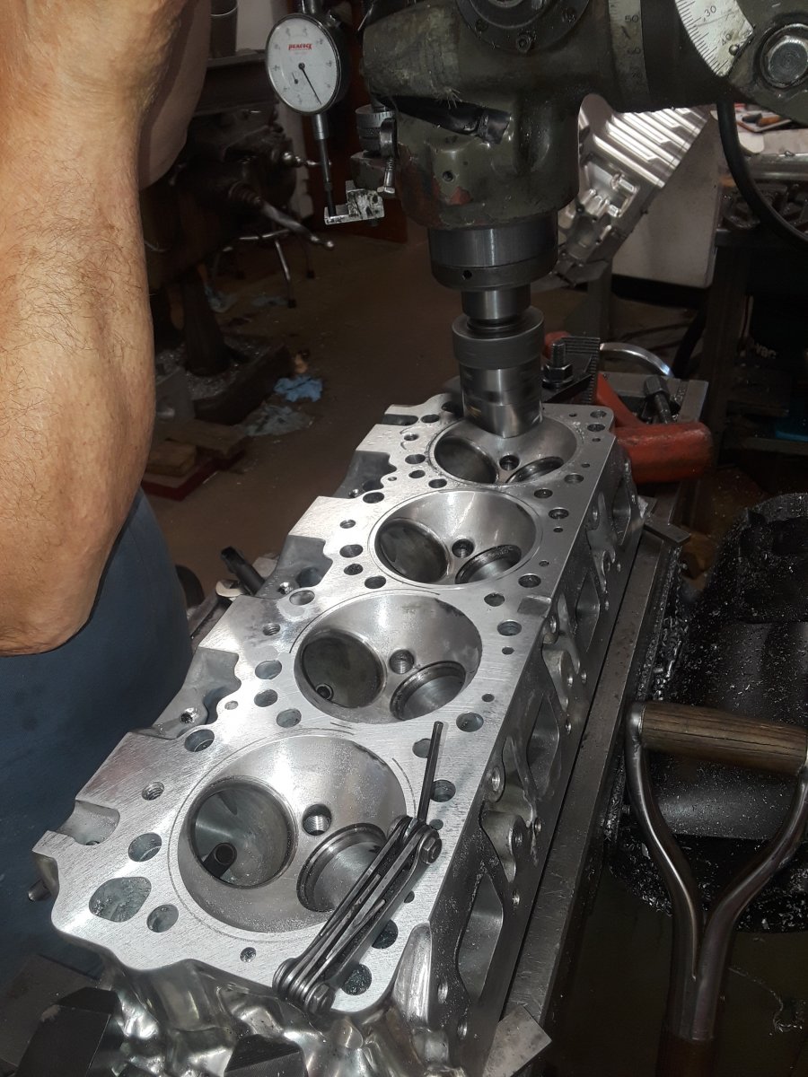

    Then it went in the mill to cut the receiver grooves. This critical step is very delicate. The tool has to be perfectly centered. If it isn't the groove will be too big and the wire will fall out.

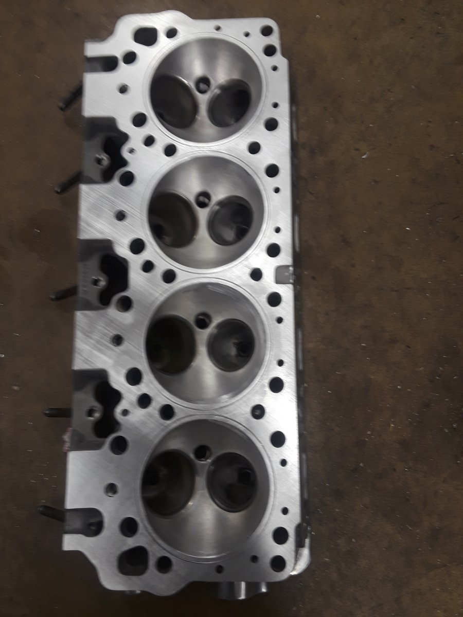

    New wire is gently tapped in. This is another delicate process.
    A light touch with a tootsie roll on the combustion chamber edge and its done.
    Work like this goes on regularly for a team running a fuel car. In fact this repair was very easy. It's a different story when the ends of valve are sticking out of the combustion chamber like frisbees or torched chambers or piston to head damage.
    While this job was straight forward it was too much to do on drag week. There just wasn't enough time. View attachment 4033102 View attachment 4033103 View attachment 4033104 View attachment 4033105

    Wow, quite a few spots got some weld fill. Nice work following closely. Love the car & your story

    Machinists are amazing in their craft as well. The Rockets wounds have been mended...
    I guess in my naivety I thought you were going to run without surface repair...that is obviously not what was part of the plan. That is comforting.

    Neat, and look at the guys fingers, he's done this before!
