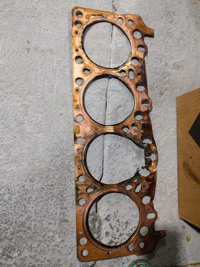

    The groove stayed as is. It accepts a .041 wire. After the groove is cut a small ball peen hammer is used on the edge in a light gentle tapping motion. This rolls the edge to trap the wire. Before the wire goes in a sanding block is used to remove any sharp edges. It's the little things and extra effort learned from expeeience that makes this repair a success.
    I had .043 gaskets in it all year. We thought to gain a touch more compression we would try the .032s I had. After a close exam of the blown gasket it's possible it was not strong enough. It will go back together with the .043 set. Nitro engines are a different kind of animal.

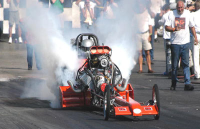

    Scott is doing the welding, Roger is doing the machine work and clean up. The Orange Crate is a nostalgia top fuel dragster. Scott was on the crew and Roger was the driver. Roger now drives the Nitro Madness fuel altered. Radar-Finals-BO.jpg Radar NM.jpg

    Man that head gasket is ugly.

    but it's an excellent picture of it. my picture is not as nice.
  24. The gasket has been added to my wall containing my offerings to the gods of speed. Every part has a story.
