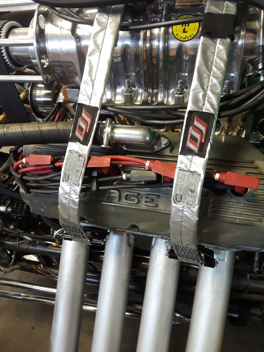

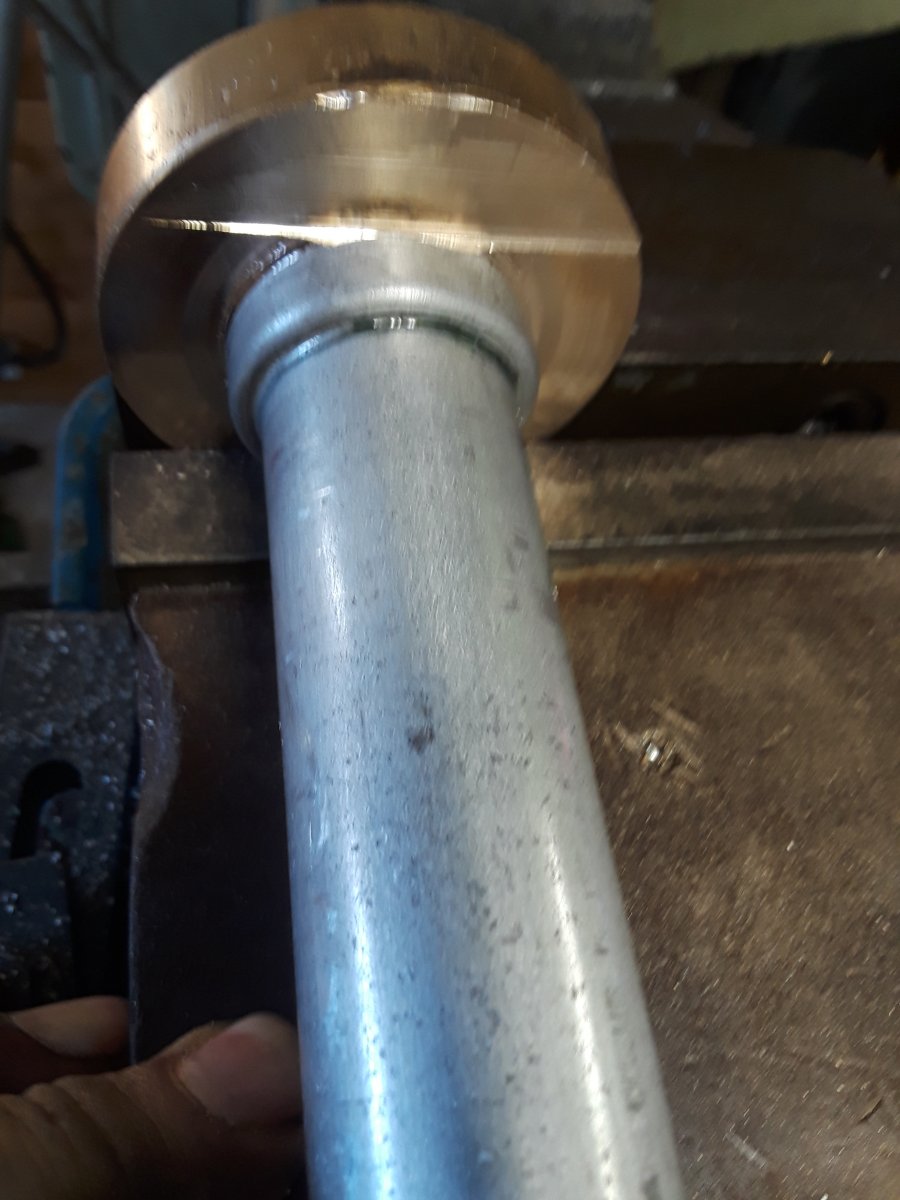

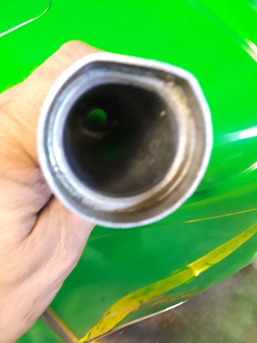

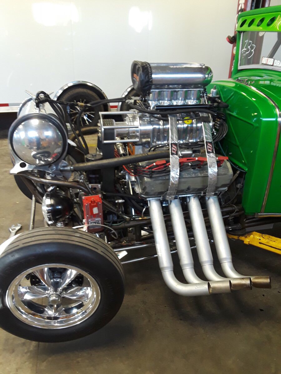

  21. 20181016_162756.jpg Usually by mid summer I have a idea what is going to change for the following year. I have mentioned I'm going with a 16 plug set up next year. The heads are twin plug capable after I drill and tap the second plug hole. The holes for the tubes and o-rings are already in them. I scored a set of nos magnesium stage five covers at bowling green this summer. I already had a set of red wires so all I needed to do today was put it all together. The old covers came off so I could remove the breather castings. I drilled the cover stud holes .025 over so they go on and off easy. I then made a fixture out of some s**** so I could hammer a flat on one side of the tube. The flats from one pair match up. I didn't want the tubes looking all beat up so the fixture came in handy. It turned out nice and clean. The red wires will be for the efi. The black for the mag. The msds will also be matching black and red. I think it's looking kind of top fuelish. I just need a 4 inch offset mag drive.
    I removed the dual drive and mounted the pump directly to the pump extension. The quick connect was removed at this time because I dont need it now. The pump can be disconnected by loosening the pinch bolts. The pump moves forward to disengage it for street driving. The lines and cable still fit saving me some time and money.
    I'm doing all this work so I can start it on gas then turn on the mag set at 50 degrees of lead. It won't start on 12 volts with that much advance so we are going to try this way. The difference in horse power going from 38 degrees to 50 is several hundred. So it's worth the effort. 20181016_153730.jpg 20181016_153746.jpg 20181016_153852.jpg 20181016_154931.jpg 20181016_154939.jpg 20181016_155115.jpg 20181016_114745.jpg

    So I think I understand the EFI side, but what spark plugs and spark sources are in play running nitro? Will you have two 8-plug mags? If so how do you change over one set of plugs from EFI to mag? Or do you really only need one plug on mag?

    Instead of efi, might Brian mean hei? Hei for the street ignition and magneto for race ignition. Yes? No???

    Let's see how close I can get. He meant EFI, not HEI, as the distributor mounted in the "stock" location works with the EFI via MSD box IIRC for street driving. As for the dual plugs, one set will be for gas and the other for fuel. Last I knew, he runs the car on fuel with the EFI completely turned off, so only one set will fire while running fuel.
    If I were a betting man, I'd anticipate seeing a dual mag setup (think modern top fuel) where one is the mag and the other is a gutted mag housing setup to function as the distributor while driving on the street.
  27. champ scotty 58 has it figured out. the efi is controlled by a fast xfi-2 computer. both the spark and fuel are controlled by it. the nitro side is fired by a msd 20 amp mag. it will fire one plug. mikey the tires are mh i will have to look at them if you need a exact size. i think they are 26 inch.
