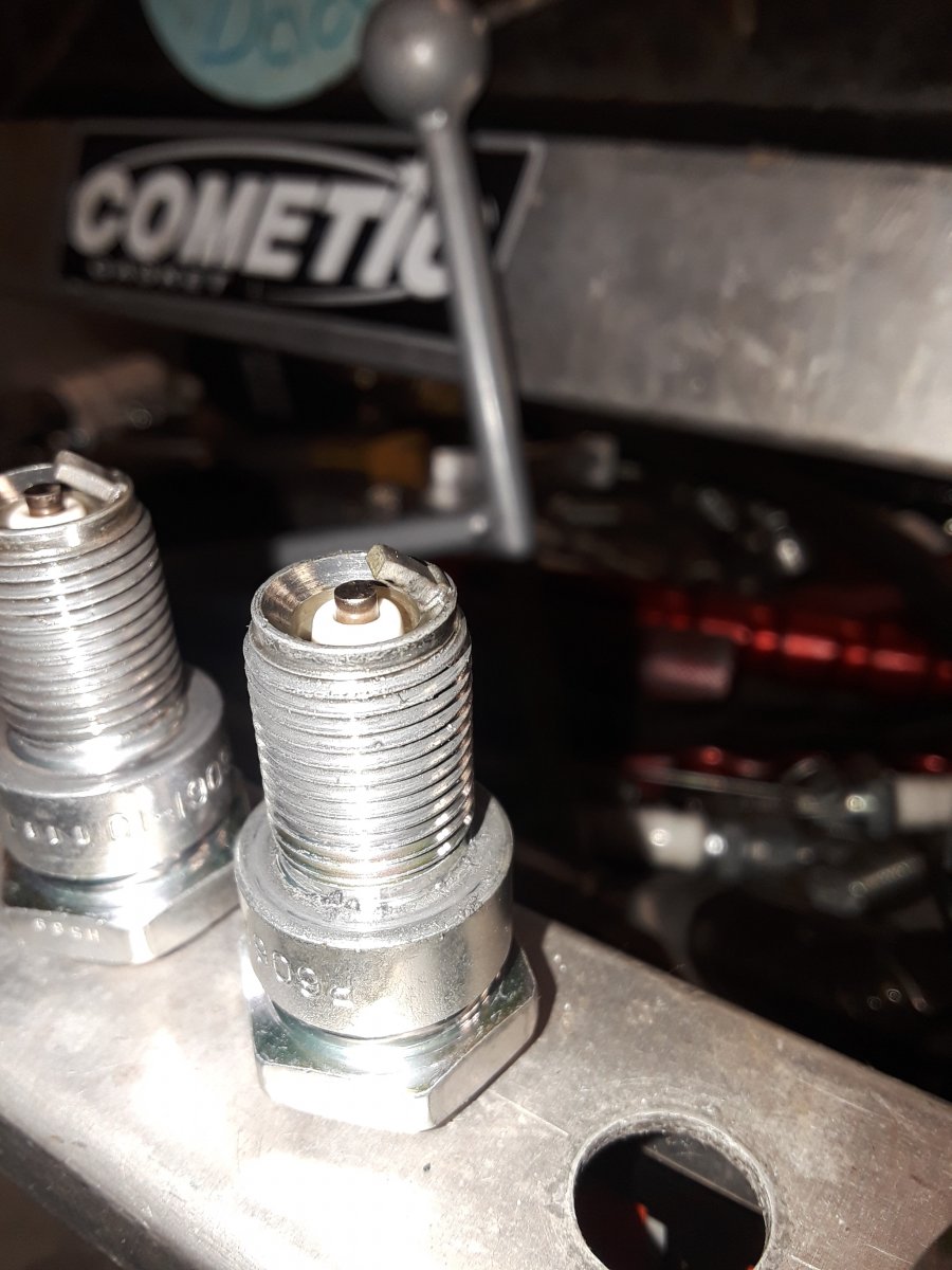

    Are the plugs different for the nitro than gas?
    Stogy and loudbang like this.
  3. Yes the nitro plugs are very different. I will get a pic of one for you.

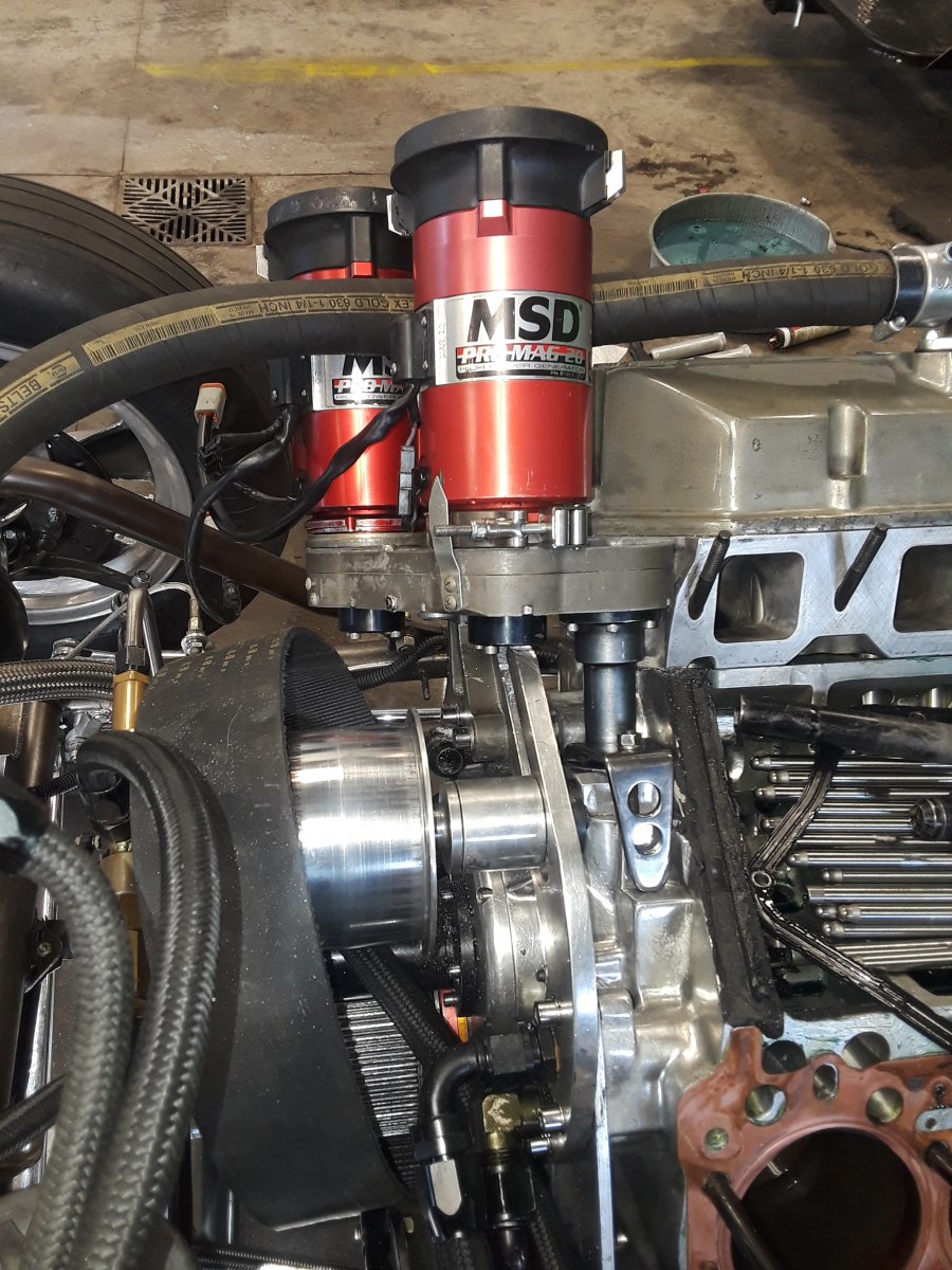

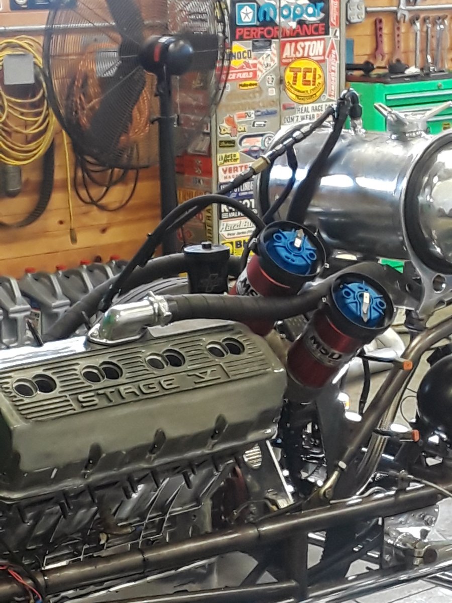

    The offset mag drive showed up today. This magnesium beauty is just what I needed. It not only drives two mags it moves them forward on the engine. This is necessary do to the diameter and height of the generators. It allows the p***enger side valve cover the room it needs to be removed. The small bracket bolts to the area were the water pump would go in a stock application to provide support. The support is needed with all the weight hanging out front. The drive is belt driven. There is a belt tensioner adjusted from the side. The oil pump intermediate shaft doesn't separate from the drive. It's all one piece. I will use quick clamps to hold the mag and efi distributor in place. This is a cool piece that's not usually seen in a street car application so I thought I would take some time to explain it. 20181018_211045.jpg 20181018_211109.jpg 20181018_211124.jpg

    So can you adjust the timing of the two distributors separately?
    Stogy, Hemi Joel and mad mikey like this.
  7. Yes. The base stays locked in place. Each distributor has it's own clamp. They can be turned individually. The mag will be set at 50 degrees. The efi distributor is set at 36 degrees.

  8. 20181019_220443.jpg 20181019_211215.jpg 20181019_205754.jpg 49 caddy man we use ngk side gap plugs set at .018 gap.
    A few trial fit pics. The rt. corner of the intake had to have some material removed to make it fit. The idler pulley bracket needs a little taken off it to. I wanted to check the fit before I removed the heads.

    Do both street & nitro plugs stay in the head when doing both kinds of driving?
    Hemi Joel, chryslerfan55 and loudbang like this.
  10. Yes. The street plugs won't foul out during the short time it's on nitro. During the street driving I dont care if the nitro plugs go bad because I put a new set in before each p***.
    I really dont think they will carbon up as long as the tune up is correct.

  12. View attachment 4082050 Good thing I did a trial fit before I took the engine out. Nothing fit. I had to cut a boss off the head. The boss was tapped and used to mount the alternator in a stock application. The idler pulley bracket was hacked on. I will need to make a new one that's shorter. The support bracket was too tall. It ended up in the mill to remove .125 off the top. The bracket also required some work to clear the water fittings. It's all good now. I borrowed a mag from a friend so I can make the wires. I have been burned in the past thinking things will all fit and then they dont. 20181021_154723.jpg 20181021_154558.jpg 20181021_154418.jpg

  14. 20181027_134146.jpg Before it comes out alot of work needs to be completed first. Of course nothing comes easy. The idler pulley hits the dual drive before all the slack is out of the belt. Getting a new belt is a call away but getting the right belt can get complicated. The centerline from the crank to the blower needs be measured. Then a wire needs to be wrapped around the existing pulleys for another measurement. Using a belt chart along with the pulley tooth count the correct belt can be selected. In my case I needed to change the lower pulley from a 61 to a 55. The top pulley went from a 48 to a 44. This keeps the ratio close to 25 percent over and allows one of the available belts to fit. I wanted to get this sorted out while I had a chance. The other big project was moving the shifter back 2 inches for a more comfortable position. Spacers were made then attached with the Lenco on the bench. The linkage needed to be modified for proper shifting. The trans went back in the car. The floor needed some slight t*******. The boot wouldn't cover the now larger hole in the floor. I had some extra sheet metal that was already powder coated that matches the floor so a piece was pop riveted in place. Making the hole smaller is also a safety thing. Less fire can come up through the floor. Another benefit is I can reach the fire bottle cables better with a gloved hand. Once you experience a good fire you think about these things. With the shifter back the p***enger seat had to go back. I moved it 3 inches. The floor brackets had to have some material added so they could bolt back in place. My drag week p***enger is over 6 feet tall so I'm sure he will approve of the extra leg room. There are a few other things planned. Stay tuned in.

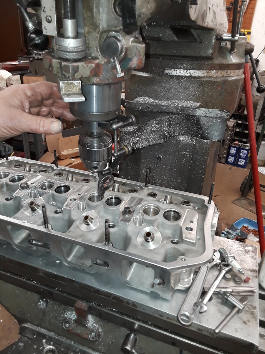

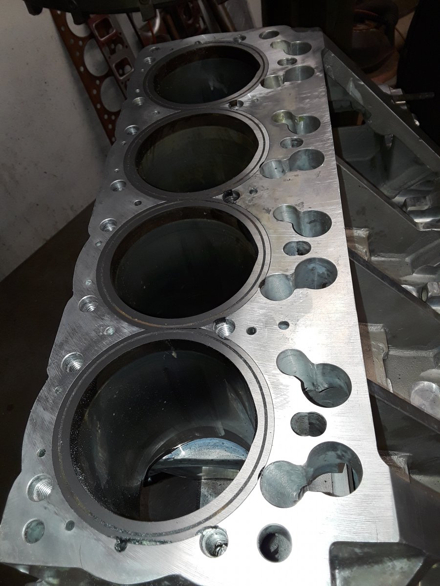

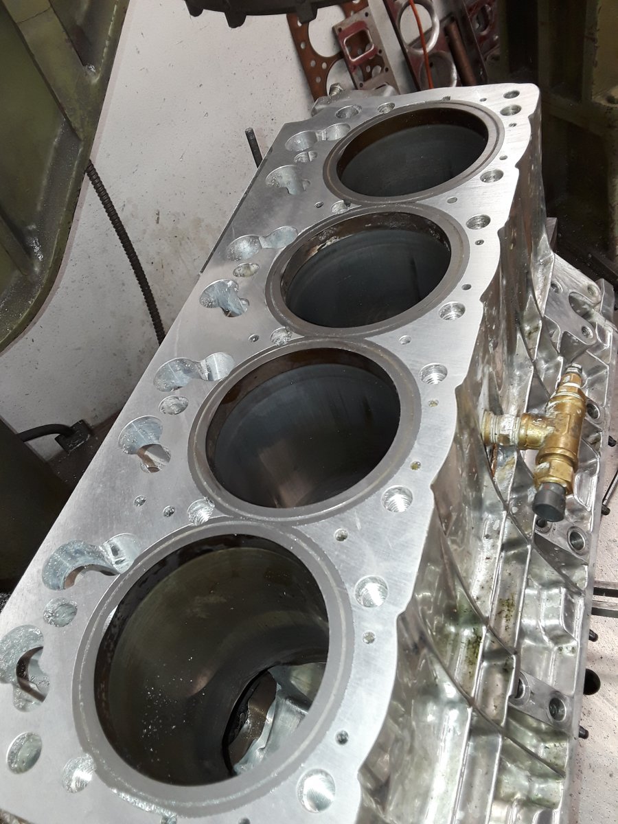

  26. I was off to see the wizzard the wonderful wizard of oz because because because of all the wonderful things he does. My wizzard resides in cedar falls Iowa. As I get ready for next season I bring you more nitro hemi tech that most likely wont be used by anyone here. The positive side is you can learn something. I checked the deck on the block. It was a mess. The sleeves were .004 above deck. This is normal on a race only engine as it helps seal the cylinder. On a street engine is nearly impossible to keep water in it because the head is held up off the deck. There were several low/ uneven areas. We cured that by taking .007 off both sides.

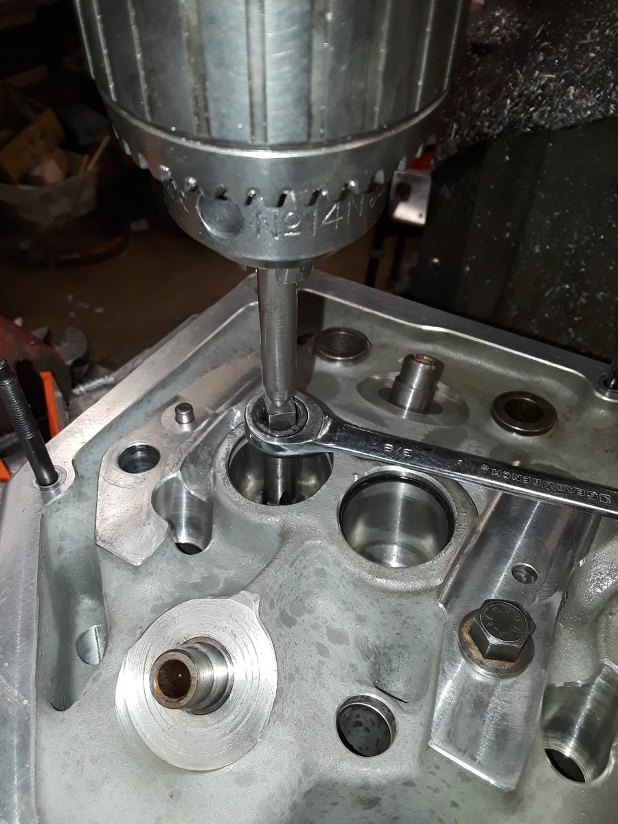

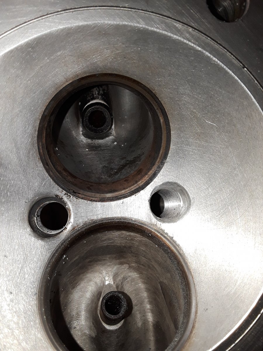

    The heads were drilled for the second spark plug. Some of the work was already done by stage five. The tube hole and o ring groove were pre machined. A target for the spark plug was also pre machined. The second plug hole is at a compound angle to the existing plug. The new hole has to go in at the exact spot. It has to clear the valves and fit in the plug tube. There is no guessing and no second chance. During the early 90s roger was doing all the repair work on John forces heads. He made a cool fixture to aid in machining post repair. There are a set of dowel pins to locate the head. What looks like bolt heads are really spacers to hold the head up so the o ring wires wont get damaged. The fixture has threaded holes to hold the head in place. The bottom of the fixture fits tightly into the grooves of the mills table as its bolted down. The proper indexing prior to drilling it was then repeated after moving the table the distance of the bores spacing. The new hole was tapped by hand with the aid of a center placed in the head of the mill. This ensures it's going in straight. After they were all in the hole on the combustion side was sanded smooth.
    While the heads were apart I checked the springs and valves. We changed one exhaust liner. The seats and valves looked great so a light lapping was performed. Do to a snow storm on the way I cut the visit short. The heads will go back together at my place.
    I talked about o ringing around the water holes but after seeing how uneven the deck was we chose to try putting it back together as is. Aluminum blocks do settle some as they season. 20181116_150242.jpg 20181116_151001.jpg 20181116_173904.jpg 20181116_155148.jpg 20181116_175936.jpg 20181116_172231.jpg 20181116_190946.jpg 20181116_175003.jpg
