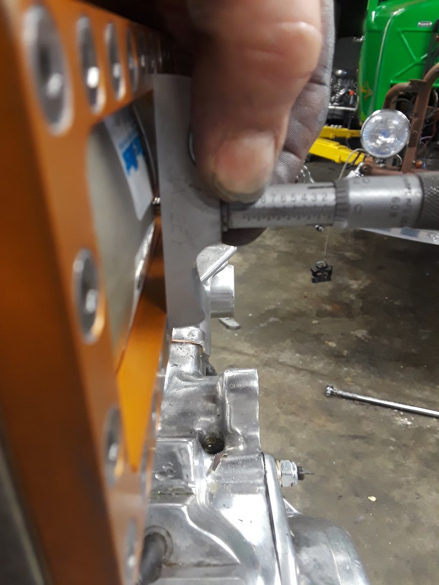

  22. 20181231_130104.jpg 20181231_144131.jpg You guys have made it clear you like the tech stuff I post so here's some more. This is all about burst panels and maintainance. The burst panels are mandatory in the faster blown cl***es. The street version uses springs and a pop off plate. There purpose is to relieve pressure if there is any kind of back fire on the intake side. There is alot of fuel being injected into the manifold. If anything on the intake valve train should fail a valve could be open when the cylinder fires. It would light all this fuel and cause a big explosion. The blast could break the manifold. The blower could also go flying off the engine. There are several safety items that are required. The burst panels are perforated on the inside so they break under pressure. The blower studs are aluminum to shear. Between these two items the pressure is relieved in the manifold. Blower straps hold the blower on the engine. All parts are sfi rated. checking the stretch of the panel is regular maintainance. A depth micrometer shows in the first picture the panel has stretched. Picture two shows the new panel in place. The old panel stretched .100 over time. It's easy to see its bowed out. The more boost generated requires more frequent changing of the panel. Pro teams change them after each run. when a panel blows out there is usually a fire ball that flies out to. on a late model hemi the plug wires going to the drivers side go in front of were the panel is located on the manifold. to prevent them from being melted we wrap the wires in a fire proof material. sometimes the explosion is so big the panel cuts a wire or two as it comes apart. ATTACH=full]4144231[/ATTACH] View attachment 4144232

    Brian, does the panel burst out a little each time or did it do that in one run? Do you know when it happened, or what caused this one to bulge. I ***ume you didn't wreck any valve train. Im getting closer with every part that shows up, cant wait to get back home and get started on it.

    Good tech post on the burst panel Brian. I saw Mike F. blew his panel out on Drag Week 2018, no damage to his blown hemi. He replaced panel and continued on .

  25. They stretch a little every time they are at max boost. They stretch even more with each small pop through the intake. Tony all those little pops trying to start the car at rock falls in the 30 degree air are bad on a panel. They were not enough to blow out the panel but they did stretch it.

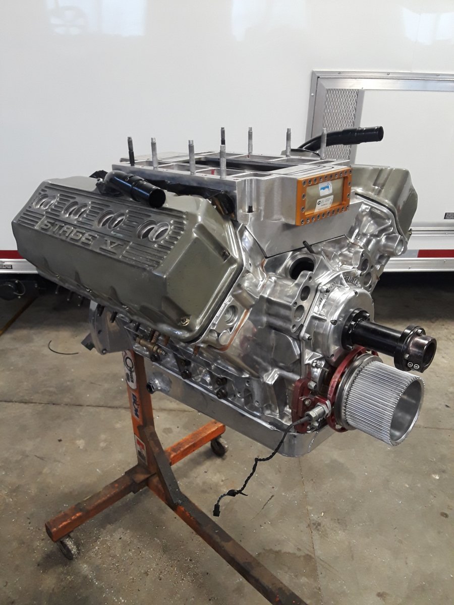

  26. The ch***is has been cleaned and sealed. The front end is polished. The engine is ready to go. It time to put some pieces together. 20190101_140222.jpg 20190101_162915.jpg

  28. I have been in a polishing mode for over a month. I have done all the wheels; engine block; rear suspension; fuel tank and a number of smaller parts. Once the car comes apart everything gets cleaned and checked out. It will look nice when it's all back together.
