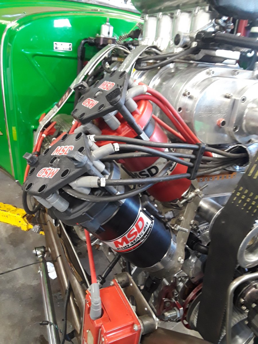

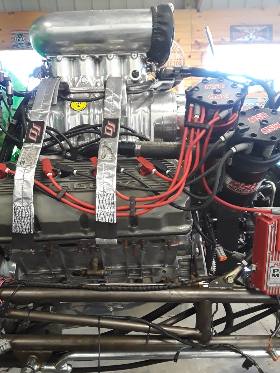

    What’s a EFI mag? I’m not understanding the tech here. Is it now a mag in name only, functioning as a distributor?
  10. Dave it was a real deal functioning 20 amp mag. All the guts were removed leaving a one of a kind shaft and bearings behind to spin the rotor. The fast efi box takes care of the timing. The spark could be sent to the plugs with a regular locked out distributor. The only problem with that is there is no base that's made to work with the dual drive. That's why I gutted a msd mag. It's a bolt on now. I cant say I have ever seen one before. Not one of the mag companies I spoke to have ever converted one. Just add it to the one off list on this car. So to answer the question it was a mag that's been converted to work with a efi system. It looks like a mag; attaches like a mag but wont produce it's own spark. You cant judge a book by its cover. Bring on the head scratchers this summer.
  11. David Gersic
    Joined: Feb 15, 2015
    Posts: 2,813
    David Gersic
    from DeKalb, IL
    Ok, yeah. So without the magnets, it’s now just a distributor with no advance, in a mag case that fits where you need it to fit.
  12. Correct. This set up should save alot of valuable time and fuel on drag week. I wont have to re engage the dual drive then re time the engine each time we switch to nitro. The set up driven off the cam was something I carried over from the 354 hemi. Stock they run the distributor in the back of the engine. There is no room for two distributors even if they made the parts to do it. The 426 style engine has a lot more options available. Im essentially doing what I was doing before just using different parts to make life easier. We hope to fire it up sometime this month.
