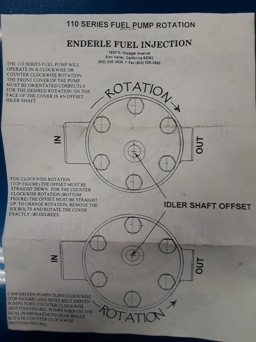

  2. The nitro start up went great. It ran on the bottle but not on the pump. I dove into my archives to locate the pump directions. Since I took the pump off the dual drive i had a su****ion that the rotation needed to be changed. After changing to a clockwise direction it's all good. The second video called first start up shows too much flames. It's running lean do to the big increase in timing.

  22. When I posted earlier that the pump rotation was backwards I confirmed it with the directions supplied with the pump. I needed clockwise rotation. As seen in the photo I had counter clockwise rotation. I will show the directions for not only the pump I'm using that being the twin gear but also the more common enderle pumps. These directions can come in handy depending on how you want to drive the pump.
    The pump can be mounted on the cam cover driven by the cam. It can be reversed to be driven by a belt. It can be run off a adapter that's connected to the mag using a cable for remote mounting. It can be run off a dual drive in either location. Every setup requires the correct rotation. I hope this helps someone out some day. 20190310_150629.jpg 20190311_185805.jpg 20190311_185836.jpg 20190311_185824.jpg
