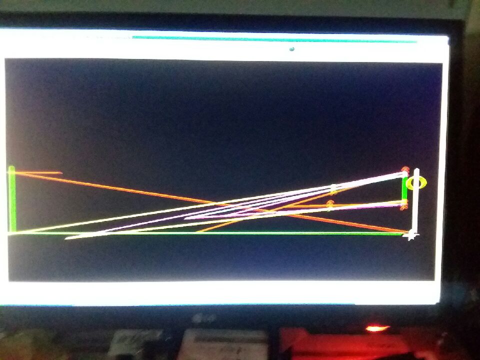

  21. 20190427_185923.jpg 20190427_185811.jpg 20190427_160801.jpg Resized_20190427_182256.jpeg Thanks had a great day with my hemi and squaring its ch***is. While we were at it the car got scaled. All the four link holes were put into a cad program. What I thought I had was not what I really had. My instant center was very short. That explains the tire getting driven into the rim. We will test it out next week with a longer instant center. It should hit the tires not as hard and apply the pressure longer. It won't be so violent. The shocks couldn't control the launch.

    Interesting, I like the computer program that you used. What one is it? I hope to be doing this to mine in by the weekend.
    Tony
  23. tony to scale your truck it has to be set up as its raced. you need measurements from the ground to the holes in the brackets. the full weight of the truck at ride height is needed. the program we used was a cad system. I have a program called ch***is wizard. its almost the same thing. I can borrow it to you when you need it. to measure everything and input the data takes a full day.

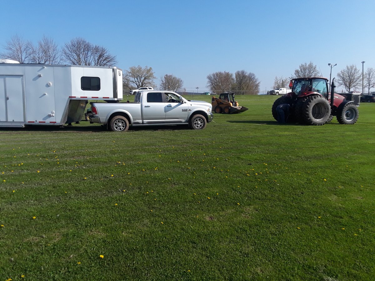

  25. The good the bad and the ugly over the weekend. The vintage torque fest was fun. It's a great show that does alot of good for families with kids that have congenital heart defects. We went on the cruise that brought us to Galena Illinois. The car ran great. We did our interviews and filming for a upcoming TV show Saturday morning. We had to get the truck and trailer out of the show area before the gates opened. We pulled into the parking area across the street. The rig sank in the soft gr***. It took a big case tractor to pull us out.

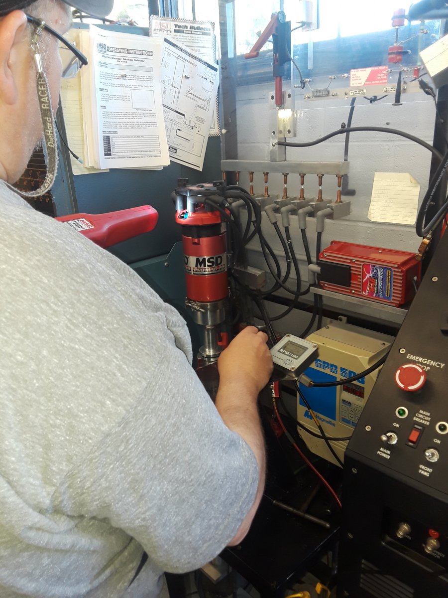

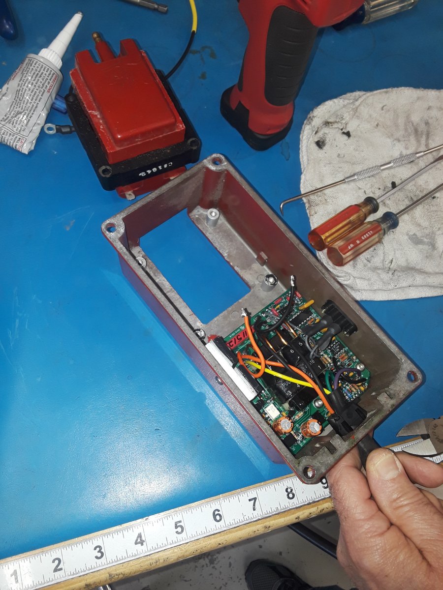

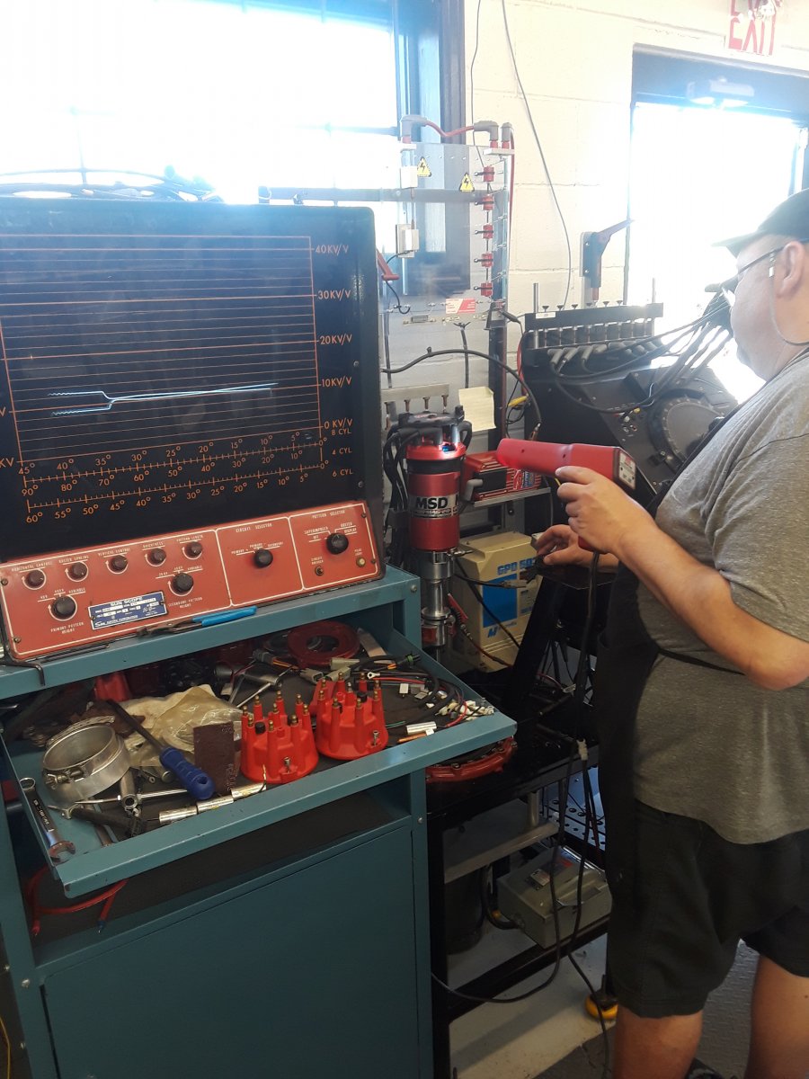

    We made it to cedar falls dragstrip to do some testing and get on track footage. The car sounded horrible on nitro. Roger was on hand along with a few guys from the orange crate fuel team. We determined the mag was bad. We called everyone we know in the area. No mag to be had. We loaded up and came home. During the drive back I called roo. He's located near indy. I asked if he knew the guys at mag tech? He said he did. His wife does to and had their cell number. she was with roo at the time. She sent the owner a text about the problems. I didn't want to drive 4hrs one way on a maybe they could look at it. The owner said to bring it down and it would be fixed asap. So I'm at their shop now getting fixed up. The coil in the points box went bad. On the machine it was miss firing. The mag checked out ok. The box is getting a upgraded coil and wiring. It's also being weather proofed. I feel like the reality TV show we are shooting has some real life drama to it. We have to make some hits this weekend. 20190504_090611.jpg 20190506_091724.jpg 20190506_092324.jpg 20190506_092218.jpg

    That's a neat test setup...the scope is 40 years old or so?

    Well the good thing is that it was a CASE tractor and not one of those Green Machines! Hopefully everything will be sorted out before the event at George’s! Looking forward to it!
  28. I agree. My grandfather; father; father in law and sister worked at j.i.case co.
