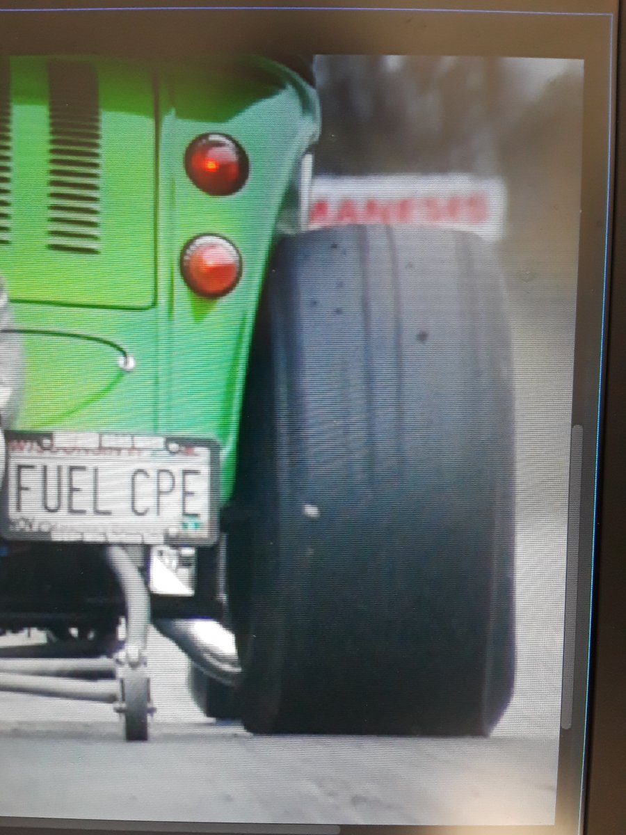

  1. We took the car to the grove today. The weather forecast changed big time. Temps only in the 50s and cloudy. The mag issues are resolved. The car sounded good. On the first hit the tires grabbed the wheels came up the body rolled the wheelie bars slammed the ground and unloaded the ch***is. Here's a few pics from the video.
    For the second p*** I tightened the shocks and raised the wheelie bars. I also put two rounds into the anti sway bar. The hit was so violent on the first p*** the wheelie bars were bowing so a few measures were needed.
    P*** two was more of the same just not as violent. I will be showing the local ch***is guru the videos for input. He made a interesting comment to me. He said as you get closer to the correct settings you will find that the front shocks will start to play a bigger roll than the rears. He also said to tighten up the front shocks to stop the body roll. I checked the fronts and they were set very soft. He made mention that the shock valving I have may not be enough.
    The engine is good. The leak down was 15 percent on all eight. That's with ****s rings with .050 gap. I have two weeks to get this all sorted out. The clock is ticking. 20190511_132931.jpg 20190511_132905.jpg 20190511_132903.jpg

    What are the strips in the center of the tires?
    loudbang and enloe like this.
  6. There must have been something on the track during the burnout. They were gone when I got back to the pits.
  7. I just looked at the pics again. Both tires have that. The pictures show the first time the tires made a run. It must be something from the mold. Now I have two burnouts on them the lines are gone.

  15. milwscruffy
    Joined: Aug 29, 2006
    Posts: 4,180
    milwscruffy
    You beat me to it, it looks like the right rear tire hits the body just before the wheelie bar plants itself.
    mgtstumpy, loudbang and enloe like this.

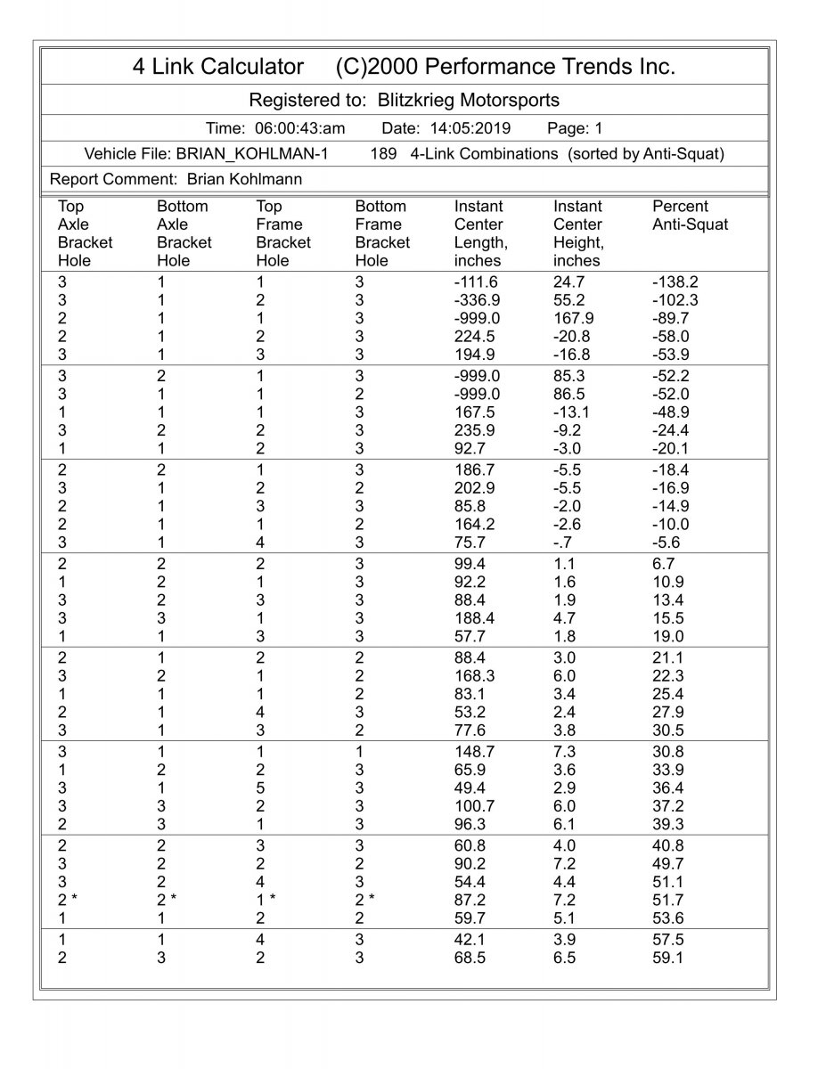

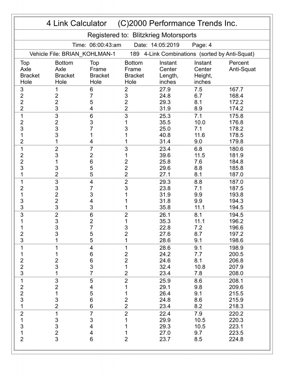

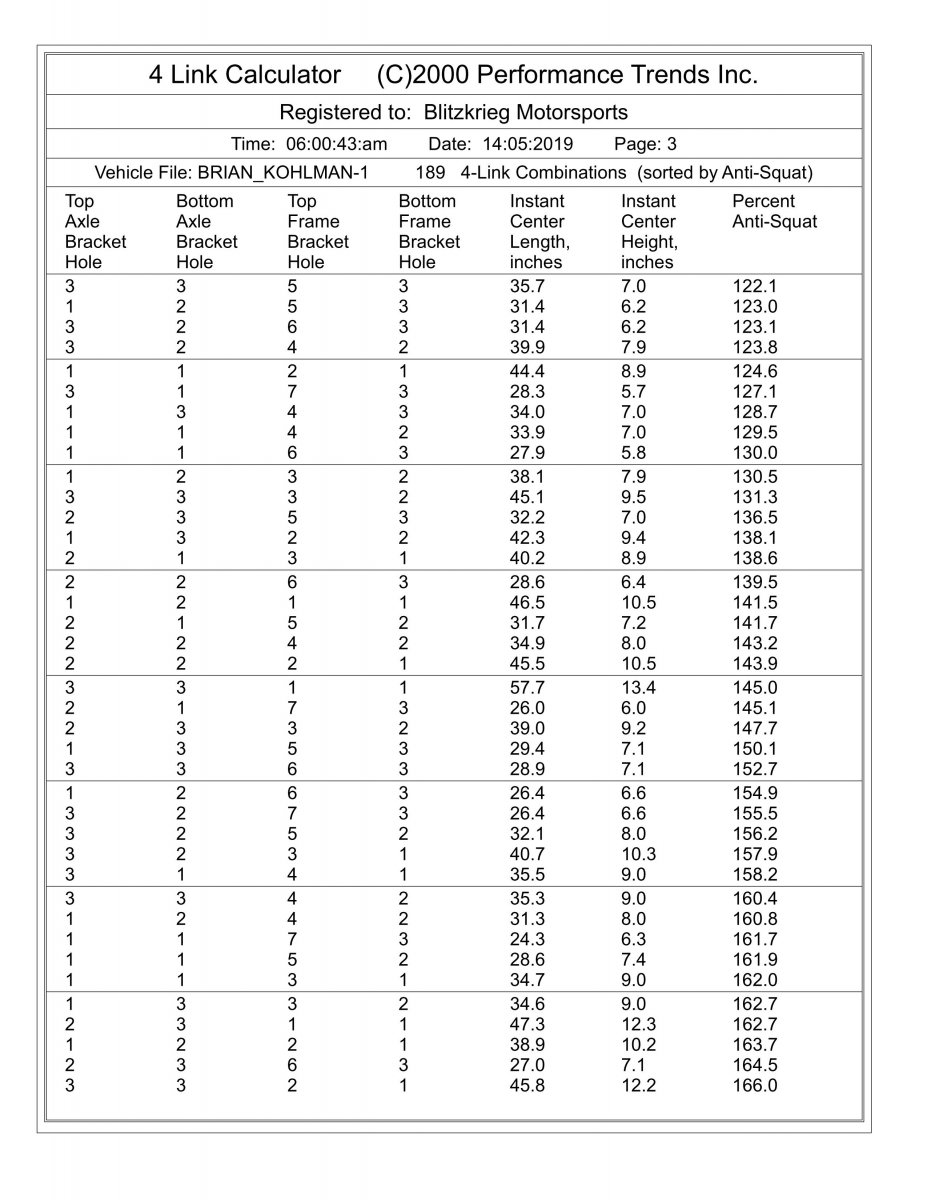

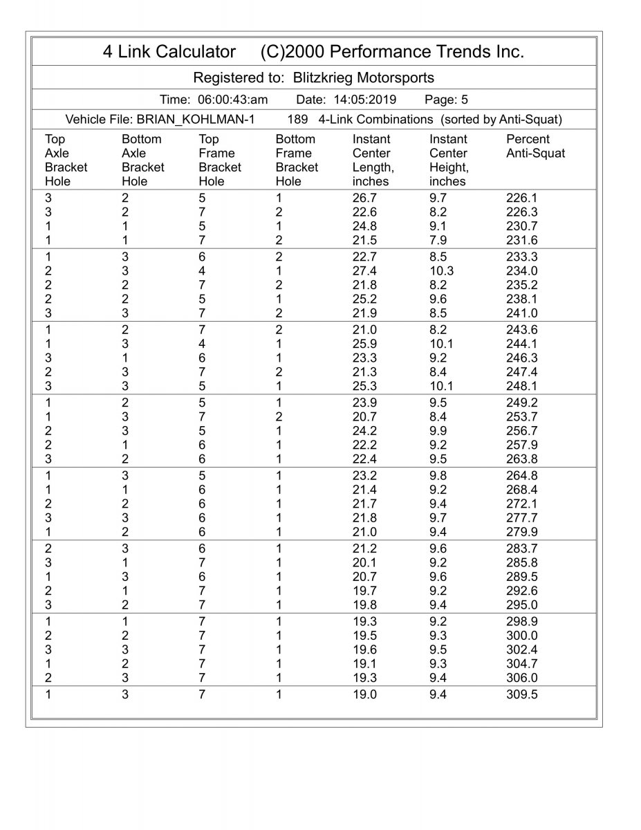

  17. Now that the car is scaled a print out can be made to take to the track. The print out identifies the bracket hole locations. It gives the combinations to arrive at different instant centers. Most of the combinations wont work. We are concerned with instant centers from 50 inches out to 80 inches out. This is measured from the axle center line forward. The chart wont tell you what's best for your car. What it will do is provide combinations to pick from. A hit is made on the car. The data is looked over. If more or less bite is needed the ability is there to accurately select a new instant center. Experience and trial and error take over from here.
    If the ride height or pinion angle is changed it will effect the instant centers a little. The front brackets are welded to the ch***is. If the ch***is is raised or lowered so do the brackets. If the rear end is rotated for pinion angle the brackets welded to it move closer or further away from the axle center line. Going to the track with a couple of instant centers to try is how we do it. Shock settings; tire pressure; coil springs; wheelie bar settings etc can refine the instant center. Here is the way it looks for my car and my brackets. Its unique to my car yours will be different guaranteed.
  18. loudbang
    Posts: 40,346
    Here are those pages :)
    Brian Kohlmann 4 Link_01.jpg Brian Kohlmann 4 Link_02.jpg Brian Kohlmann 4 Link_03.jpg Brian Kohlmann 4 Link_04.jpg Brian Kohlmann 4 Link_05.jpg

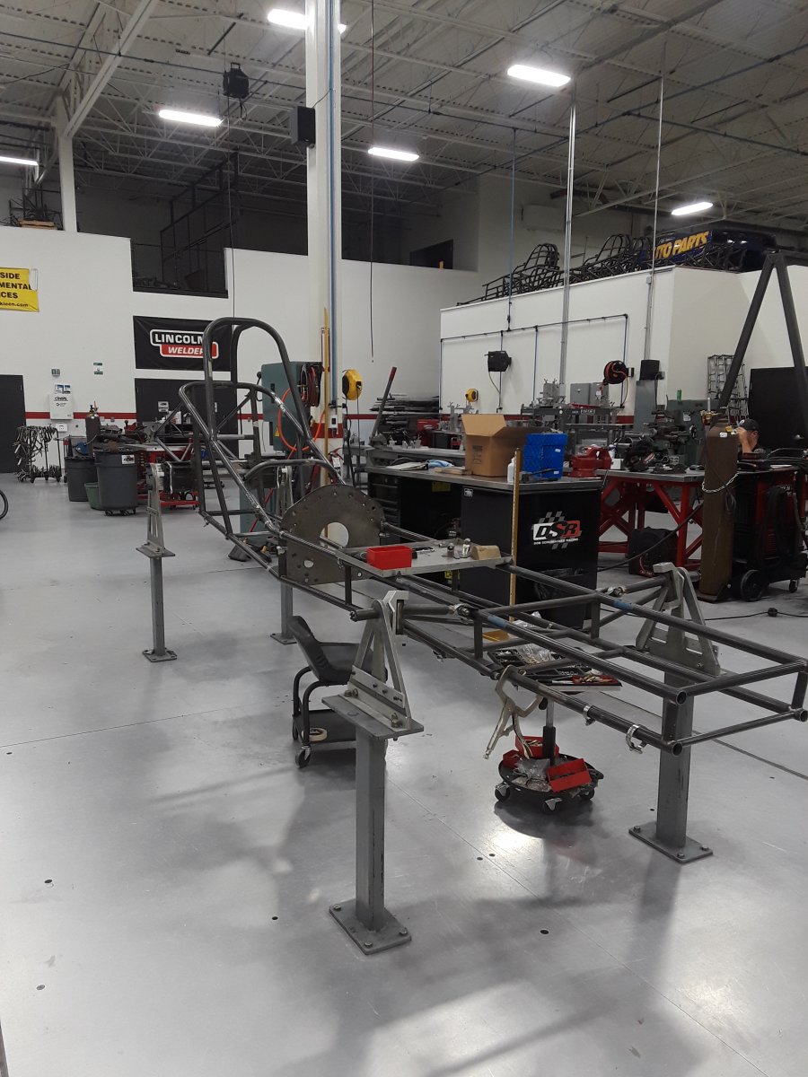

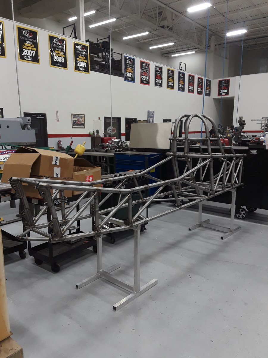

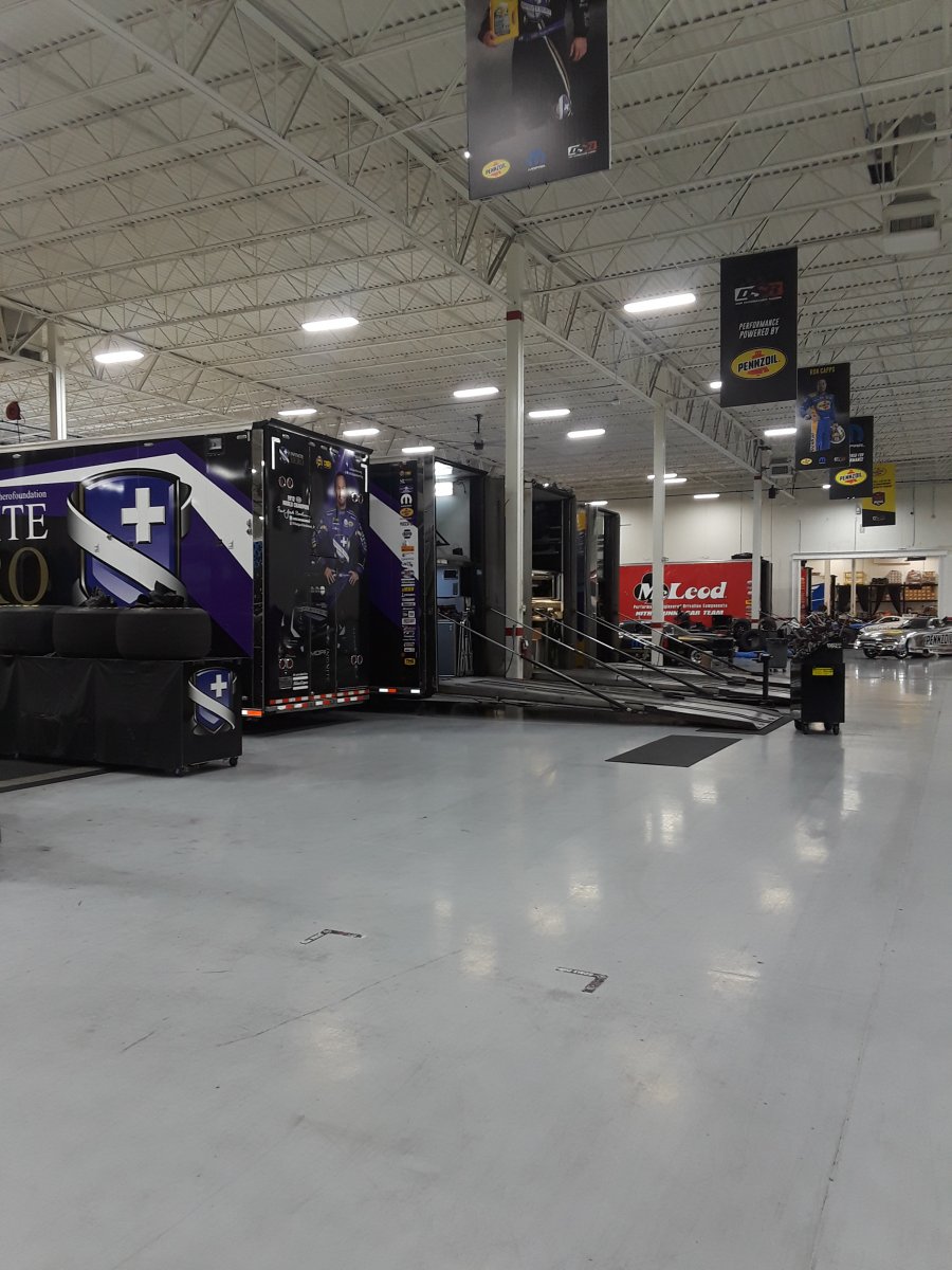

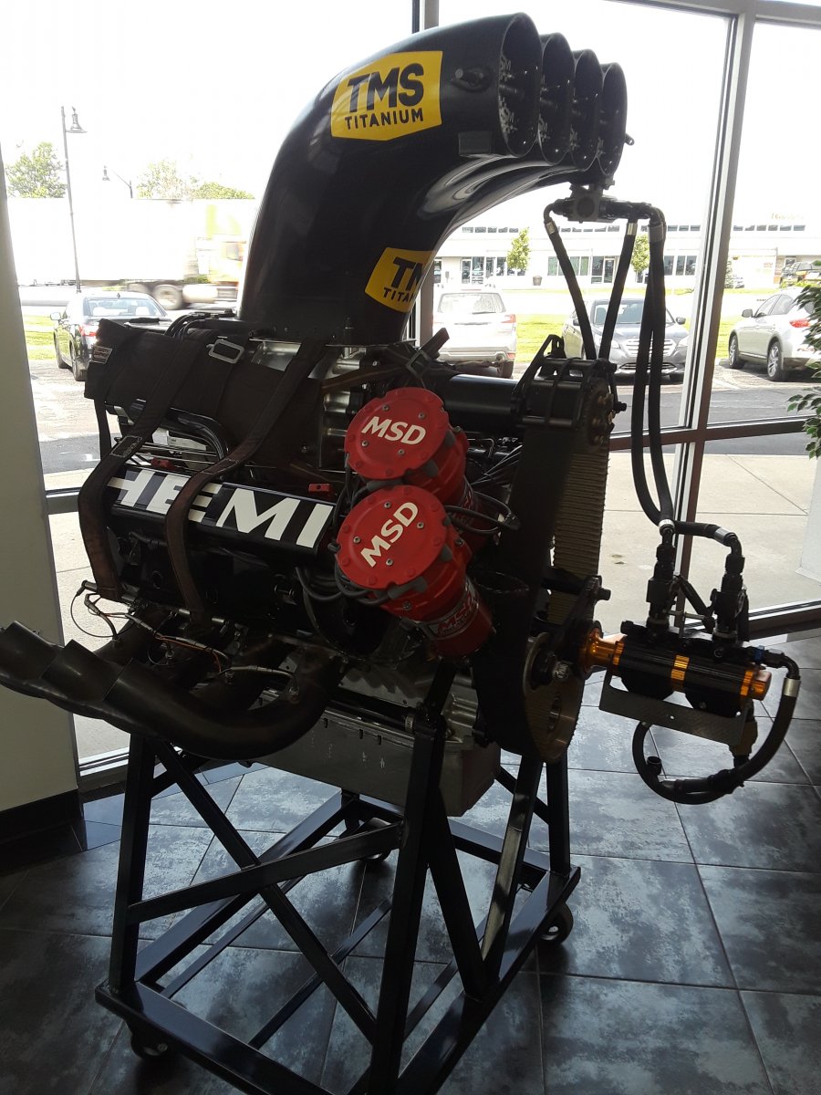

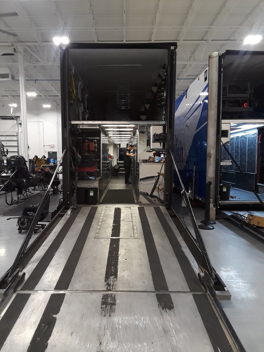

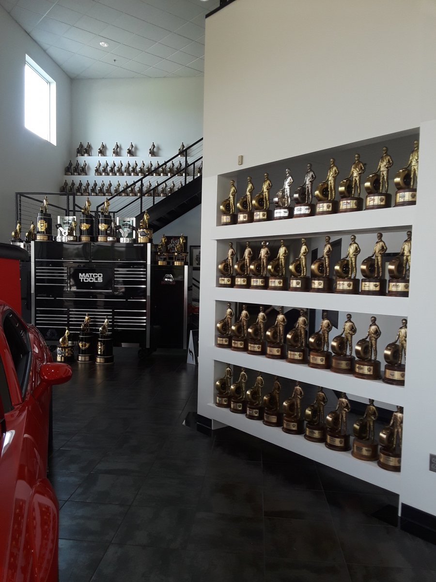

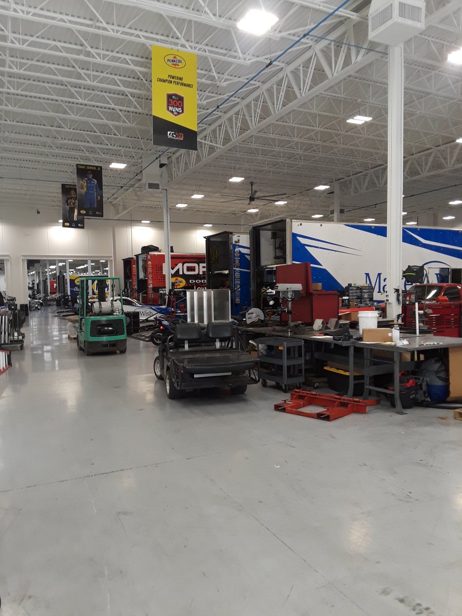

  20. 20190604_094625.jpg 20190604_094618.jpg 20190604_095659.jpg 20190604_095706.jpg 20190604_095828.jpg 20190604_095833.jpg 20190604_095839.jpg While on the way to wagler dragway in southern Indiana for the summit midwest drag and drive event I made a stop at Schumacher racing for a drum of nitro. All the teams were back getting ready for the Topeka race this weekend. I was given a tour of the facility. I took the pics after first checking with our guide if it was ok. Several areas were off limits. The activity level was very high. The teams had their cars along side the haulers as they worked on them. It looked like a indoor national event. The blower dyno was being run; clutches were being serviced along with all the cylinder heads from all the teams. In the machine room we got to see billet heads and blocks being made. We were able to see frames; headers being fabricated along with bodies being fitted to frames. The amount of money and personnel was amazing.
    We are all teched in ready for day one Wednesday. We need to make two p***es if the weather holds.
  21. I found one fact very interesting on the tour. When the semi haulers leave the shop they weigh 80,000 lbs. That's the car and enough engines and parts to go to the finals. Granted I'm not going for 10,000 plus horsepower I'm hauling a whopping 700lbs on a open trailer.
