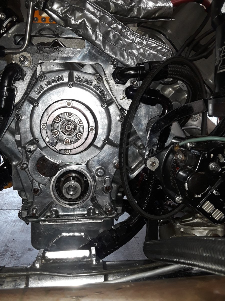

  22. We were there. We had a rough time. The car was falling on its face just after the hit. We made five p***es in five hours trying to sort it out. I turned in my time slips some how they were not recorded. The good thing was the car was hitting the tires hard and going perfectly straight. All the hard work on the ch***is was paying off. On the first gas stop just out of town the front seal was leaking. A local guy getting gas offered his shop for us to use that was only a block away.. It had a lift in it so that would help alot. We got the old seal out in no time. The difficult part was finding a new one. The closest one was in indy. That's a long drive. We finally located one at a local engine builders shop. It was all back together by 8:30 PM just in time for the severe weather to hit. Seeing that we were hot; hungry; and tired we grabbed some food at the only restaurant in town to wait out the heavy rain. By 10:30 we were on our our way for the 4 hr ride to muncie. More to come later.

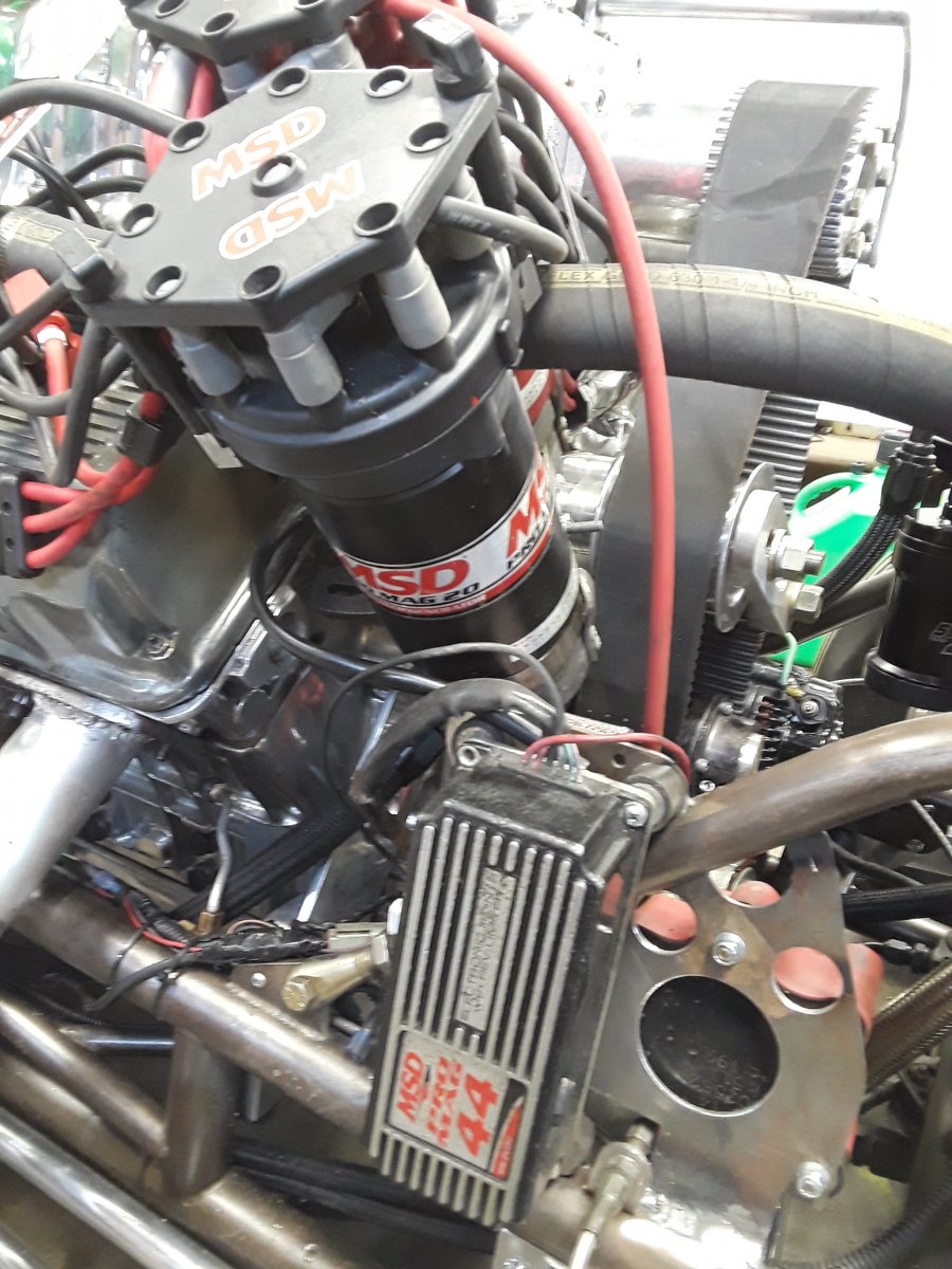

  23. When you have 100 hp you have 100 hp problems. When you have 1500 plus hp you have 1500 plus hp problems. The latest in this nitro saga has the car throwing blower belts. The idlers pulley bracket is flexing under extreme load. The pulley is no longer in alignment allowing the belt to run off the pulley.
    That was fixed with a support similar to what modern fuel cars use. Problem solved.
    The other issue that has cropped up relates to the ignition. Under full load the car loses power. We now think the 20 amp msd is not getting the job done. It was recently serviced with a clean bill of health. A friend just down the road offered up his 44 amp ignition to try out. The 44s is so hot its advised to pull a degree or two of timing. A 44 will fire anything thrown at it. The big nitro load and boost pressure might be too much for the 20 amp mag. We will see what happens. The 44 takes a seperate coil so I'm making a mount to hold it in place. The fuel pump was sent back to enderle for freshening up. They said the pump is fine and not the problem. 20190623_181949.jpg 20190623_182016.jpg

  26. If it is the ignition system that's been causing the issues watch out. The car has all the potential now to go in the sixes at 200 mph. Alot of little bugs have been fixed with all of the testing going on. Six out of the last eight weeks the car has been some where testing. We are going to try and get it out before the glory days event. If not we are registered for that event and it will happen then. I have been street driving it while I get this sorted out. I want to drive it to work this week. I haven't done that in a while. As much as I like to race it I enjoy it just as much cruising around on the open road.
