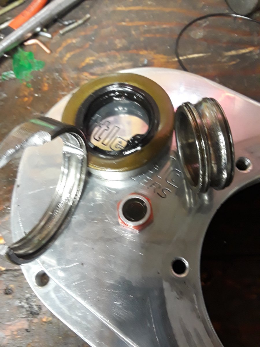

    Looks like a lot of load hurt that bearing to me.

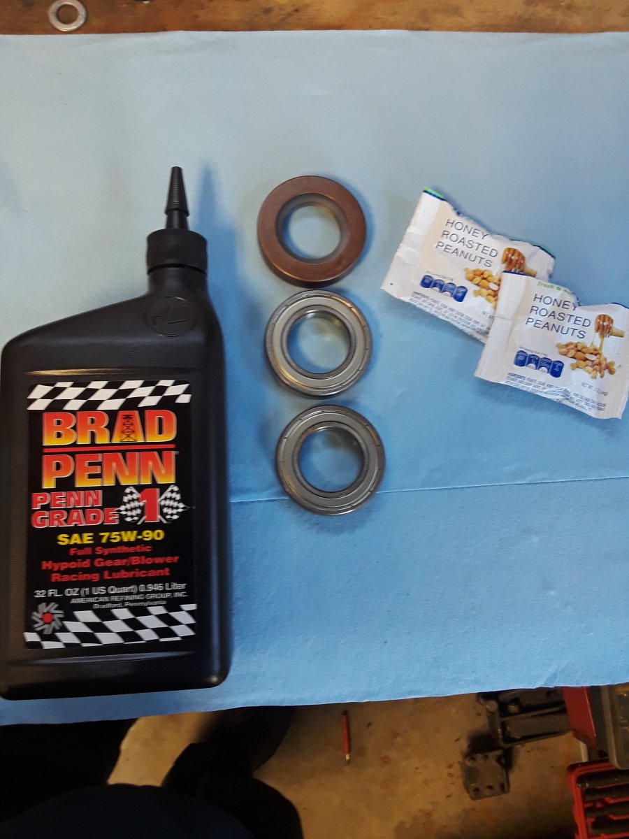

  3. It's a fine line for sure. I'm just glad I found it before drag week. I guess I can add extra bearings and a seal to the spare parts box that goes on the trailer.

    Do these bearings have anyway into the rotors and engine or are they blocked by the rotors themselves where they meet. Do they only make their way into the front gears or back cover if they fail?
    enloe, loudbang and Stogy like this.
  5. It's two bearings stacked on top of each other at the front of the snout. The chips can find their way into the front cover and gears. Luckily we put the car away after the second p***. Half of the front bearings balls fell out of the cage. That's what caused the dent in the seal. Everything was cleaned up. It's ready for re***embly.

    The blower was designed in the 1930s, and first adapted to automotive use in the 50s....the technology is tried and true. But Brian works his stuff a little bit more than the average street/strip blower car. Turns out it needs a bit more frequent maintenance, too.

  16. 20190801_095900.jpg I just got back from getting parts. As Jim stated the bearings are straight. I got the higher quality units that have shielding on them to keep trash out. The car should be running by noon.

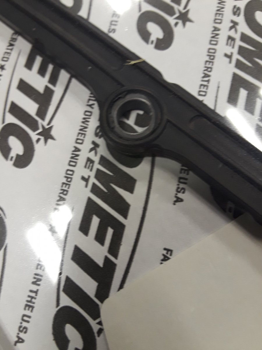

  30. 20190815_204847.jpg 20190815_203218.jpg I'm full speed ahead getting ready for drag week 2019. Major maintenance is being performed on all areas of the car. Supplies are being ordered to make sure we have what we need. My friends at cometic gasket sent a care package today taking care of our immediate gasket needs. They have been strong supporters of the car. Thank you very much. When I say they make the best gaskets out there I mean it. I have tried them all. They fit right and last a long time. The valve cover gaskets are a big safety item. They have steel washers around the bolt holes and have steel inside the rubber portion for maximum strength. In the event of a torched piston the blow by created can produce crank case pressures high enough to push out oil pan and valve cover gaskets. This could cause a really big fire do to the oil hitting the hot zoomies. We want to avoid that at all costs. The steel washers are like a solid bushing preventing the gasket from being over tightened. This is why we use the best gaskets available.
