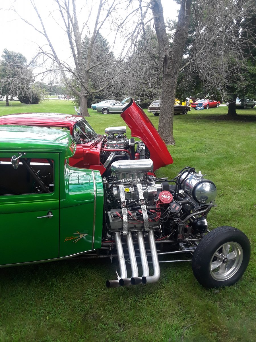

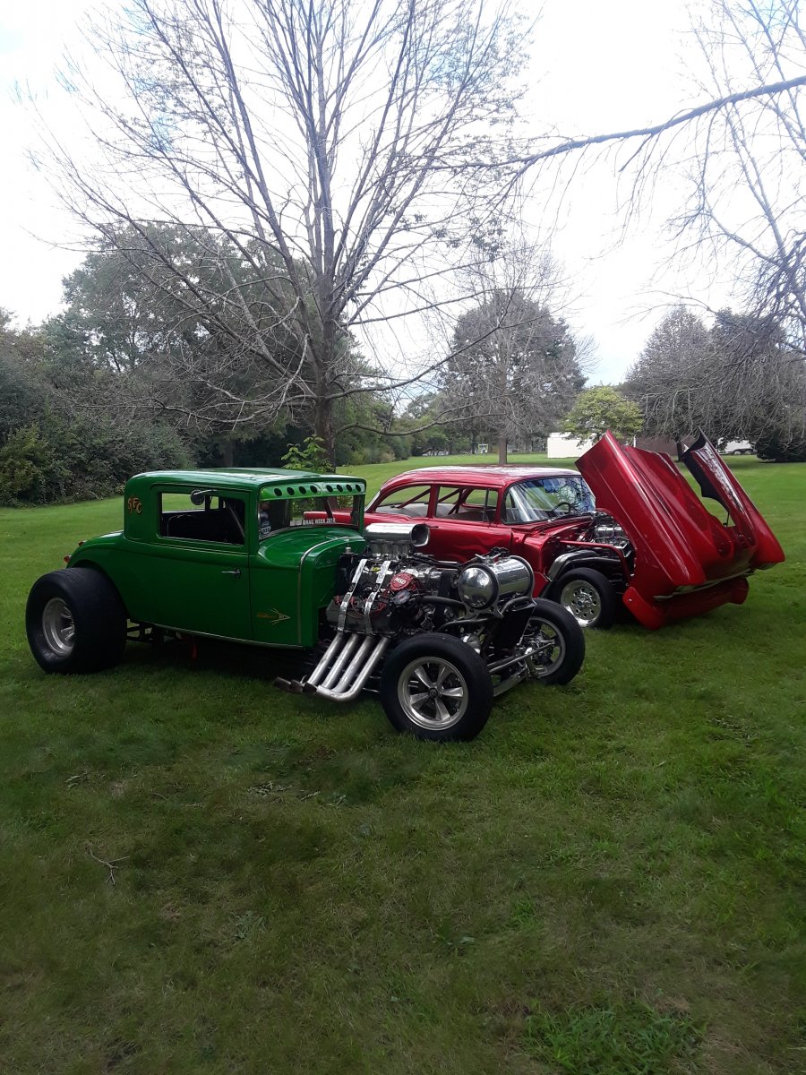

  15. It's not clean but it runs. I took it to a car show in town for a test drive. My neighbor from the other side of the corn field brought his 55. 20190902_121202.jpg 20190902_121310.jpg
