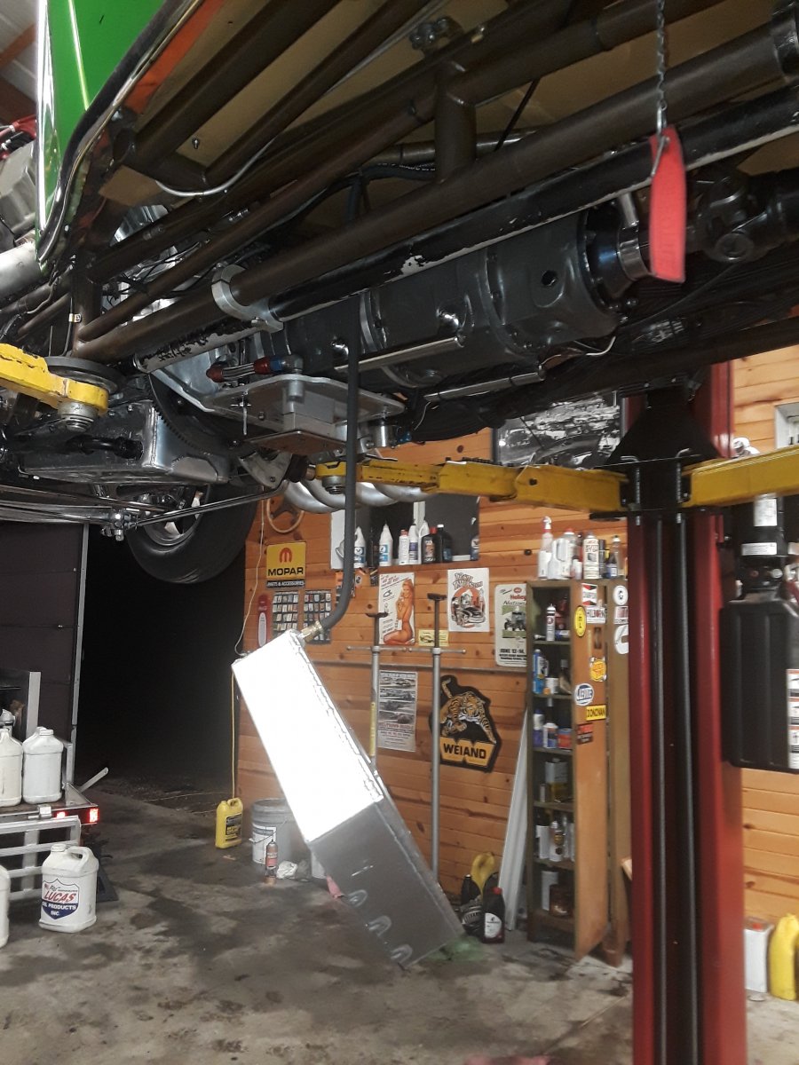

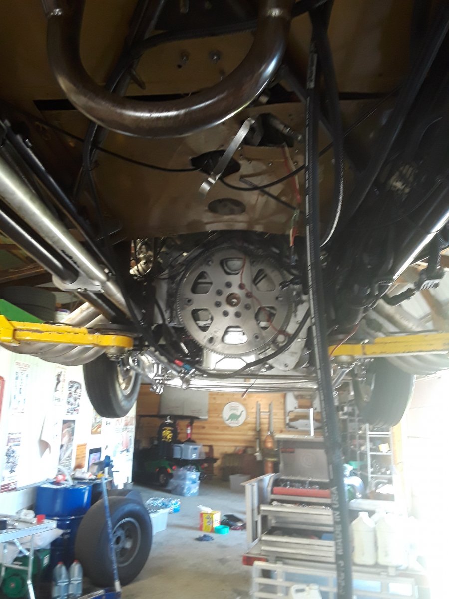

  9. The morning didn't start out good. I started the car and the front seal blew. The pump bushing wore out. How do I know? I spent the next 8 hrs pulling it all apart to then spend about the same amount of time putting it all back together. The car was started on the lift in gear to run fluid through the converter. The tires didn't turn at all. The pressure gauge shows 0 lbs. It will all come apart again. Something is wrong under the front pump cover. Notice how the pics go from day to night. 20190905_205806.jpg 20190905_163435.jpg 20190905_163446.jpg 20190905_205806.jpg 20190905_163435.jpg 20190905_163446.jpg

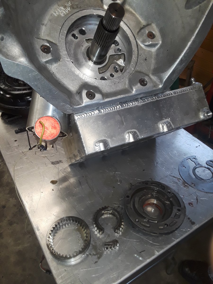

  16. Got up early took it apart and this is what I found. Broken pump gear. Now off to Illinois to brunos. 20190906_100258.jpg

  20. The bruno is fixed. When the gear broke it roughed up the case slightly. The main case was put in the lathe to have the pump surface machined flat. .005 was all it needed. The new pump gears were ground to match the old pump housing. They are made over size then ground for .003-.004 clearance. They are made out of powdered metal. If dropped they will break. They are very brittle. I don't know why they use that material. Bruno said he has seen gears break when installing the converter. The issue now is finding someone to fix the converter snout. It was damaged and needs to be replaced. 20190906_125020.jpg 20190906_162227.jpg
