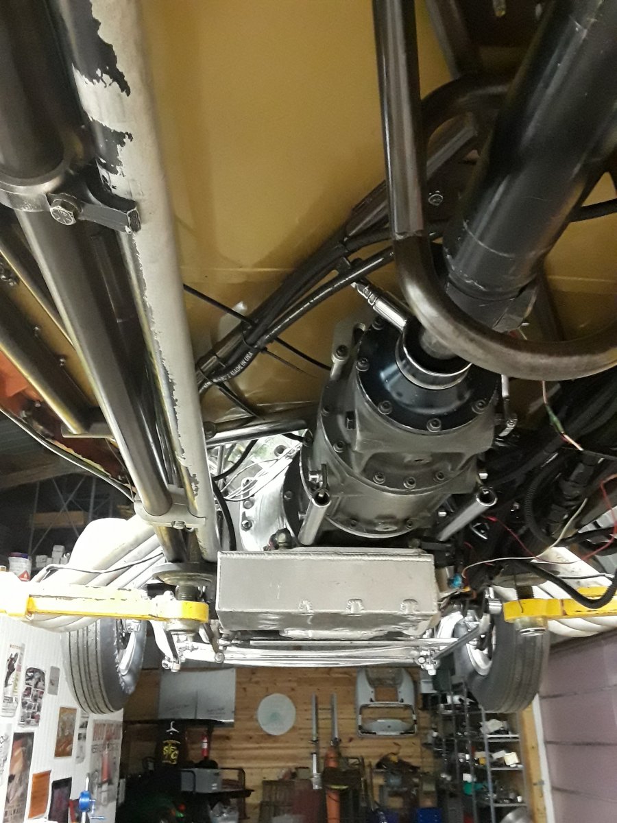

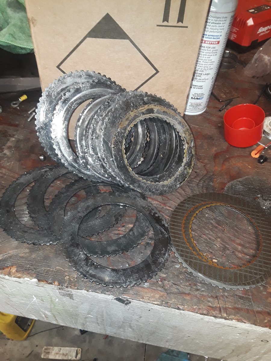

  17. Went to rock falls for the fall out drags. Had a great time. Car ran 177 mph. I thought the lenco was kicking out of gear. Turns out the co2 bottle emptied. It has a leak somewhere. The result was a fried low gear clutch pack. Who knows how fast it could have gone without the slippage. New clutches on the right. 20190922_190316.jpg 20190922_190322.jpg

  19. The steel plates that go between each clutch disc got so hot they warped. The 30wt oil came out looking like black goo. All the clutch material is gone.
    Good news is the tune up is very close. The car picked up 45 mph past the eighth with a slipping trans. Those speeds make me think it could go 200 mph.

  27. thanks for the offers to help. I worked on it until I went to bed. I have the cases and most of the larger parts flushed out. there was a lot of metal to flush out. all the bearings need to be inspected. i found some that were junk. this is were the problem is. I can easily get the parts over night. I just don't know everything I need yet. so far the front case seems to have avoided any damage. I also need to take a close look at the sprags. they take a real beating in these situations. if the sprag should fail under power the rods come out of the engine. extra care for a complete inspection is critical. this takes time to do.
  28. Runnin shine
    Joined: Apr 12, 2013
    Posts: 3,383
    Runnin shine
    Is this connected to the pump failure? Or should I say alignment dowel fatigue?

    sounds like a completely different issue, although it's possible one of the air shift fittings developed a leak reinstalling the transmission?
    loudbang and Hemi Joel like this.
  30. Completely different issues. The bruno fluid is seperate from the lenco fluid. They do share the same co2 bottle. I think either the clutches were showing wear then placed under severe load ate themselves up. Or the co2 bottle got low and couldn't apply enough pressure on the fork engaging the clutch pack. Or both. As the clutches wear using varying sizes of shims or adding a extra steel or clutch disc in the pack can take up the gap. There is a spec measured from the snap ring groove to the clutch pack.
    As co2 enters the air pod it pushes on a fork. This fork applies pressure to the pressure plate. The plate engages the clutch pack putting the trans into the next gear. You can go too far setting the pack too tight. If the pack doesn't have the right clearance the fork has no were to go. It's like a wedge trying to split that section of the trans. All kinds of damage can occur from that.
