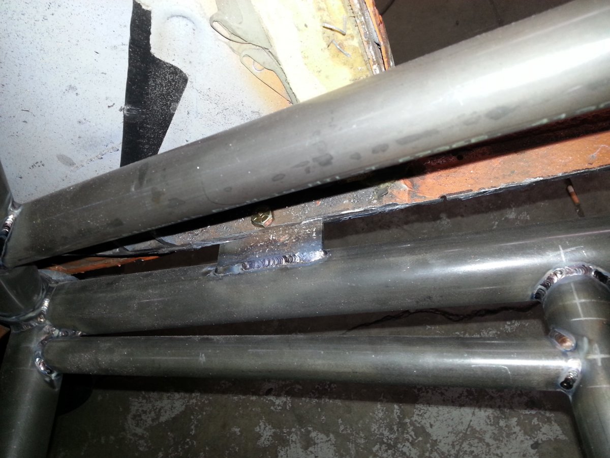

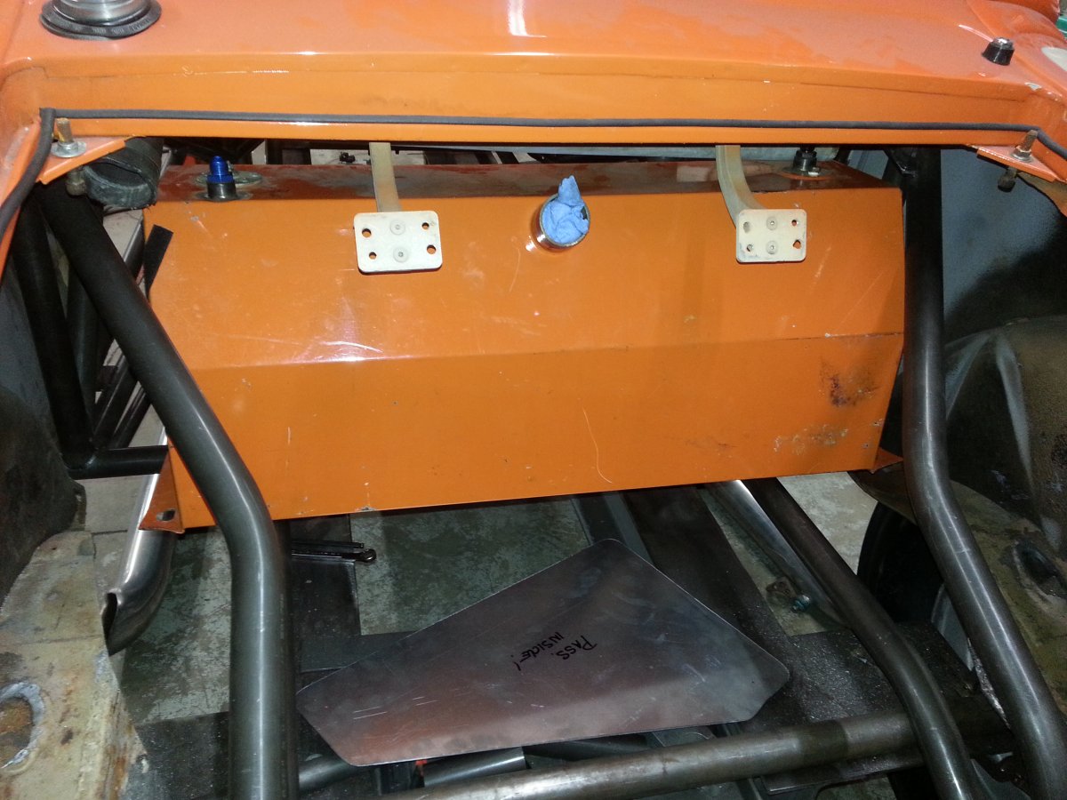

  18. More good progress. Four more bars are welded in under the cowl. The front engine mounts are roughed in. The engine placement has been started. The engine needs to move back a little. Im running the water out of the back now so i need clearance for the fittings. There are ten body mounts now. The body will be bolted on. It will be able to be removed if there is ever a need. I didnt like the gas tank that was made so now im running my old one down there to fit it in. Koop from the melt down crew also sent a few windshield stickers. There are lots of things going on behind the scenes. More to follow soon. I'm looking forward to the pri show starting tomorrow and going through out the weekend. its a great show to see all of the latest greatest stuff out there. i will be doing some shopping while I'm there. most vendors offer show specials. they can really add up fast. they always end up more than paying for the trip. i highly recommend going at least once. 20151209_122848.jpg 20151209_122901.jpg 20151209_123004.jpg 20151209_123024.jpg

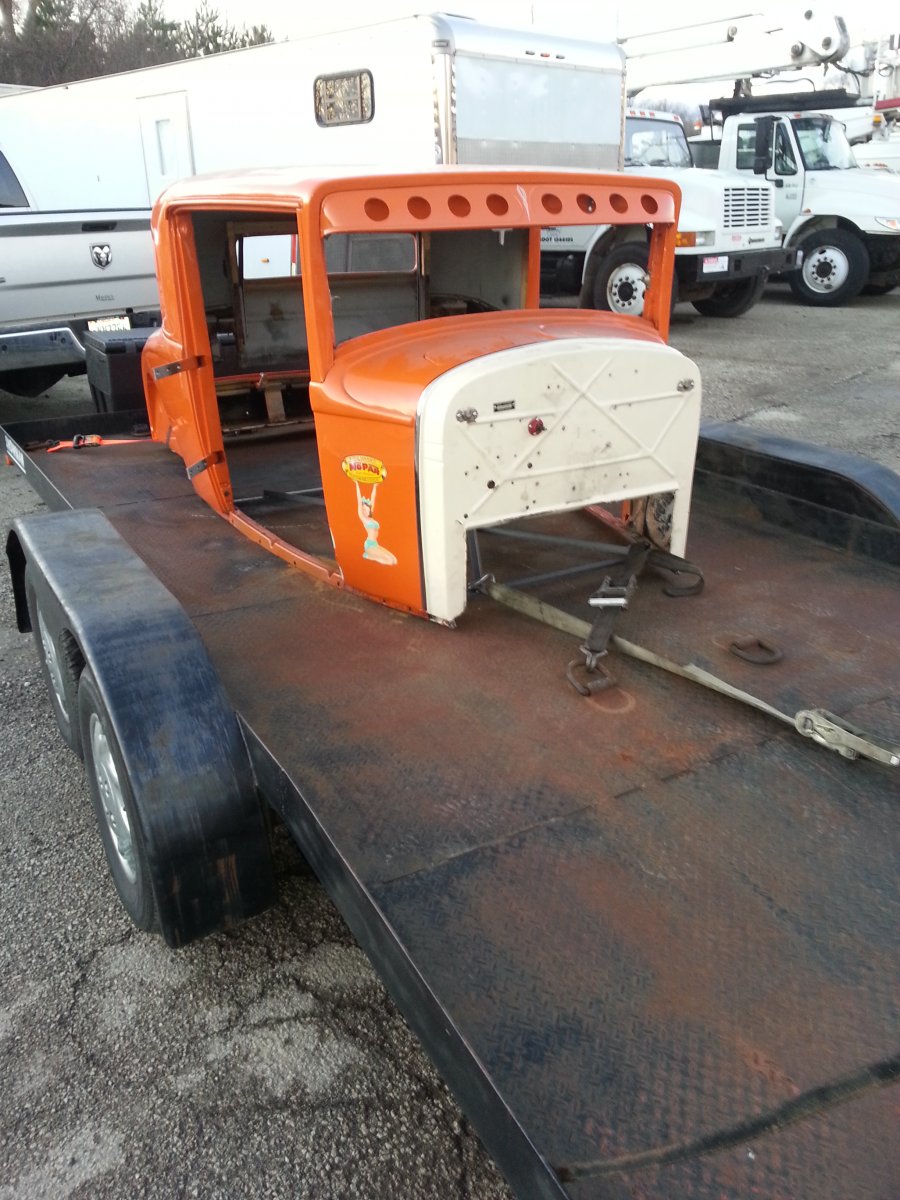

  23. I was able to pick up the body today. The weather in wisconsin has been very strange. Like most of the u.s. it has been warm. At this time of the year there should be snow. Today it was almost 60. Things just sometimes work out. good car hauling weather. when the crash first happened i was so pissed off i couldn't wait to get things torn apart so i could get the body out of the shop so i didn't have to look at it. now that i have calmed down some what I'm glad its back. the guy that hammered out this body years ago is on his way up from arizona to straighten out the mess i have. he is a old time guy who metal finishes. he is in his 70s and can run circles around guys half his age. more on jack in the near future. the body was braced using the new body mounts in anticipation of the beating it is about to receive from jack. we want to make sure the body will still fit the frame when we are done. 20151216_162010.jpg 20151216_161315.jpg 20151216_162018.jpg

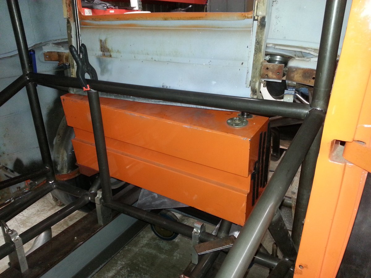

  25. 20151216_162050.jpg 20151216_162057.jpg 20151216_162112.jpg 20151216_162128.jpg 20151216_162255.jpg the second part of the visit was a big surprise. after i got the body secured to the trailer i was treated to this progress. i stood back and looked at it for a while. then it hit me. this is becoming a serious effort. its hard to get good pics with all of the bars now. i took a few pics so some of the details can be seen. the frame was flipped over for welding the bottom of the tubes. its finally off the jig. the bottom rail is now welded in. the second rail sure gives it the nostalgic look i wanted. the new narrower seats fit. i had ordered 18 inch seats. with the way the body taperes down toward the front the seats would only fit if they were as far back as possible. in that position i couldn't see out the drivers window. the new 16 inch seats allow them to be moved up to the proper position. the next step is to mount the drive train. jim is in tight with the guys at strange eng. he is taking the dana down there to use their jig to install the new tubes. that way we know its all correct. jim says things go fairly fast now. with the body being worked on along with the frame at the same time i better get going putting the engine together. it was a good day. lots of progress.
