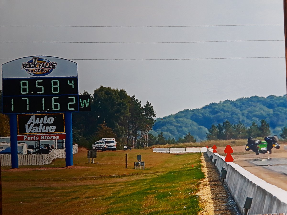

  3. 20191003_091931.jpg 20191003_092057.jpg 20191003_091817.jpg 20191003_092119.jpg I just received a few pics from the rock falls event. from were the Christmas tree is located I would say it carried the front wheels at least 100 feet . We have been getting alot of rain lately. We are going to try to run the car sunday at the grove. It looks like the only warm dry day for a while

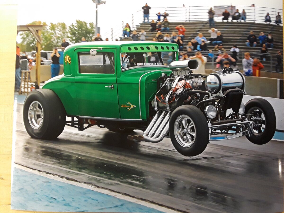

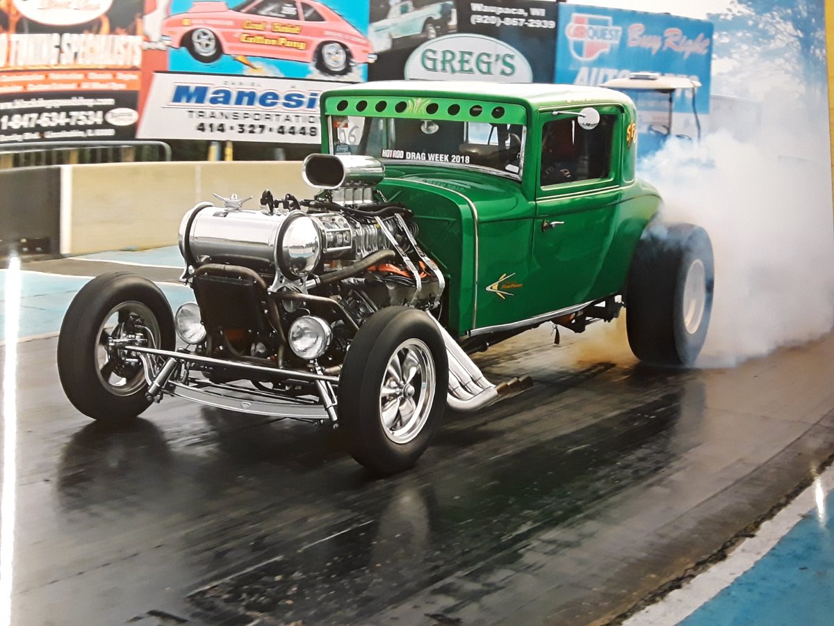

  4. 20191006_173501.jpg 20191006_173432.jpg 20191006_173403.jpg 20191006_173327.jpg 20191006_173140.jpg 20191006_174233.jpg With all the mag and bruno/lenco issues it was nice to lay down a killer p*** going into the off season. The air was dry. The temp was 65. The lenco must have gone back together correctly. The timing was 48 degrees. Nitro was 70 percent. They had a import race going on today. Thinking the track might not hold the car I wanted to play it safe. Shortly before the p*** the sun came out just in time. With a long delay do to the large car count there was no heat in the engine. I chose to grab the hand brake and lay down a long burnout past the starting line. The car hooked hard with a 1.14 60 foot. At the eighth it went 4.26. That's a six second p*** all day long. I don't believe the 5 sec quarter time slip. I can have some fun with the photo and et slip. After the p*** the engine was leaked down. Cylinders 2,4,6 might have the rings pinched. The leak down was 60 percent. As the tune up gets closer one side or the other can get picked on. A nozzle change increasing by 3 will fix that. The et slip is reading 5.52 at 1000 feet. That's a 6.8-6.9 quarter mile. Not too bad for a street car that pulls a trailer.

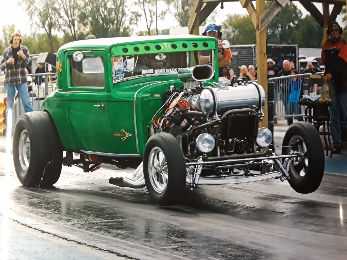

    Brian, my friend Dennis mentioned how close your tire is here in this pic
    I said not as close as u.s.41 last year.
    Then my adhd got in the way and I wondered what type of insurance do you have to insure your suicide doors don’t cause you to loose cabin pressure?
    And further I hope we haven’t discussed this before.
    chryslerfan55, loudbang and Stogy like this.
  15. It is close and does rub a little on the hit. Over the off season I will send the shocks back to qa 1 for revalving. I do run a stiffer spring on the right side and it helps. I also have a anti roll bar that I have been tightening up. These things have gotten us to were we are with the 60 foot. There is more work that needs to be done. It's all about how much time; money and effort do you want to put into it to get the most out.

    I think I found your timing system issue.
    The stage beam is still blocked as he's going past the 60ft cone, which means the clock hadn't started yet. The clock starting late explains the missing 60ft time and the other ET's being so low. The MPH's are the only parts of that time slip that are going to be accurate, since those are clocked independently.
  25. Not the case. The time slip has a reaction time and the tree has a green light showing the clock started. The times would not make any sense if they started that far down track. The car can't cover 330 feet that fast 1.14 even with a head start. The 60 foot shown on the slip is very close to previous runs. My fastest leading up to this p*** was 1.15. The next set of photo cells is at 330 feet. That et is close to matching my previous fastest p***. Looking at past et slips the times make sense. They are just shifted one spot the way it was printed. Several other cars that ran after me experienced the same thing. The car felt way faster than normal on this p***. The video shows a nice clean p*** without having to lift. Previous fast p***es had me sliding around having to lift or shutting off early. This one was full power to the finish line. My burned off electrodes and pinched rings say it was on a hell of a p***. Those things don't happen on slow p***es.

    The green light is not attached to the ET clock in any way. ET is measured from the stage light turning off to when the finish line beam is broken and reaction time is how long after the green light that the stage light turned off. The green light turning on is only showing that the tree activated and that "a fair start was accomplished," as the rulebook words it. Judging by the slip, I would say that the clock started when you were somewhere around 150-200ft down the track. I also took Squirrel's idea and timed the video- car left the line at 28.45 and got to the finish at or around 36.00 (it's a bit difficult to tell where exactly the finish line is).

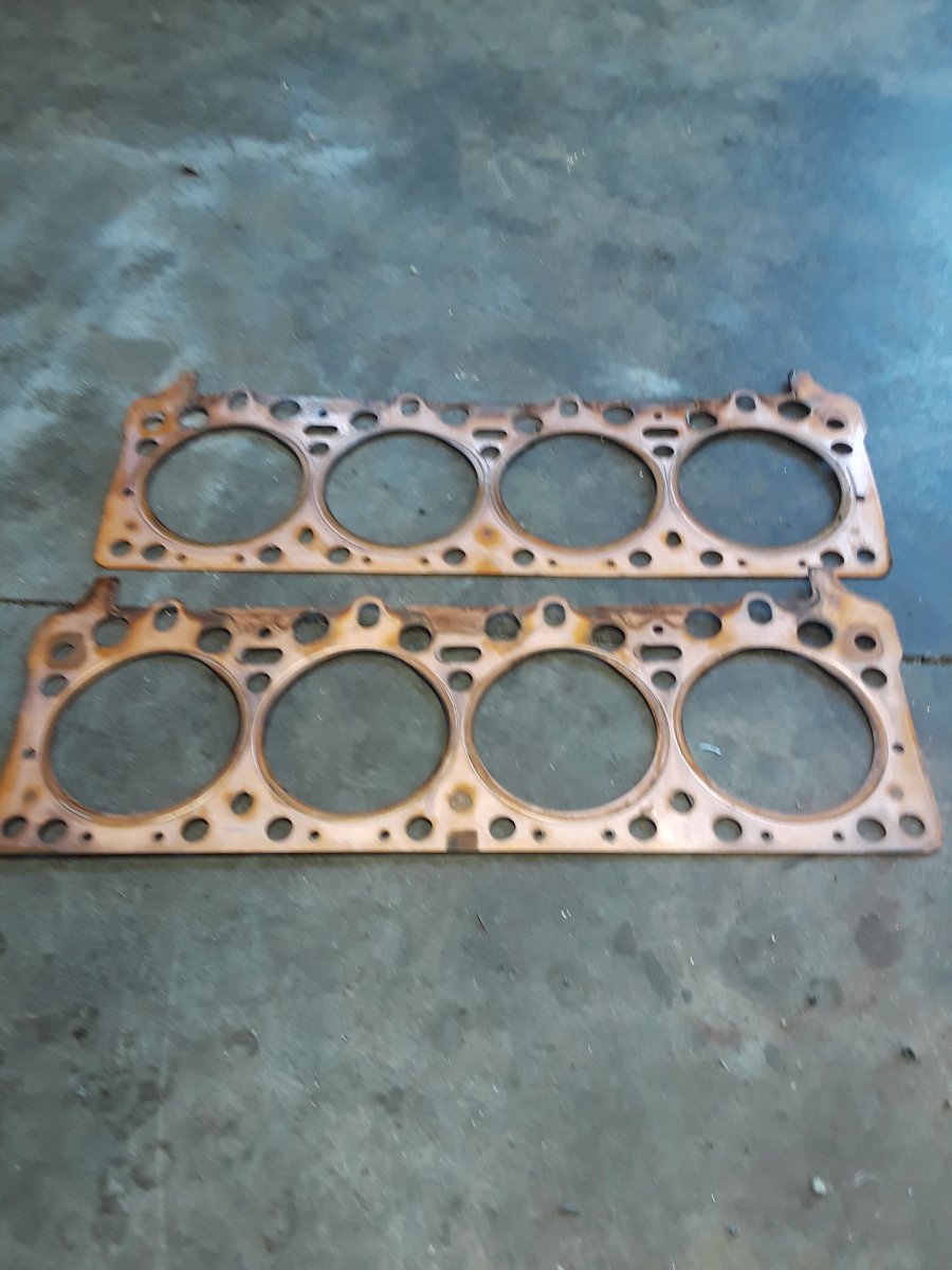

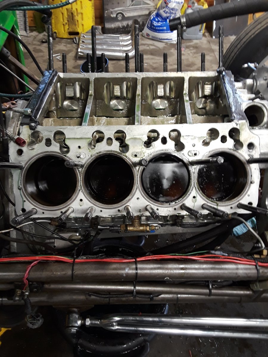

  27. So far so good. While nothing has been cleaned up yet there doesn't appear to any damage. The deck on the block and heads look good. The gaskets look like new. There are no signs of piston damage yet. Once the pistons are out I can access the rings and ring grooves. The other possibility to the high percentage of leak could be bits of metal and porcelain on some valves.
    With the forecast calling for snow friday night all the fluids on the car were drained today. The trailer was prepped for freezing temps also. I'm getting a jump on next year. 20191009_173311.jpg 20191009_173321.jpg 20191009_173332.jpg 20191009_173335.jpg

  28. Nick I see what you are saying. To add that much et to the 5.52 doesn't add up right. I think it ran a high six. The world will have to wait until next season to try to back it up.
