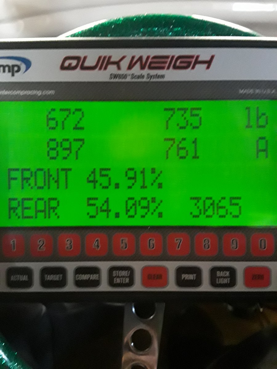

  4. 20190427_160801.jpg Most of the unlimited drag week cars are 3000 plus. Keep in mind that weight is with me in the car. I'm 195lbs.

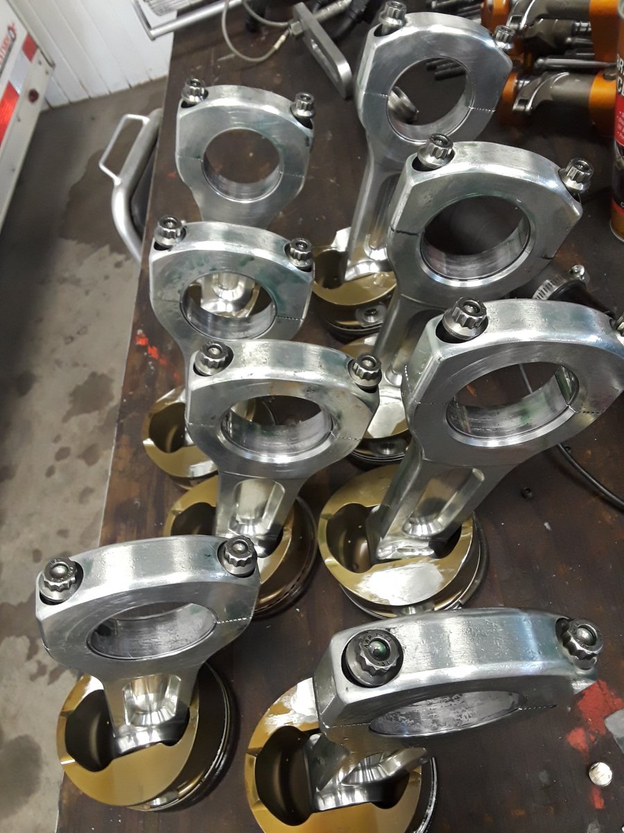

  15. The crank looks good along with the rod bearings. The second rings are pinched on cylinders 2,4,6. This was caused by the great cool dry air. I should have pulled four degrees of timing out. It detonated at the hit. The crank will get magnufluxed and polished. The rods will go back to grp for resizing. They do it for free. I have some spare pistons ready to go. I will order some more to have on hand. I have the larger nitro piston pins. Do to the detonation they will be checked for straightness. A light touch with the rabbit turd hone and a fresh set of rings and it's back together. The funny fuel causes funny things to go on inside the engine. 20191012_170145.jpg 20191012_170110.jpg

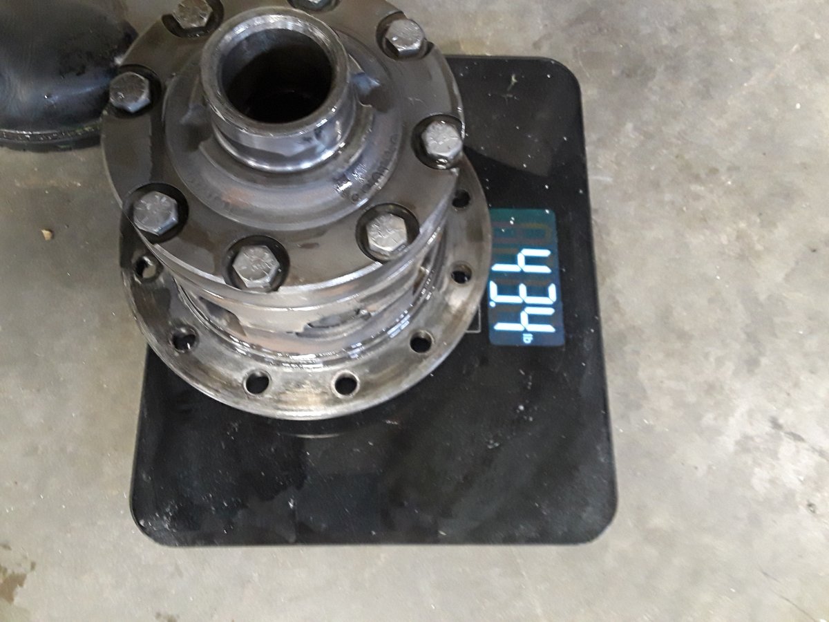

  25. Moving forward with putting the car on a diet. I spoke to squirrel and dave Schroeder about putting a spool in the car. All agreed it's the way to go. I think I have reached the point power wise it would be safer. I pulled the diff out and found all the case bolts loose. These were lock-tighted and torqued. Further proof the spool is required now. Out of curiosity I put it on the scale minus the gear. The spool weighs 12 lbs. So I loose 31 lbs of rotating weight. I will change axles to gun drilled 40 spline units for more strength and weight savings. Even though they have a larger outside diameter the drilled axles are still lighter. Since drag week i got my fat *** in the gym losing ten lbs. So me and the car are almost half way to our 100 lbs goal. 20191017_092546.jpg
