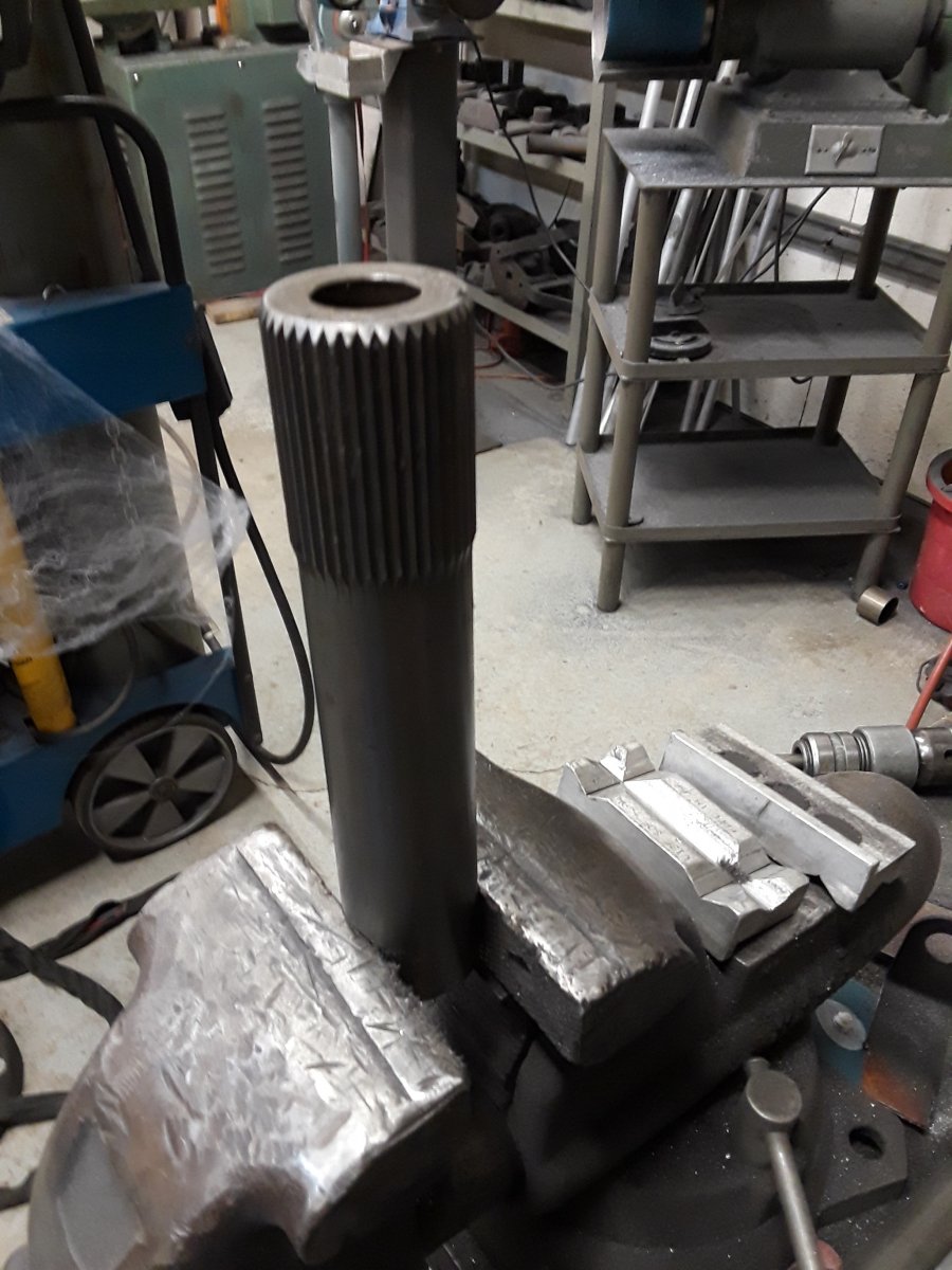

  7. I picked up the 40 spline spool friday after work. This thing is beefy. Jim at the ch***is shop has a piece of axle that has two flats machined into it. Putting that axle stub into a vice takes all the work out of torquing the ring gear in place. 20191018_161226.jpg

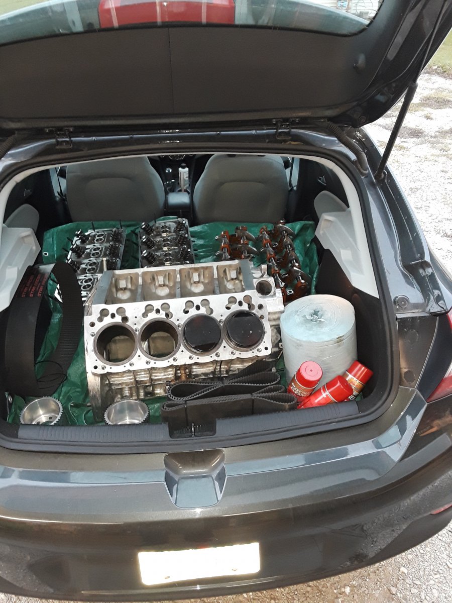

    I'm off to iowa with parts of the engine. Roger and I are going to in increase the center studs to 9/16ths. This will provide more clamping force on the gasket. The heads can be torqued higher. The studs under extreme pressure do stretch under this load of nitro. To ensure the head stays in place along with the gasket this is the next logical choice. The lower studs wont change because there are twice as many as the middle row. This is all normal stuff at this level. 20191019_173227.jpg

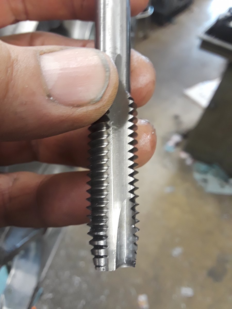

    Not to question the knowledge base of you and Roger but curious as to what kind of tap you plan on using, regular cutting tap, thread rolling tap or Heli-coil.
  16. Roger has some kind of special tap he uses. We will use the mill to drill it. I'm sure the mill will also be used to get the tap started straight. The hardened inserts on the stands will be replaced. Drilling them removes too much from the shoulder.
    No heli coils will be used.
  17. Glad to hear your stable at the top end.
    Man,,,that Hemi is a monster,,,,,I can’t imagine hanging on to it!
    Yes,,,,larger head studs are the next logical order,,,,,it will raise the heads off the gaskets otherwise.

  24. 20191020_152637.jpg 20191020_124622.jpg DDDenny here is your answer on the tap. I don't know the advantages of its design over others but I can tell you it worked great.

    Surprised at look of tap but if it works - & u & machinest know hell of a lot more then me. Couple years ago searched for special tap to do blind hole - can not explain do not know right words - tap starts not pointed but same all the way down hole ends in block. Anyway love your build, missed u this year at drag week. Helped a friend with soccer mom van all wheel drive with 2 v6 & ******s & turbos. Made it all the way with 11.52 in 11.50 cl*** after 6 mile test drive before drag week.

    That is called a bottoming tap
