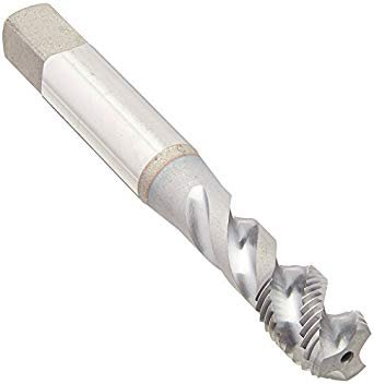

    Its a gun tap. The "gun" comes from the grind on the tip. It "shoots" the chips forward. It is made for through holes. It is literally the worst tap to use in a blind hole. All the chips get piled up ahead of the tap and binds it worse than a normal hand tap.
    mgtstumpy and loudbang like this.
  2. Roger said just the opposite. The design of the tap is that it removes the chips so it wont bind. Whatever it is the tap worked great. I would use it again. The holes were tapped with the ***ist of a center in the mill. They were tapped the holes were blown out then the tap ran down again. the sites on taps seem to focus on machines tapping the holes. we did it by hand. that may be why it worked so well.

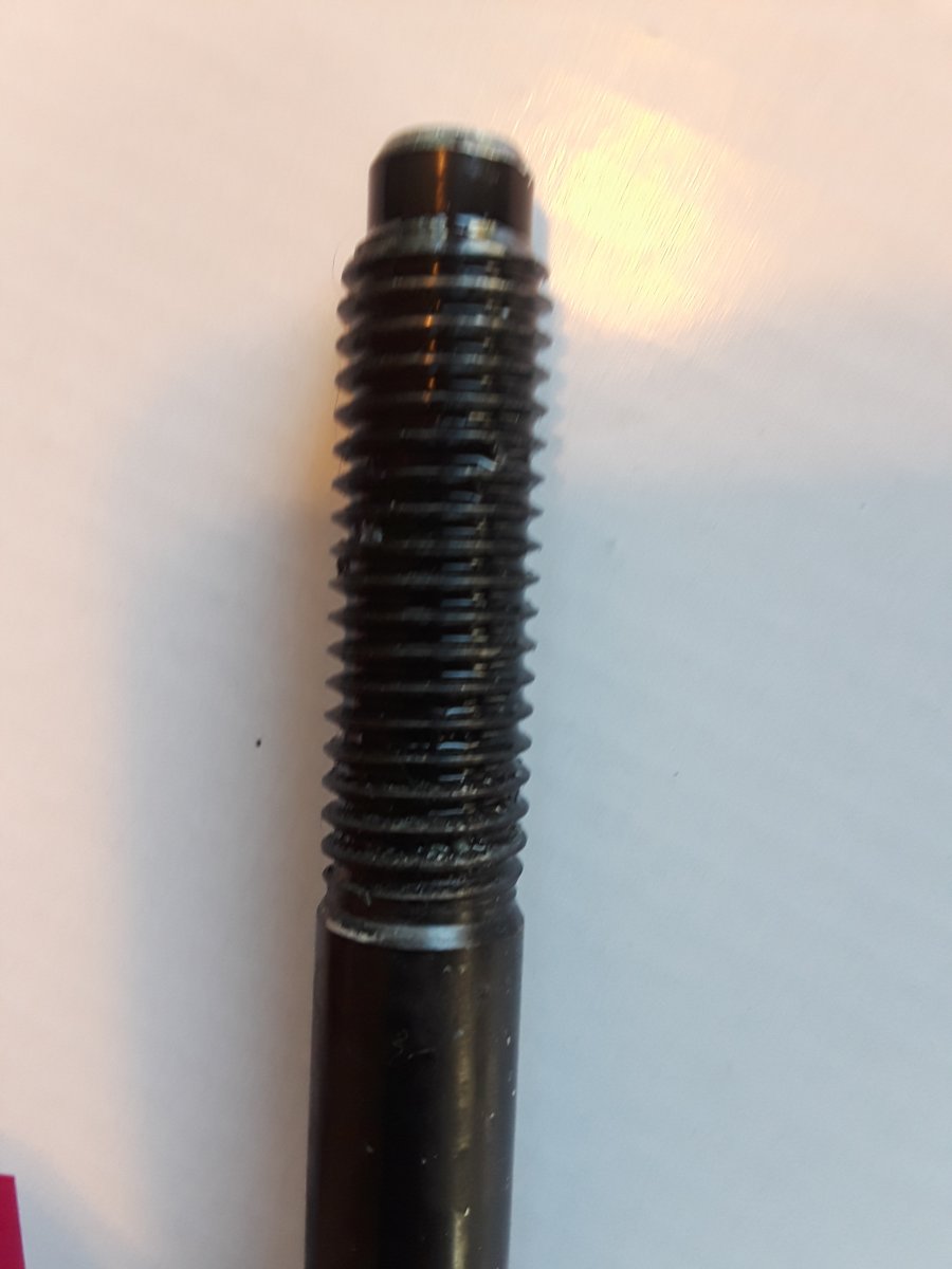

  4. 20191023_164526.jpg 20191023_164517.jpg I thought some of the same things. As I ran the tap down it cut exceptionally good. As I reversed rotation to break the chip I couldn't feel anything. After I blew out the hole the tap turned about one more turn if that. After I read the tapping info sites it had me thinking about thread forming taps. I have never seen or used them.

    I am not here to say one way is right or wrong. I was taught by a long time machinist, that any time a blind hole is tapped using a mill to use a spiral fluted tap. Be generous with the cutting oil, unlock the quill and let the tap draw itself into the hole. The flutes of the tap draw the chip out of the hole and the threading is a single p*** operation. 41Rc4a2NpmL._SX342_.jpeg
    Sent from my XT1710-02 using The H.A.M.B. mobile app
  9. i should have been more clear on my post. I used the mill with a centering tool in it to help keep the tap straight. I ran the tap by hand as I kept steady downward pressure on the tap with the mill. slow yes but effective. im not good enough to try power tapping holes in my block.

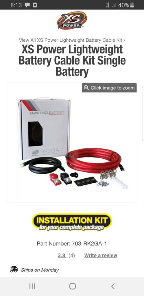

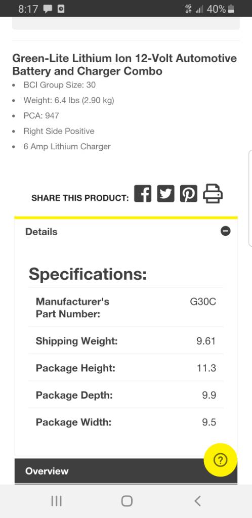

    Have you seen this battery cable? It feels like a piece of rope its super super lite. I have it on the Skairlane works great. I also run a lithium battery its 6.4 pounds. Been running it 3 years with no issues. My car is 15:1 compression wings it rite over. I put it to the test also I very rarely prime it to start it. Screenshot_20191103-201351_Samsung%20Internet.jpeg Screenshot_20191103-201701_Samsung%20Internet.jpeg
    Sent from my SM-G950U using The H.A.M.B. mobile app
  22. Thanks. I will be looking into that. I will also see if they are at the upcoming pri show.

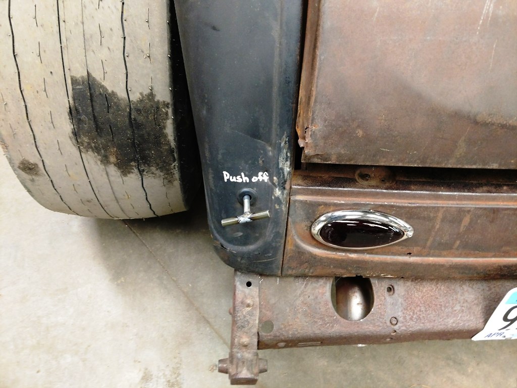

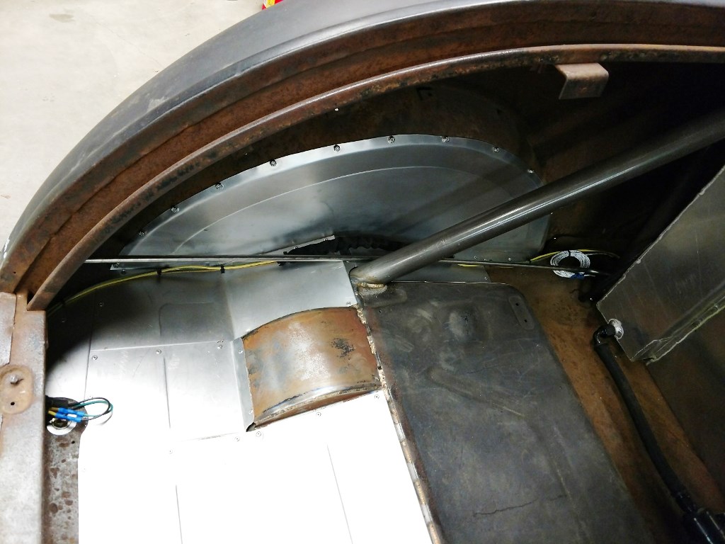

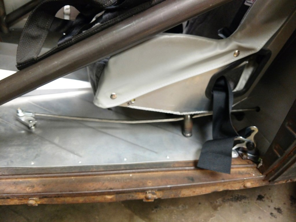

    Here is how I do mine. The lithium battery is on the inside of the frame rail by the transmission. The cutoff switch is under the driver side floor, so I can operate it from inside the ****pit if need be. The 5\16 x 16 ga 304 stainless tube weighs 1 pound and operates it fine. There is only a couple feet of cable total. This set up spins the 13.5 to 1 Hemi over like the plugs were out of it.
    Tim, Stogy, catdad49 and 5 others like this.
