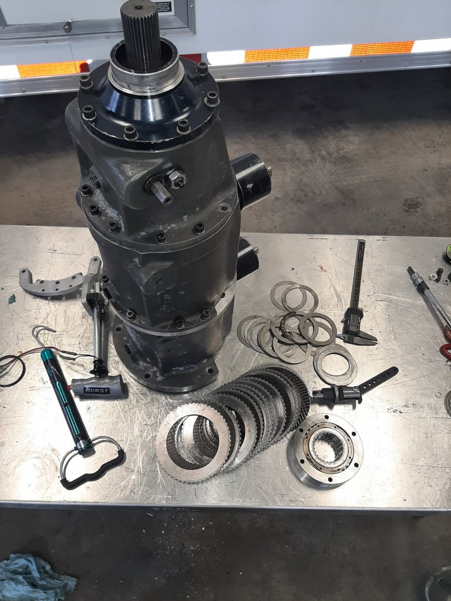

  21. 20200324_135038.jpg I received a care package from lenco so I found a way to keep my social distancing going. I was exposed to a patient that tested positive so they wouldn't let me go to work out out caution. I'm not experiencing symptoms so im looking at it like a paid vacation. I changed out all the seals and o rings. The sprags looked good but i changed them out for new ones along with the bolts. I changed out one clutch pack with steels. The shift pressure was shimmed to 35-38 lbs. Two case bolt holes were weak so they were fixed. Two and a half quarts of 30wt and it's ready for service. The parts that were replaced will make good spares. You can't ever have too many spares.

  22. Looks great Brian ,
    It would be cool to see a few pics of the inside next time,,,for people that have never seen one before,,to understand how they work .
    An I ***ume you meant sprag in your post,,(,it even corrected my typing just now,,,lol .)
    These crazy electronic gizmos,,,,LoL .
    Lencos are awesome and ( almost),,,bulletproof .
    Tommy
  23. Look through the thread pages 8,9,10. I covered the subject in detail then. Lots of pics.

    How much does that Lenco weigh?

    Lot's of shim's there Brian, guessing that was just a pick through not a stack up.
  27. The weight depends on how many speeds it is. If you look at my pic there are two large cases bolted together and one smaller one. This shows it's a three speed with a reverse. To add another gear a large case is bolted on.
    The other variable is the parts inside. The newer parts are lighter weight.
    Then there is the difference between a cs1 and a cs2. The cs2 is lighter than the cs1. Alchohol cars are going to the cs2 for reduced rotating weight. The cs1 is stronger so it's the go to trans for nitro.
    All that being said I have a lighter weight cs1. I think it weights about 100lbs.
    chryslerfan55 and mad mikey like this.
  28. The pressure needs to be set on the clutch pack. There is a special lever that's used with a fish scale. The lever fits in a shift tower. Its screwed into the case. When it touches the shift fork its unscrewed two turns. The scale is attached to the lever while in neutral. The scale is pulled until the lever shifts into gear. The amount of lbs it takes to shift is recorded. Lenco has a chart with the specs needed. A nitro funny car will need more pressure than a pro stock for example. Shims are used behind the pressure plate to arrive at the required setting. A typical starting point would be a .030 and a .015 to start. The case is put together and a pull made. If more pressure is needed shims are added. A shim of .010 makes a difference. The trans can be damaged just as fast not having enough pressure or having too much. A air shifted trans like mine is not as touchy as a manually shifted trans. The air shift pod will keep pushing down as far as it can go.
