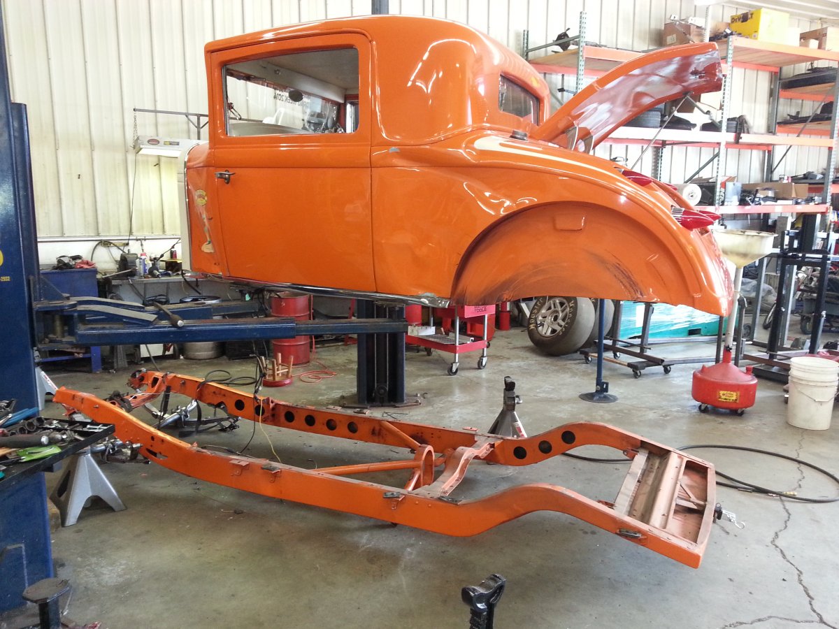

  3. methodical is right. the lower bar could not go in earlier because of the amount of welding going on. the frame needed to stay supported on the jig until it was strong enough . welding on the lower frame rail too soon could have caused everything to twist. there was also concern that the two main frame rails would curl upward in front of the firewall. the frames designs are run through a computer program that tests the loads. there is no guessing. it seems like only half of the tubing is in place. the funny car cage; engine travel limiters; cross bracing on the floor and all of the bracing on the rear of the car needs to go in. there are very strict rules regarding the placement of all the bars. to get the ch***is tag i need there can be no short cuts. this frame will be inspected by nhra. there are several different ch***is tags. they all have a cap on them for et. I'm going for a 7.49 and quicker tag. this project is really starting to get fun now that its starting to look like something. i was looking at a pile of tubing on the floor of the shop just a few weeks ago.

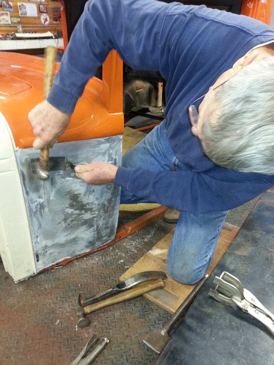

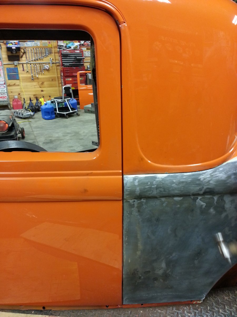

  21. 20151221_170511.jpg 20151221_172055.jpg 20151221_172056.jpg 20151221_183301.jpg 20151221_190230.jpg 20151221_204753.jpg 20151221_204743.jpg It was another day of body work. We roughed it in yesterday. Today it was heat shrinking. The torch heats a spot about the size of a dime until its just turning orange. With a dollie on the back side the heated area is hammered. This shrinks the metal. Its amazing how the panel goes from oil canning to tight. It works best with two people. One runs the torch the other hammers. That way the heat isnt lost setting down the torch and grabbing the hammer and dolly. the shrinking leaves the panel looking like a leopard with all of the spots on it. Once the shrinking was done the low spots were hammered out. I was inside the car. Jack would be on the outside and tell me were to hit the panel. after i hit it he would say things like over a quarter inch up a half inch. This hammering went on for some time. We hung the door and it fit perfect. Then the file work began. The body is very close. After its mounted on the frame again the final work will be done. Im glad that part is over. Im off to the ch***is shop tomorro to drop off parts. If there are any body shop guys reading this feel free to comment.

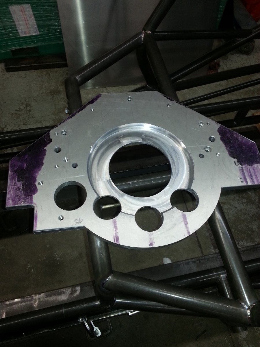

  24. The axle tubes were turned down and pressed in. The axles four link brackets are done. There is a fixture to hold everything in place before the brackets are welded on. The mid plate received some attention. It has been lightened and ventilation holes were drilled into it. There needs to be holes not only to cool the converter but also to have access to the converter/flywheel bolts. The ch***is was flipped over again to get ready for the drive train install. 20151222_155415.jpg 20151222_155338.jpg 20151222_161204.jpg

  28. one of the new things jack taught me this time around was how to pound out the dents without putting more in. in the first few pics the paint is on the panel as we worked on it. this was done on purpose. the paint and light bondo skim coat prevent the hammer from putting in new dents and marks. the paint acts as a cushion. later on the paint and body work were removed with a propane torch. heating the panel from the back side makes the material release its bond then its s****ed off with a puddy knife. a small wire brush removed the little that remained in place. this process was fast and easy with no dust. don't get the panel too hot. it doesn't require much heat. a drop light was then used. it was placed so the light went up on the panel. the high and low spots were easy to see. i could have just sent the car out to be fixed but i wouldn't learn anything that way. i find it all very interesting how jack does his work.
