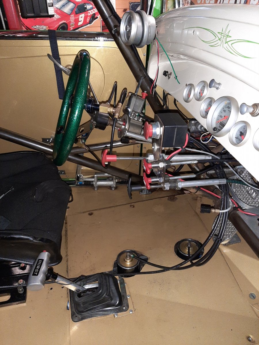

  16. 20200423_171105.jpg I mentioned earlier I was hooking up the tach and shift light. No one can tell me if it can be wired to the efi and the mag so they work with both systems. It's funny that I get the same answer no ones ever done that before. So I guess I will wire it up and see what happens.
    Do to the msd 44 amp mag a converter box needs to be wired in to change the signal to something they can read.
    I wired them up per the diagrams. The only wire that's shared between the two systems is the signal wire for the tach. The shift light is not set up to work on the efi side.
    It would be cool to flip back and forth between the two ignitions and have the tack work. 20200426_183119.jpg

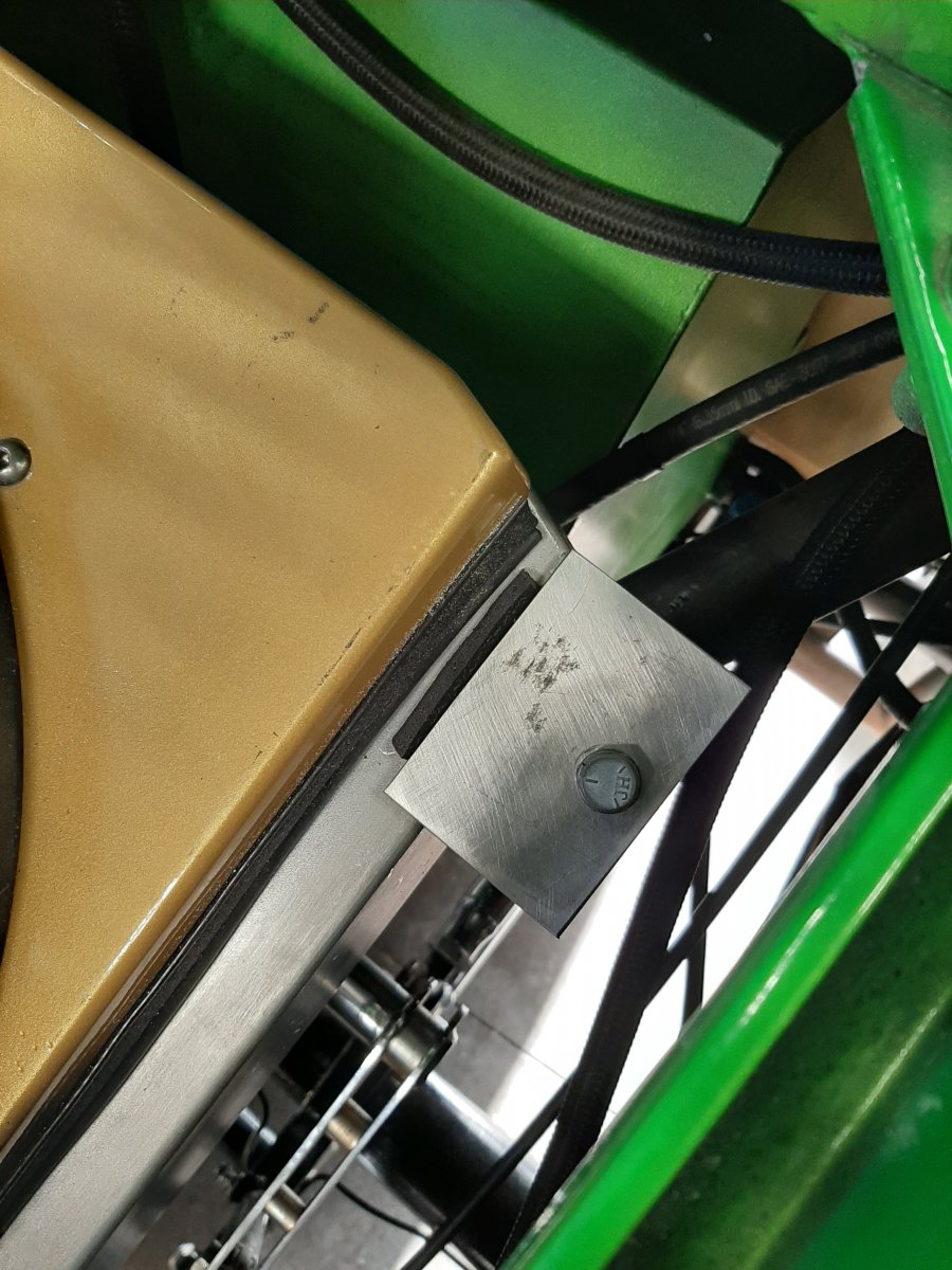

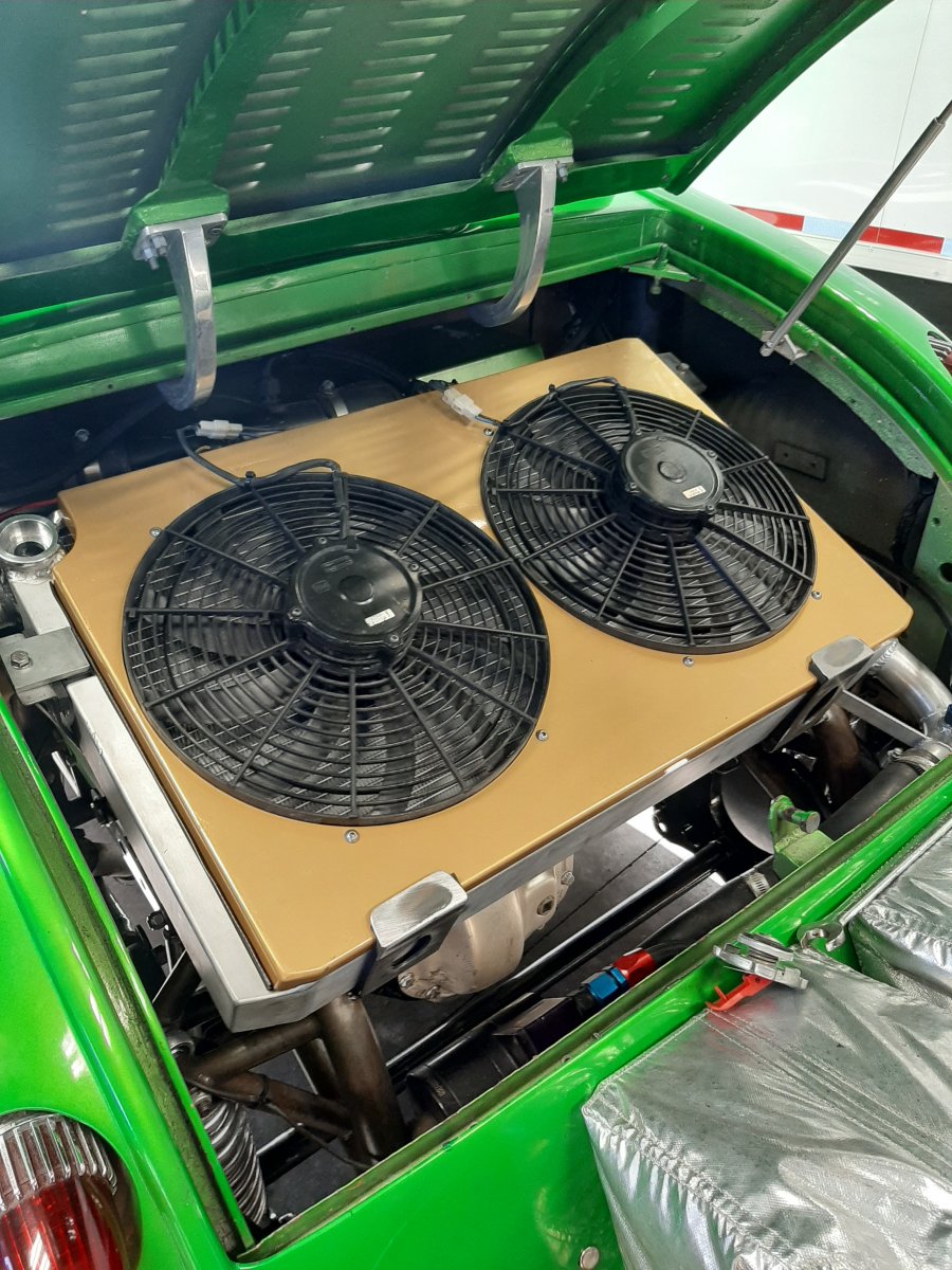

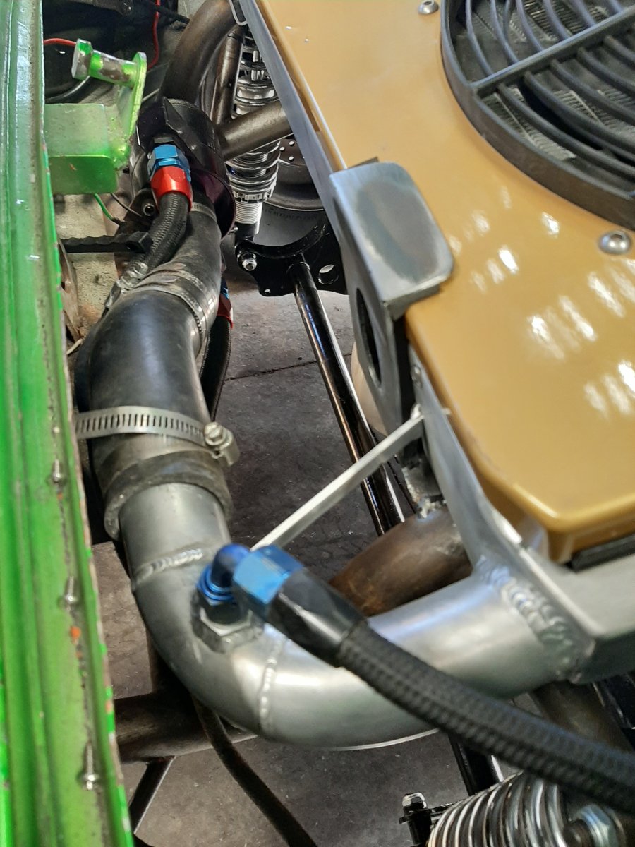

  26. 20200503_183101.jpg 20200503_183101.jpg It sounded like a easy thing to do mounting the new radiator. The old radiator cracked. We think it was mounted too rigidly or unable to move a little when it gets hot and expands. The new design allows it to float on soft rubber.
    Mounts were drawn on paper to get the correct dimensions before metal went in the brake. After cutting and bending they went into the plasma cutter. I have only seen hand held plasma cutters. It was cool to see this one in operation. A picture was drawn on paper. The machine sees this image and cuts it automatically. The lightening holes make them look better and save weight.
    It was tricky getting the radiator in the exact place I needed it. I used the pre existing sheet metal that goes around the fans to get it just right. The rear mounts could be tig welded. There was no room to get the uppers like that. Those were hit with the mig welder from below. The bottom mounts are like hooks. The radiator slides down into the padded mounts. They are very strong and under acceleration support the radiator. The top mounts have a nut welded underneath so I can remove the radiator myself. If I didn't take this extra step it would take another person working from under the car. The bolts are tightened down pushing the padded aluminum plate to hold it all in place. The upper mounts also keep it from moving side to side.
    While parts were waiting to cool I saw that the anti roll bar bushings had moved out ward. There are collars to hold them in place. After the parts were chromed they must have been put back on the opposite side of the mount. It's a good thing I took it all apart. The bushings were stuck on the bar. Dirt got in there causing a bind. Everything came apart and was cleaned. The links with heim joints were stuck. Those were also cleaned and lubed. They now spin with my fingers. View attachment 4670988 20200502_123726.jpg 20200503_183043.jpg 20200503_183051.jpg This project took the better part of eight hours. I just need a new fitting for the radiator and a new catch can and it will be ready.
