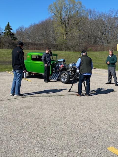

  25. Mark my drag week buddy stopped by so we could fire the car on nitro. On sunday after street driving I did alot of service work on the engine. This includes cleaning and inspecting the filter. The heads were retorqued. The lash was reset. The engine was leaked down with all cylinders at four percent or less. The barrel valve was leaked for today's fun. The tires and headers were changed over to the race setup. The oil pumps pressure was adjusted.
    The car fired up fine on nitro. It has a mild tune up in it. The barrel valve is set at 83 percent leak. The timing is set at 40 degrees. The nitros at 70 percent. The car is heading to Brownsburg indiana friday. We are going to legendary racer Larry Dixons race shop for more pr stuff. The summit midwest drags promoter has set up a video deal. By invitation only some of the faster street cars will be doing burnouts along with driver interviews. These promotional events are helpful in promoting not only my car but parts on my car. The QA-1 shock deal came about in part because of the two events I'm participating in these two weeks. With everyone else's cars sitting in their garages getting mine out in the social media world is a big deal for these guys. There's no free lunch. The promo possibilities are big this friday. Who knows what doors it will open.

  28. At 83 percent the pipes are just slightly wet.
    The oil pressure at temp at idle is 85lbs. At full rpm its 150 through the lights.
    For those not familiar with a nitro car at idle the barrel valve has to be set by percentage of leak at idle. Every engine is different. Most nitro engines running a good load are in the 75 percent and up range.
    When the car is running I look into the zoomies. If they look flat black this is somewhat lean. If they have a shiny wet look a few inches down inside the pipe that's good. Wet pipes to the end or raw fuel coming out is too rich.
    Getting this setting correct is a very big deal. Too lean and it knocks the burst panel out at the hit. Too rich and it uses a bunch of fuel and fouls plugs putting out cylinders.
    With the tune up I have in it there will be no mistake it's on a good load for the videos.
