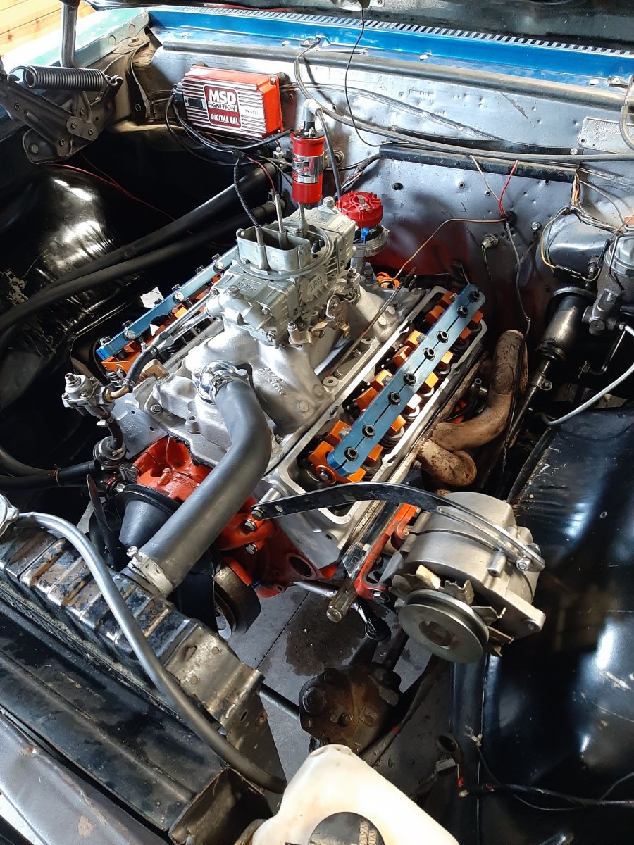

  1. Good old 327 is hard to beat ! Looks good,,,,,in ch***is work ?
    Those are deep valve notches,,,,what kind of cam ?
    Tommy
  2. Yes doing it in the car. I don't recall the exact specs as it's been alot of years ago that I put it in. I think it's around 540 lift with 289 duration. It's a four speed car so I can get away with it. The car has everything gm sent it out the door with and it runs high 11s. We will see what it does with the improvements. It's my car from high school. I don't want to cut it up and make a race car out of it. 20140605_121215.jpg imagejpeg_2.jpg

  12. Thanks. The 327 is almost ready. That project got put on hold so I could get the coupe ready for the out of site drags this coming weekend. 20200620_155540.jpg 20200606_090505.jpg

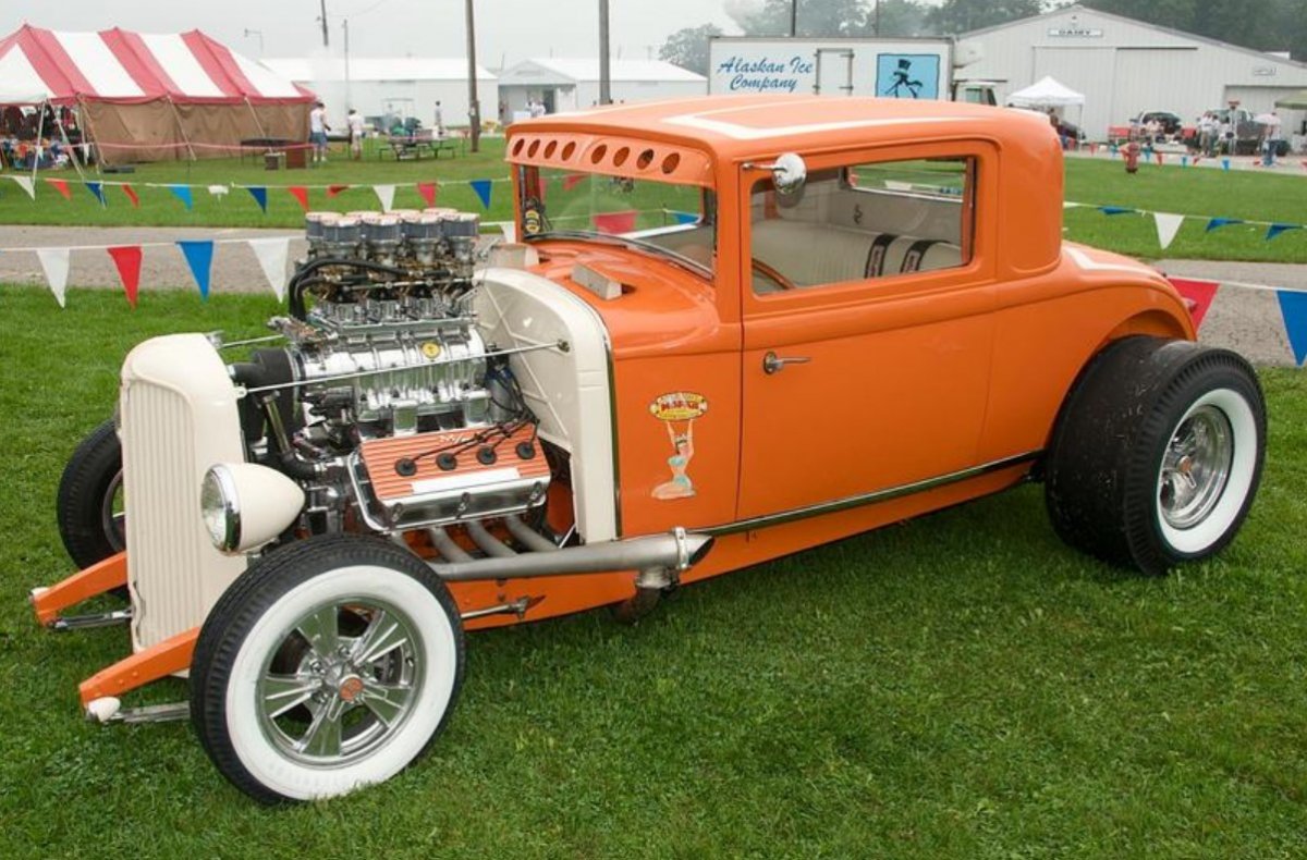

  22. milwscruffy
    Joined: Aug 29, 2006
    Posts: 4,183
    milwscruffy
    Well it's nice to watch and learn and then pull the trigger. Blower and injection are next on the list
  23. Street or strip? Efi or mechanical?
  24. milwscruffy
    Posts: 4,183
    milwscruffy
    Mostly street, some occasional strip use. EFI Hilborn, leaning towards 2 port.

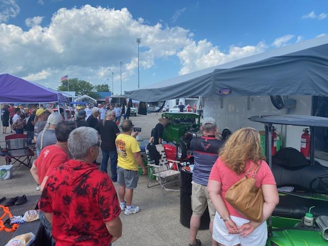

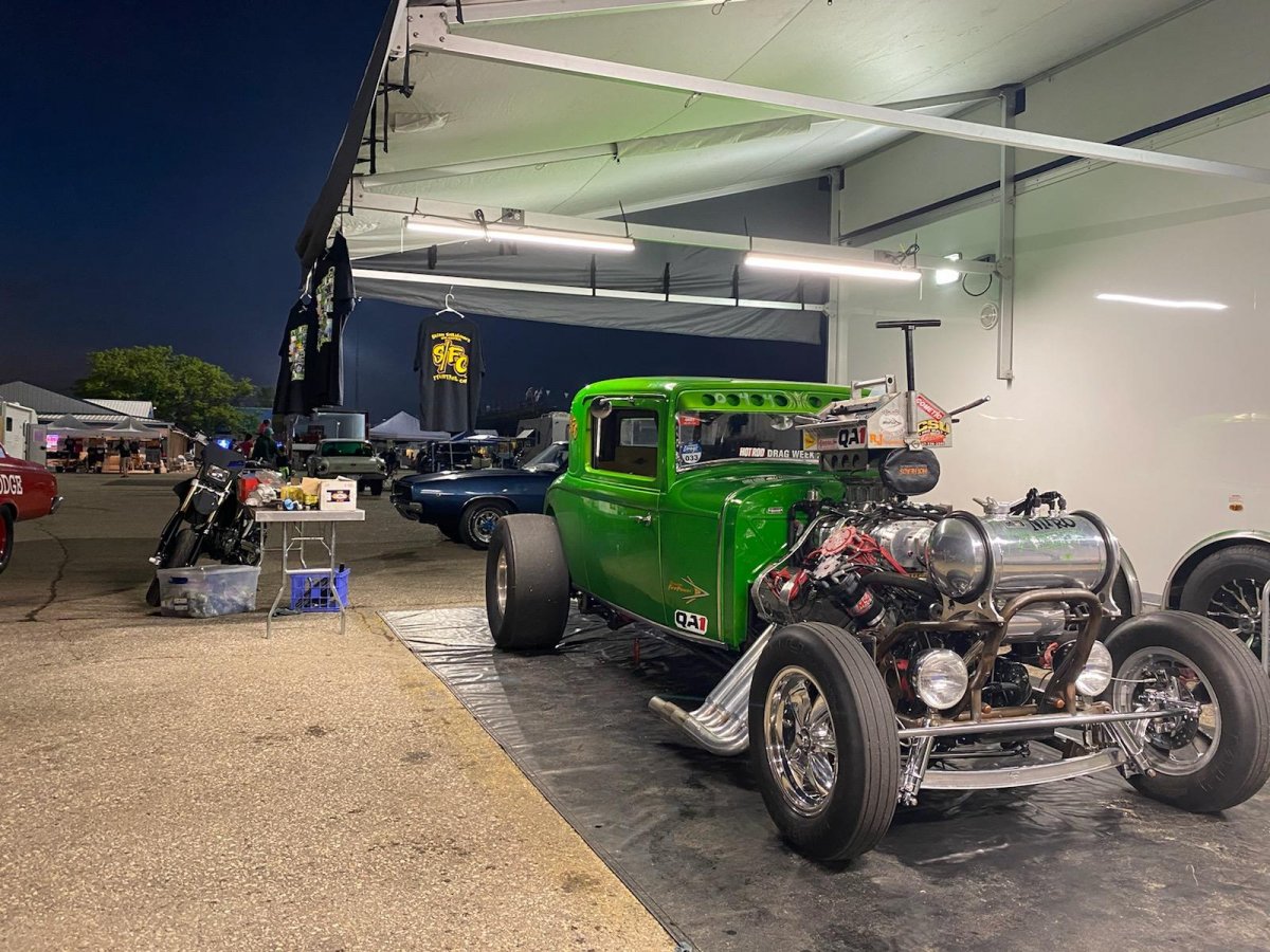

  26. I'm on Facebook now as of sunday. I'm not really sure what I'm doing. There are some videos posted from the weekend. I'm not sure how to get them on here.
    The weekend went great. The testing is complete. We found the tighter bearing clearances work to control the oil pressure. The shocks are working now. The car still hops a little we can fix that with more air pressure and more timing. The new regulator works great. The car attracted a big crowd each time we fired it up. IMG_1186.jpg IMG_2510.jpg
