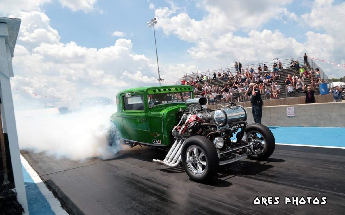

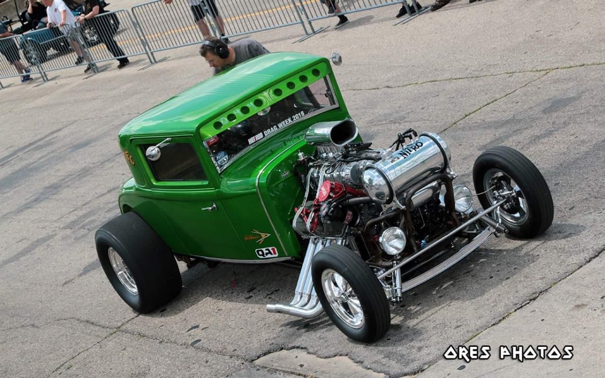

  2. Pic from the out of site drags. Car ran good. On p*** two I shook the tires hard. Little did I know the timing got knocked back 15 degrees retarded. Thirty degrees total doesn't get it on a nitro car. It still went 8.0 letting off at 900 feet. IMG_51311.jpg

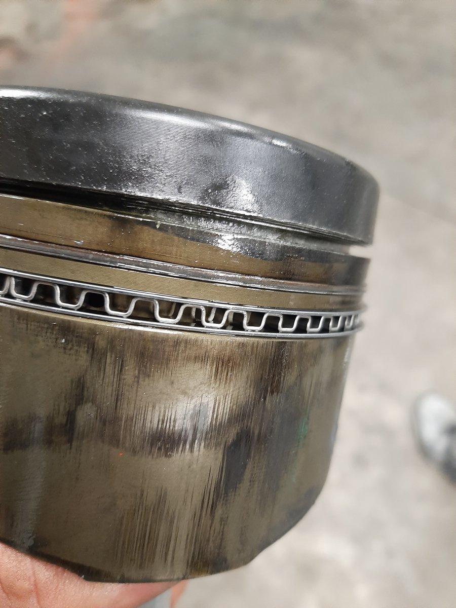

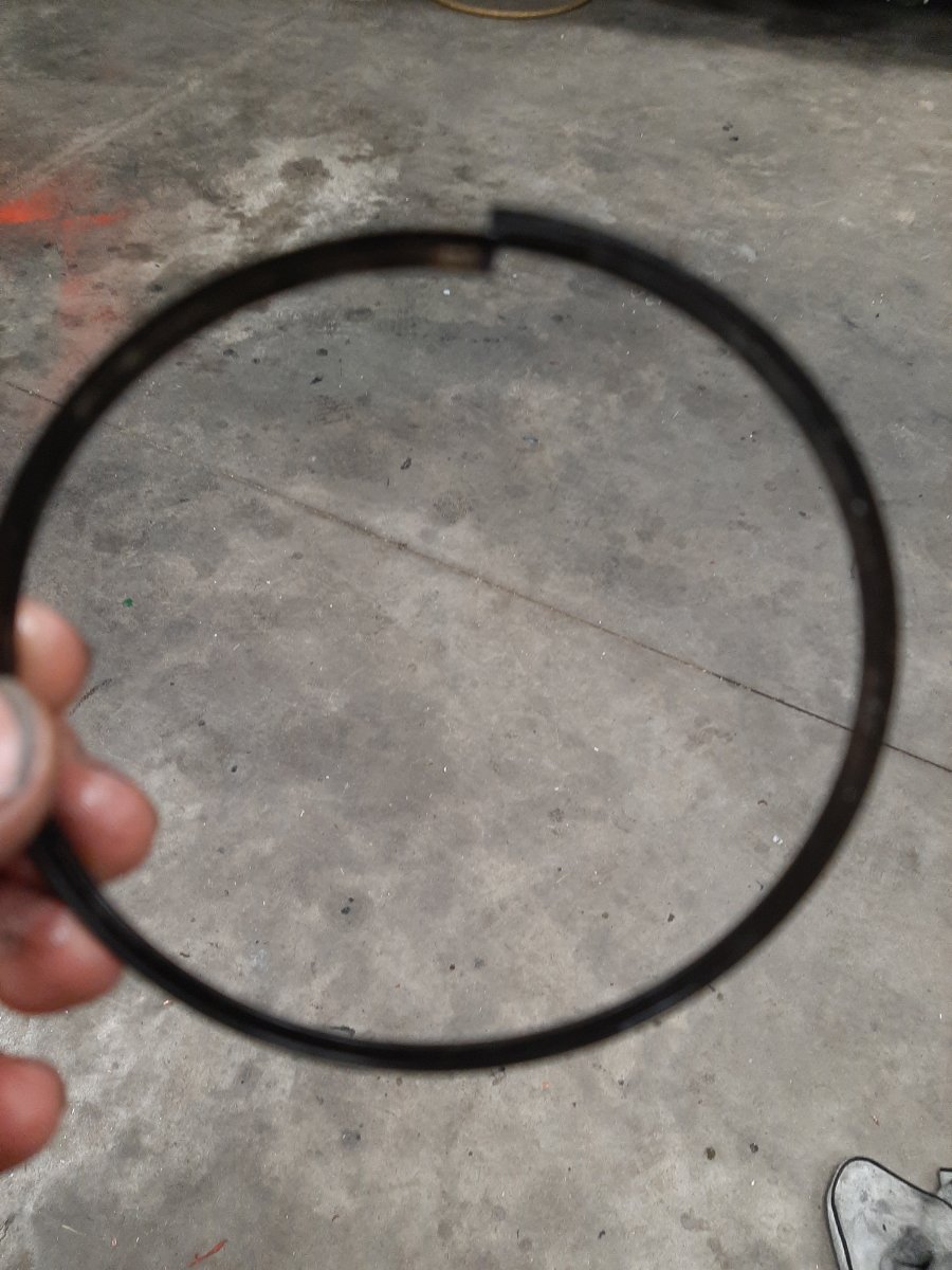

  28. After the timing advanced to a very unsafe level some maintenance had to be performed. A leak down test was done as usual. Number 1 and 3 were at 80 percent leak. My cylinders are usually 5-15. The head needed to come off. Upon inspection the exhaust valves were burned. I had some new spares to put in after the seats were touched lightly. The springs were all run the the tester. A few were replaced and all are back at 340 pounds. Normally this would fix things but something said dig deeper. I pulled the pan to pull 1 and 3 piston to inspect the rings. Sure enough they lost their tension. The end gap was gone. The ring grooves looked bad so the two pistons will be replaced. I have spares to fix all that to. Seeing as the pan was off I looked at the bearings. Glad I did that. Number 6 was looking real bad. It most likely would not have lasted another p***. All the bearings were changed to a set .001 larger for more oiling. This is why I'm always preaching about preventative maintenance. Catching little problems before they become huge problems. It will all be back together this weekend. It will be going to the nsra show in Louisville Kentucky next Wednesday. It will be in the flitz booth. I will have hand out 8x10 cards to sign and give away. Stop by and get yours. The lesson from all of this is when the timing gets disrupted bad things can happen. Take the time to carefully inspect everything. Fix what needs fixing. 20200731_220128.jpg 20200731_220207.jpg 20200731_220003.jpg 20200731_220030.jpg 20200731_220652.jpg
