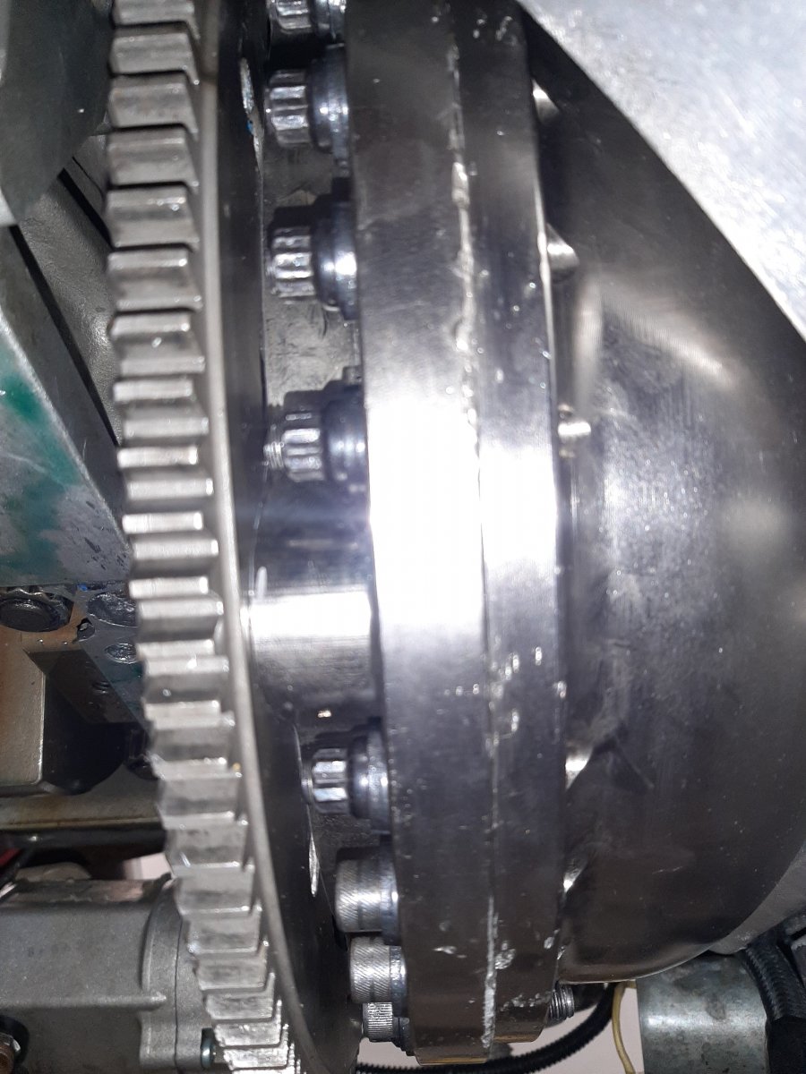

  8. They are paying more for cars running 80 percent or more. So show me the money. That's if I can make it. Turns out the converter wont fit. I have removed all the material I can from the pads and hub. I threw in the towel at 4:15 am. The only option now is cutting up a mid plate and using it as a spacer. A new trans mount will be required.
    The sun came up quick this morning. A guy that helps racers set up their ch***is stopped by. He sets up all the fast cars in my area. He watched the videos then made a suggestion. The anti squat on the four link was 50 percent. With the tires getting hammered so much a four link bar adjustment was made. The new setting is 99 percent. The car should drive out now. With the reduced squatting I can tune the shocks more. Every time out we learn more. 20200816_042400.jpg 20200816_042407.jpg

  24. its going to be close. the hub on the converter is not engaging the pump. so there is no pump pressure resulting in no power to the wheels. a new longer hub has been ordered. they bolt on as compared to my old converter that welded on. it will arive thursday afternoon. if i can make it all fit and it gets all put back together i will leave for iowa thursday night. i see a big thrash in my future. fingers crossed.

  28. Ups arrived on schedule. By 1pm I fired it up minus the lenco. The converter was leaking. A weld had cracked. Pulled it apart for a repair. Put it back together without the shims on the flex plate. Fired it up and no pressure. Unbolted the converter and added the ***anium spacer for .125 more pump engagement. Fired it up and it only has 50lbs of pressure. It needs 150. I will call bruno in the morning. If I can figure it out I will still try to make the qualifying round. It's not looking good but I will try.
