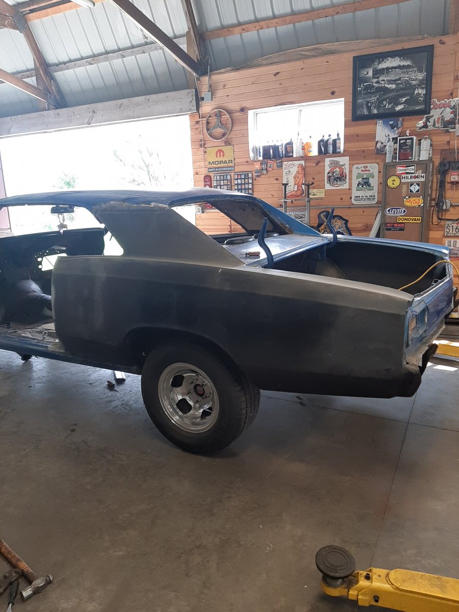

  22. The pump gears can't be flipped. I brought the pump housing to bruno. He ground new gears to match the pumps depth. To get the right clearances the bellhousing was modified. The large bumps were milled off. Now that the converter seats deeper the mid plate spacer can be removed. Life is good again. I have been working on the 66 chevelle lately. It's getting a nos drivers side full quarter and floors. It's completely apart. Its past the cut off date for the hamb so I'm only posting pics one time of it. The shop is finally getting some time to. The big insulation project is mostly completed. Next race the fall out drags the first weekend in october. Rockfalls raceway. 20200914_191749.jpg 20200915_135602.jpg 20200916_212614.jpg 20200919_191106.jpg 20200919_191052.jpg

  25. Body work is not something I have a lot of experience in. I consulted a few friends before I started. I need to do the drivers full quarter and trunk floors.
    The question I had for these guys do I seperate the body and frame first. I have a rotticery and do the floors first. Or leave the body on the frame and do the quarter first. They all said do the quarter first it's on a stable platform. I will put new rubber body bushings in before it goes on. The trunk; door with new pins and bushings and fender will go on before any welding is done. The whole drivers side will be on to align everything. I will work on the floor next with the body off. It's getting a new floor from the firewall to the bumper. That's alot of work but it's the best way to fix what I have going on. Several small spots and I dont want a patched up mess.

  29. The best way to get over 2020 is to get ready for 2021. The hemi us coming apart today for a full inspection and new rods. New rear tires went on last week. I finally got one of the torque converters back. I will have a good spare for next year. The ot 66 chevelle came off the frame yesterday. It will get a new floor and a nos full quarter I have had tucked away. It's also getting a 427. This is all happening between all the crazy overtime I have been working to pay for all this fun. I'm not going to get into the shop insulation project. See why I haven't been on here lately. Busy busy. 20201107_133944.jpg 20201106_191635.jpg
