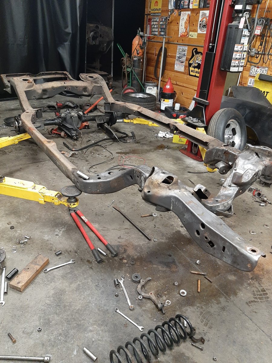

  6. The ch***is was completely dis***embled and every part sandblasted. New brake lines; fuel line; control arm bushings; calipers; and all steering components are new. I up graded to disc brakes along the way. It's now in the trailer for winter storage so it's out of the way. Next up for it floor pan replacement. I'm back on the coupe. New parts are starting to arrive. The usual service items include rods; pistons; bearings; valves and springs. The block is getting some work performed on it. The water p***ages are being opened up. More on that soon. With covid still raging the amount of overtime I'm getting is starting to take a toll. The money is great but I have no time to work on my projects. 20201109_185647.jpg 20201111_141900.jpg 20201203_160742.jpg 20201219_182553.jpg 20201221_095908.jpg 20201221_095902.jpg

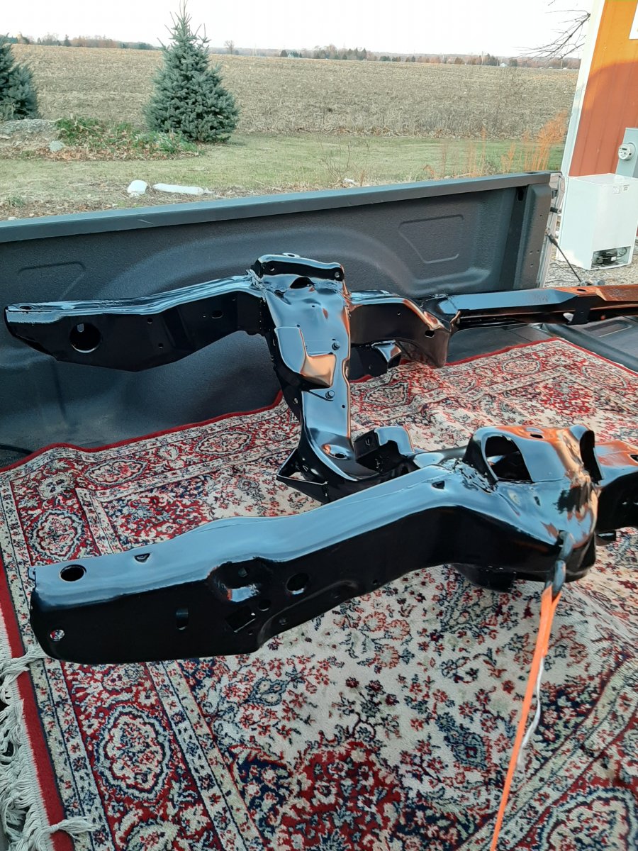

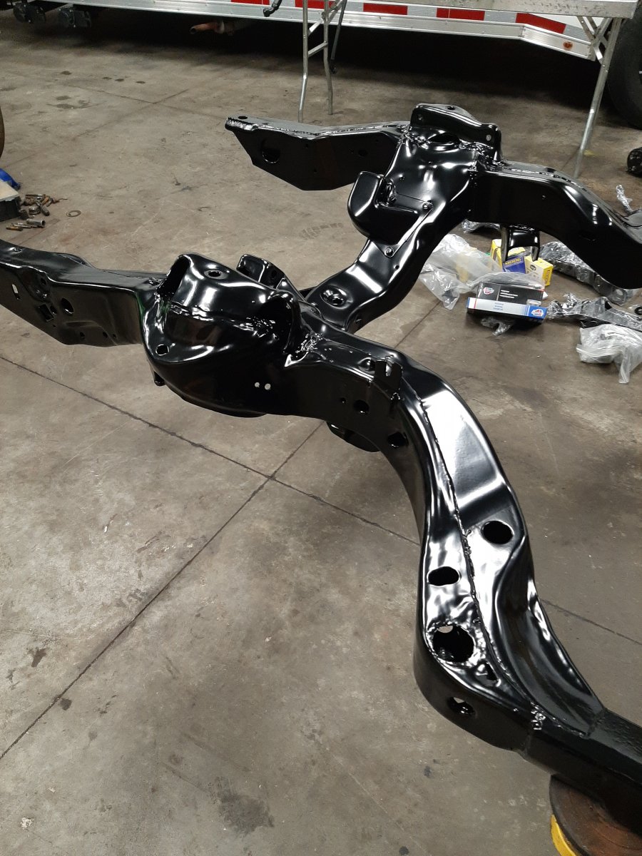

  7. I like the way the frame turned out. They used a two step process. After sandblasting it was sealed with a epoxy coating. The black is a 60 percent gloss to resemble the factory finish. I think it has a nice rich look. 20201203_170754.jpg 20201203_160734.jpg

  11. "After sandblasting it was sealed with a epoxy coating" then "I'm powder coating everything for a long lasting finish".
    I am confused, I thought powder coating went on bare metal but you mention an epoxy coating prior to the final coat/finish ... is the frame painted or powder coated?
    Stogy, chryslerfan55 and loudbang like this.

  13. I was confused as well when they told me how they do things. They use some sort of epoxy finish over the bare metal. This helps seal the parts and fills in the surfaces imperfections. Then the color goes on. This two stage powder coating is what was recommended. It's my first time using it. So far so good. Happy new year to all.
