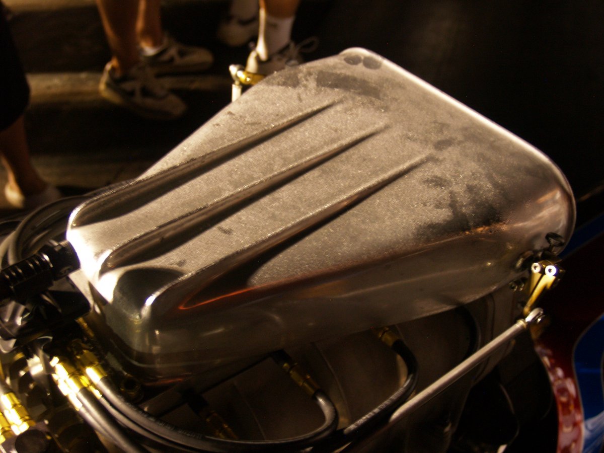

  6. RatPwrd
    Joined: Apr 15, 2019
    Posts: 249
    RatPwrd
    PA222303.JPG Poachers car, injector frosted up after the Cacklefest:cool: PA222304.JPG
    1947knuck, mad mikey, enloe and 3 others like this.
  7. Those Enderle three rib hats are cl***ics. The frost on the hat is normal. The ice on the ****erflies causes the problems. Strong return springs are important along with a toe loop on the pedal.
