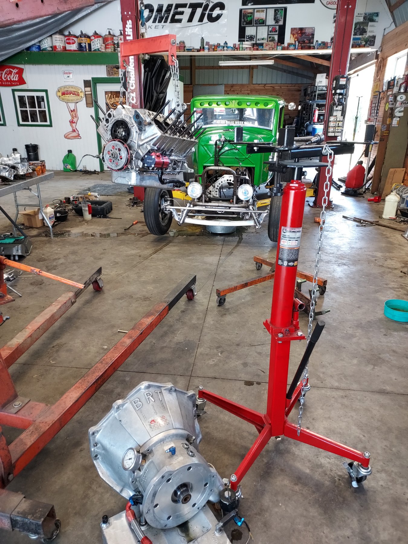

  2. After a 8hr ride home i knew i wasn't going to sleep without taking a look inside. A leak down test showed 1 and 3 leaking 100 percent. Most likely a bent valve. No big deal i have a set of new ones. The seats just need to be touched up. The cam looks good. The trans is out. The rest of the engine will be out before lunch. Updates coming soon. 20210601_220433.jpg

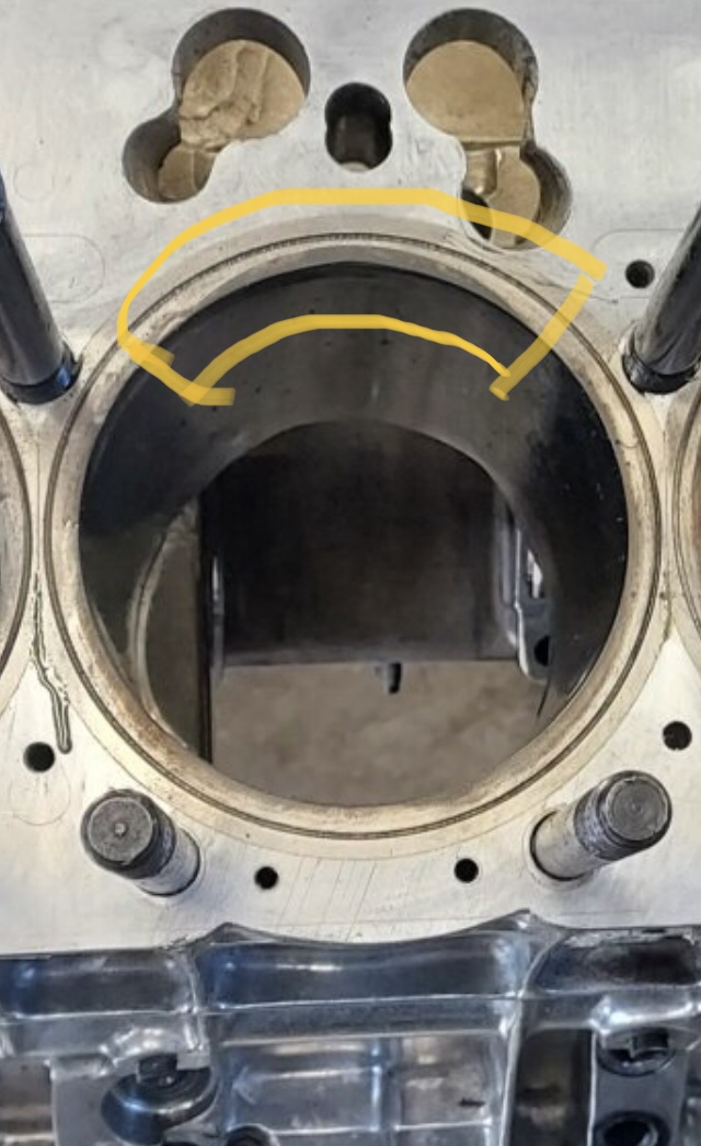

  9. As you know mike a close examination of the parts tells you alot. With that being said pinched rings are only the start of the damage. New pistons and rings will only help so much. The bores go out of round. They need to be honed a special way. A rigid hone needs to be used. They are special. The force against the wall is so great a big ugly high torque drill is the only thing that will spin it. A steady stream of wd-40 is used. It works best with two guys. You are constantly tightening for max force. You can feel it when they are round again. The sleeves are so hard the bore diameter hardly changes. The bore is 4.187 if its off .001-.002 thats alot of surface area to leak. Usually 35-50 percent. Its worth going the extra step to get them round again.

    Brian, is that a bend in the top of the sleeve on the left front?

    The top edge is relieved slightly for intake valve clearance and to enhance breathing.

    Jim, I'm looking at the top not the sides. It looks like a dent pushing towards the intake.

    Yep thats the spot, Thanks.

    The valves are at the top and bottom,,,,not the sides.
    The sleeves look fine to me,,,,,a light honing by Brian and all will be in order .
