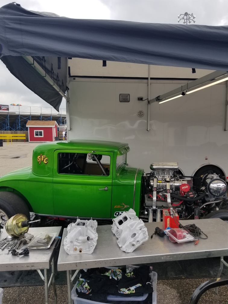

  24. Now that i have decided to put a cross ram on the 427 i brought a few manifolds to sell. One is a original factory unit the other one is a old tarantula. Both are perfect period pieces.

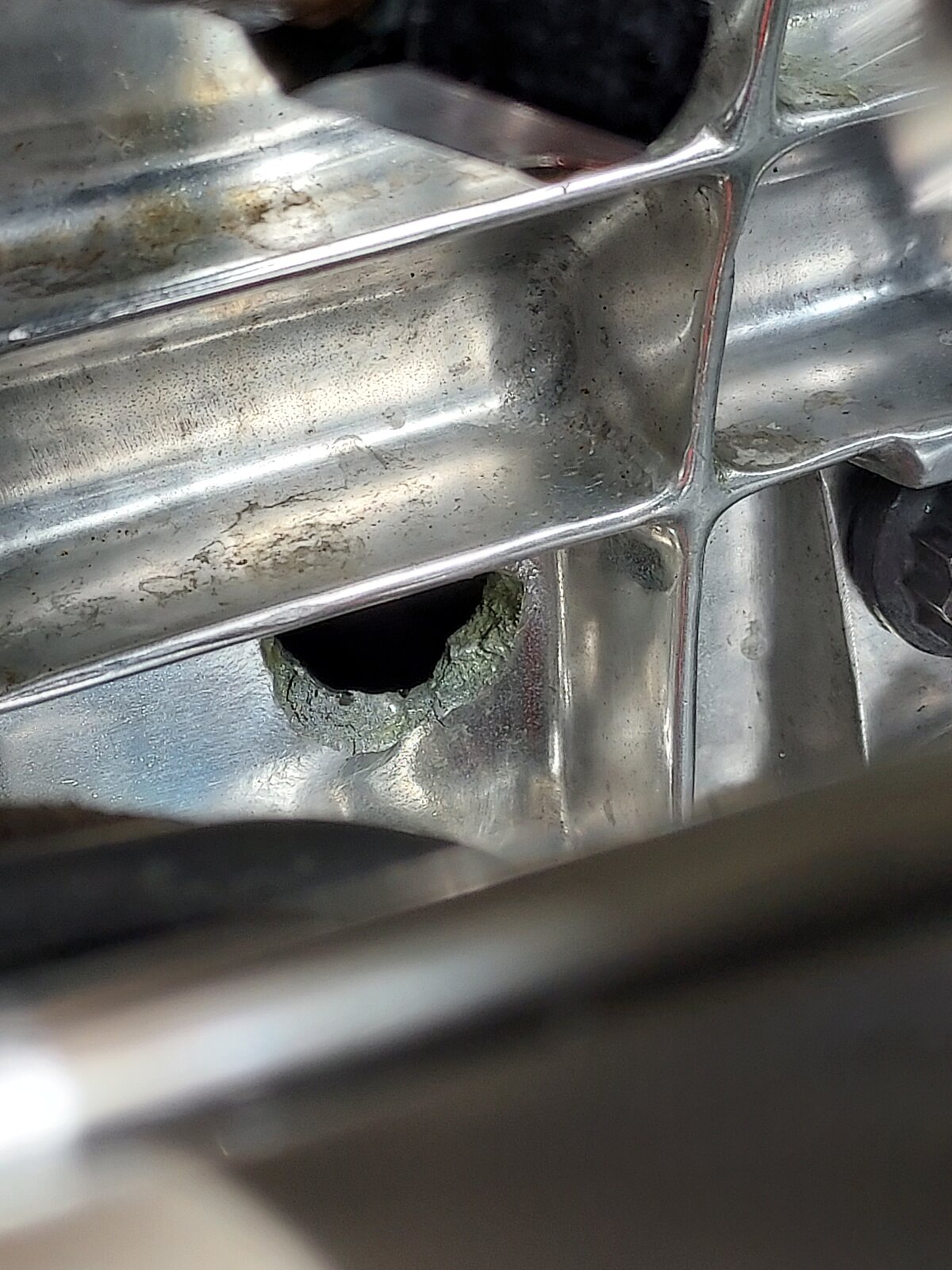

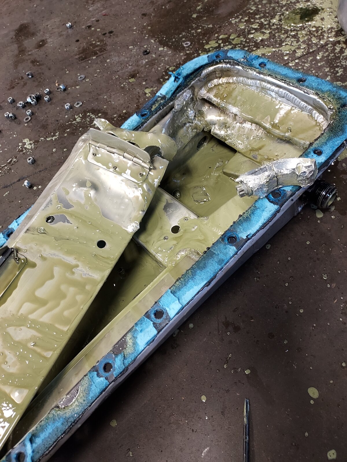

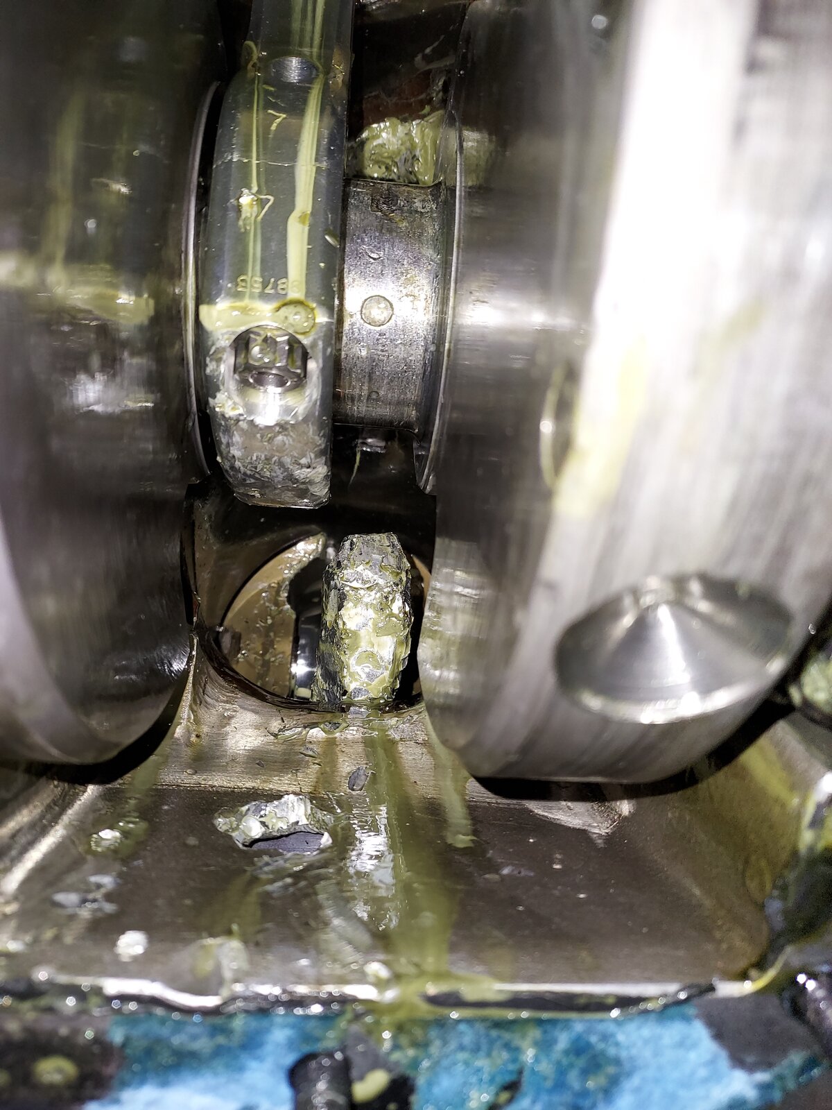

  28. I have had better days at the track. Lots of work to do to fix this mess. It happened on a burnout. My hunch is a head gasket got torched and hydrauliced number eight. The bearing isnt black and the rod bolts are not broken. Alot of water came out sith the oil. The water at the deck can get so hot it turns to steam. Steam can generate alot of pressure. I might have to start draining the block before a p***. On a good note the new four link setting delivered a 1.20 and a 1.180 sixty foot. Its getting there. 20210626_165722.jpg 20210626_194637.jpg 20210626_194653.jpg
