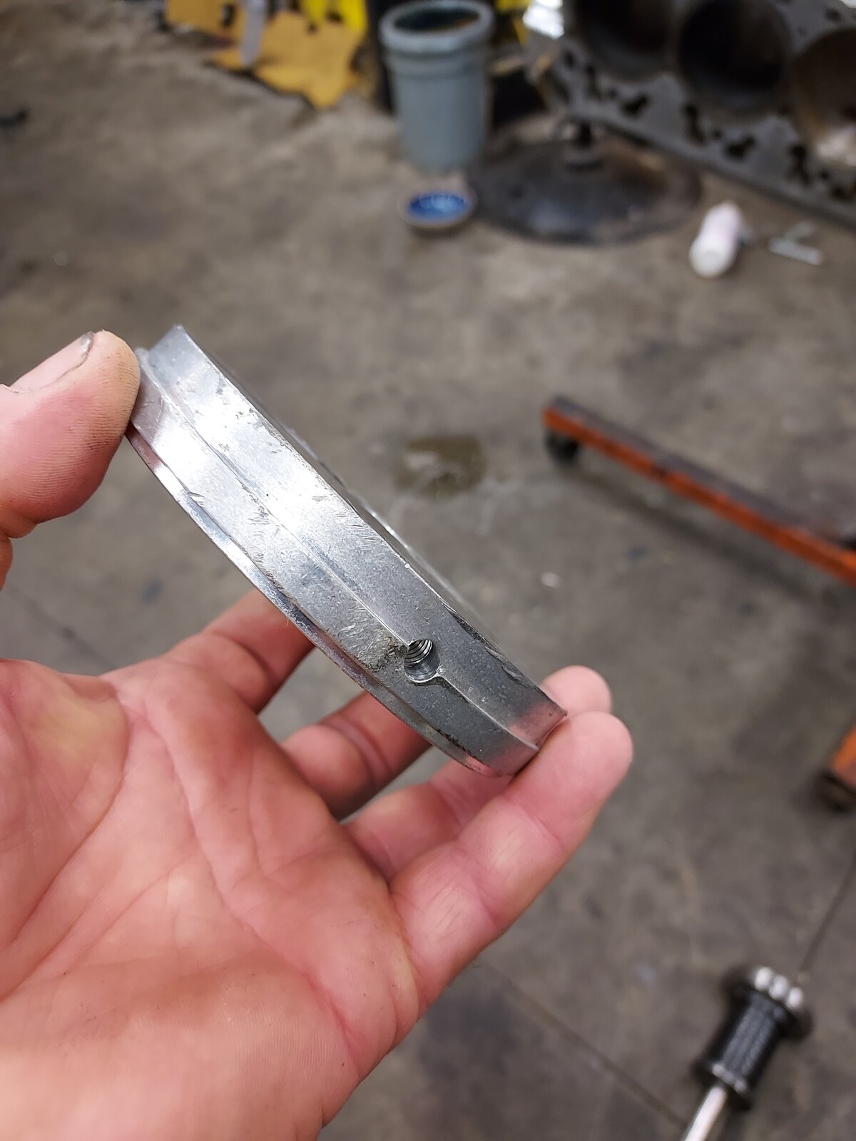

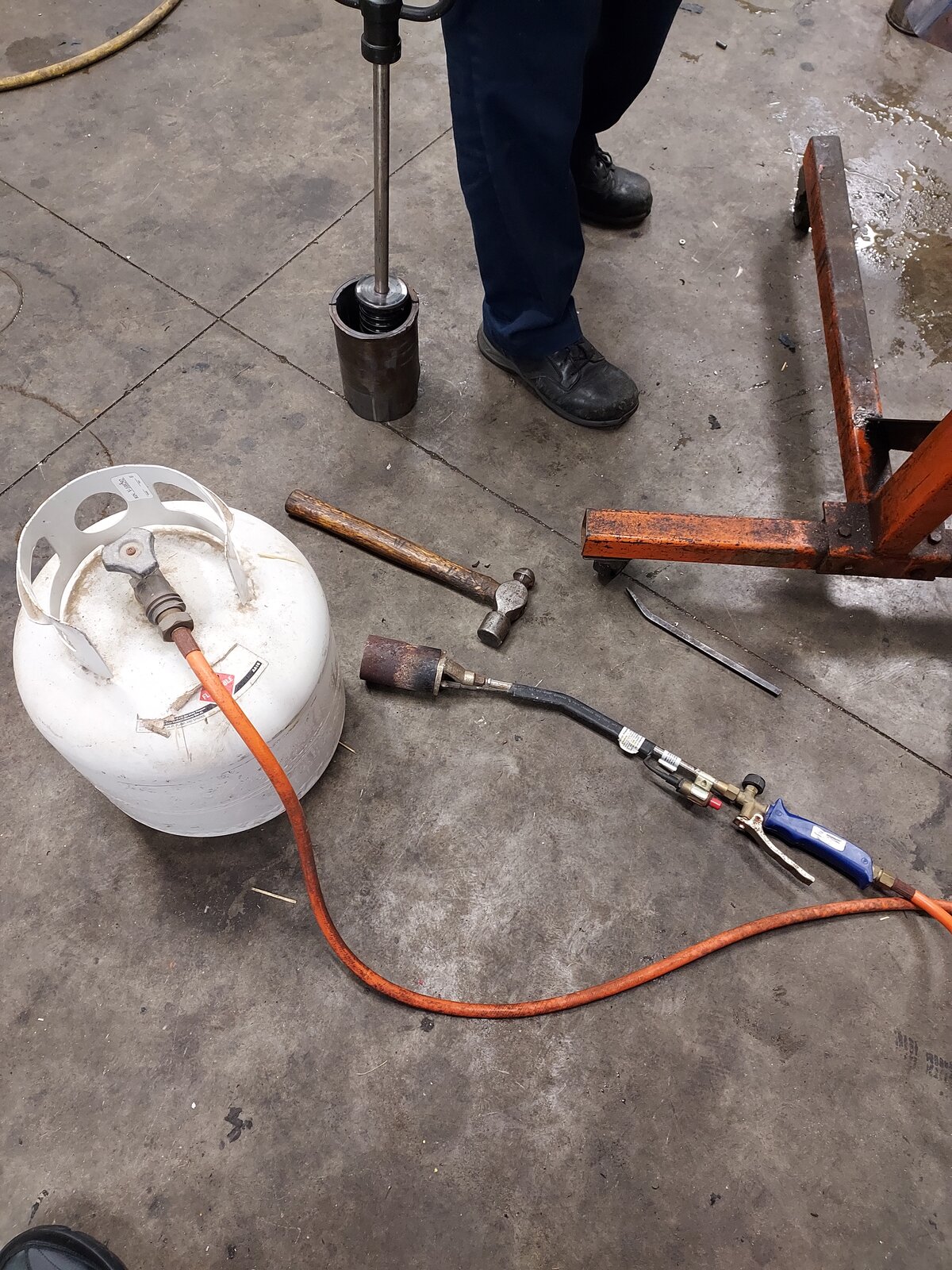

  8. The block put up a good fight but they came out. The bottom of number eight sleeve was flared out some. I used my big propane torch to put alot of heat into the block for expansion. The sleeve puller uses a foot that is specific to the bore. I had to heat and hammer over and over. As the sleeve came out i used a cut off wheel to put two cuts in it. Eventually i got it to split now all the damage can be seen. I think it will be ok. Tomorrow i will break down the head. I feel better tonight. Im now starting to fix it. The pitty party is over.
    At the track its a race to get the heads and oil pan off along with the rod and piston out. If its just a scored sleeve with no damage the sleeve will come out easy as long as the blocks is still hot. A crew man will put sleeves on ice as soon as its determined a sleeve needs to be replaced. That little bit of shrinkage makes a difference. I will get a pic of the sleeve installer along with a better pic of the puller tomorrow. Having these tools is absolutely necessary if you want to run this kind of engine. 20210628_200900.jpg 20210628_200154.jpg 20210628_203841.jpg 20210628_203908.jpg 20210628_203939.jpg

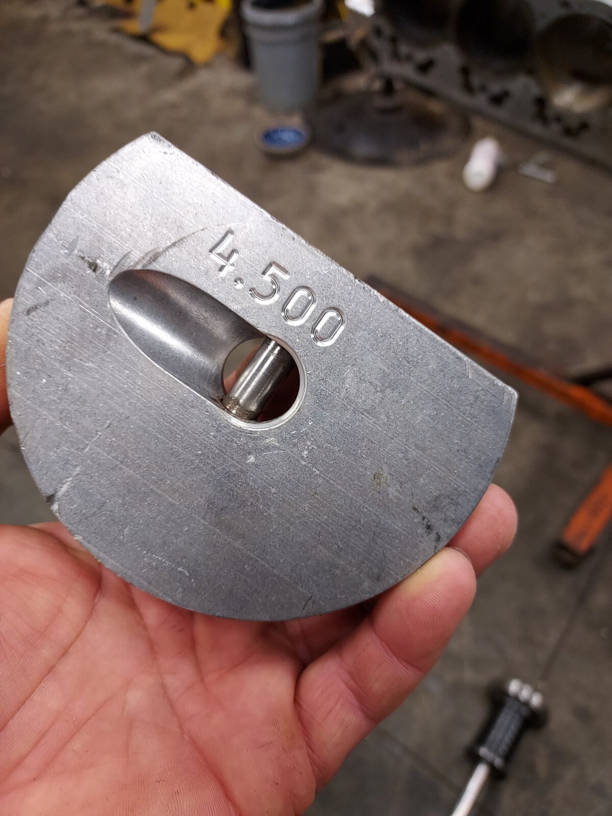

  12. 20210629_045028.jpg The tools of the trade. The sleeve pullers as mentioned before are bore specific. The foot is flipped up to slide down the bore. It catches the bottom of the sleeve then the slide hammer does the rest. The sleeve installer fits all bores. If the block is hot enough the sleeves will almost drop in requiring only a few gentle taps. Because i run water i had the blocked decked flat. Usually the sleeves stick up a few thousandths above the deck. There is no way it will hold water. Its done that way to get a better seal on the sleeves. Installing two new sleeves will require a fresh deck job. It may also need to have the receiver grooves cut deeper. 20210629_044905.jpg 20210629_044908.jpg 20210629_044925.jpg

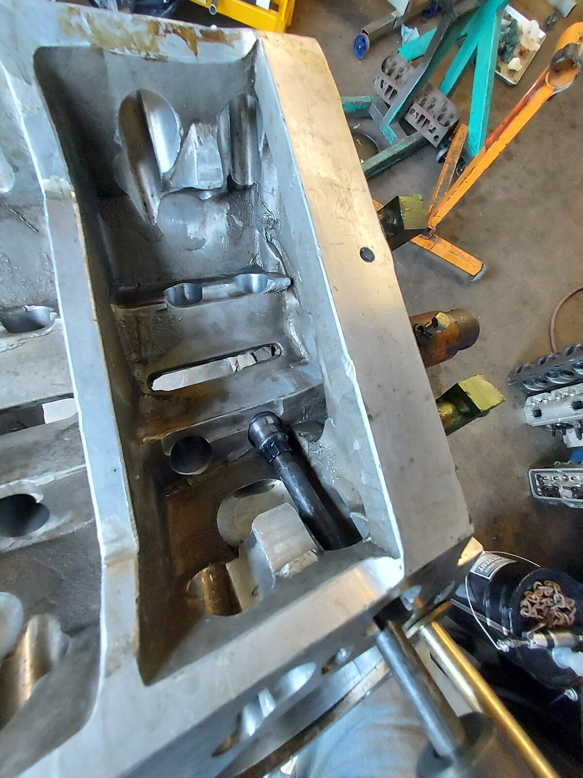

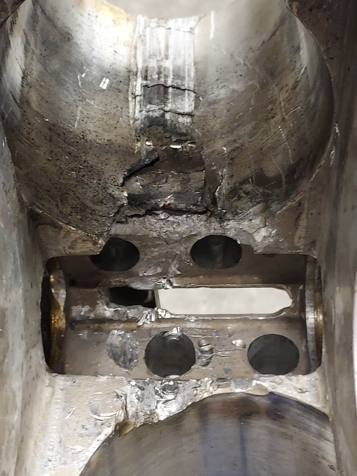

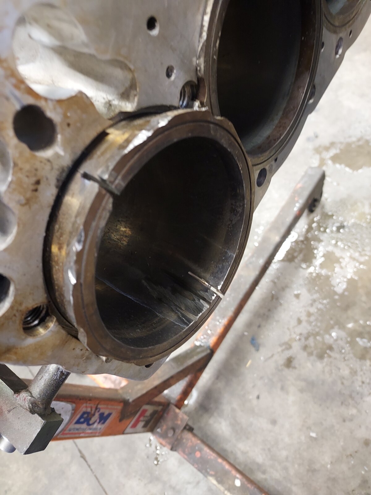

  23. 20210702_103040.jpg 20210702_103021.jpg 20210702_103048.jpg 20210702_103059.jpg 20210702_103111.jpg 20210702_105556.jpg 20210702_112039.jpg 20210702_114548.jpg I ran to iowa to work on the block. First up was getting the lifter bores round again. A slide hammer was used with a ball end of the correct size. It was run through several times down 7 and 8 lifter bores. A reamer was used next followed by a rabbit turd hone. The lifters move freely now.
    The blocks sleeve register took a hit on 8. The broken piece was removed. The areas that were roughed up were ground smooth. Solvent was sprayed and blown off to get rid of the oil. You cant weld dirty aluminum.
    The head was put in the mill and the cracks were removed. While this all looks nasty it can be fixed. After the head and register are welded the register will be cleaned up with a boring bar. The block will be heated and a new sleeve installed. A line bore check will happen and the block will be decked a few thousandths. The head will get the combustion chamber welded and cut. The head will get decked and new o rings cut. These pieces will live to fight another day.

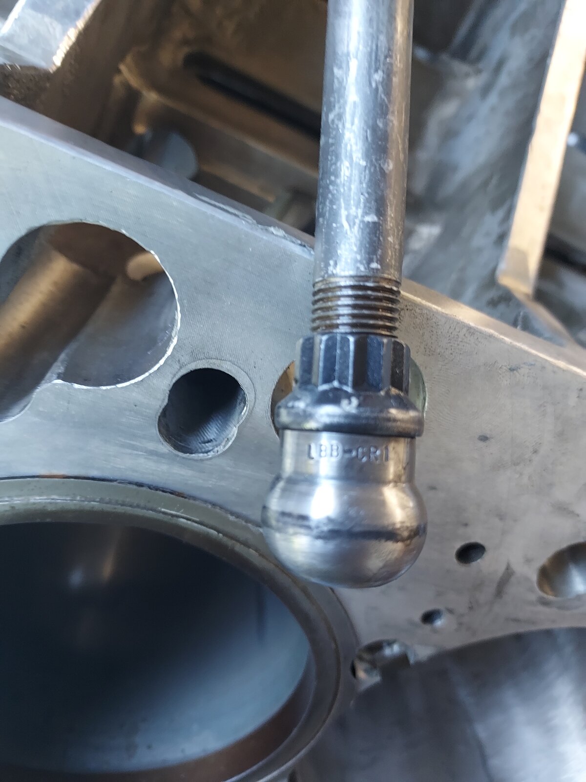

  27. Thats cool. Thanks for the heads up on that. The QA-1 marketing rep was at Back To The 50s. I gave her a bunch of photos to use. With the help of their tech guys mainly Trevor i have gotten my 60 foot times consistently under 1.20 using the QA-1 Mod Shocks. I fired the car on nitro for her. She said oh my i could feel it in my chest thats cool.

    The ball shot thru the aluminum channel seems like a coining operation...I used to do Jet Wing building and coining was part of certain hole finishing/strengthening operations on aluminum structures as well as reaming and broaching in some cases...

  29. I use a tool similar tto the lifter tool on valve guides. It sets the liners before they are finish honed. My ****nal of special tools is rarely used luckily but essential to have.
