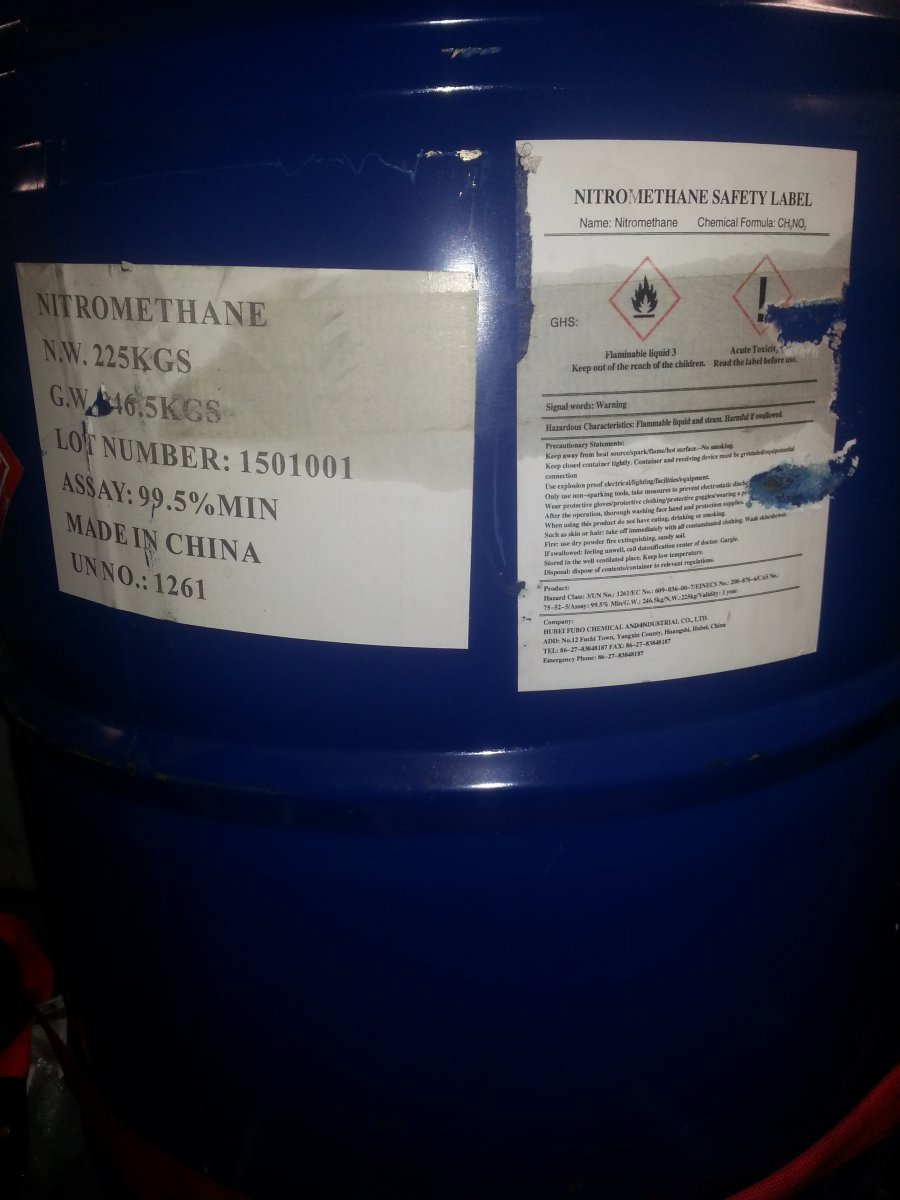

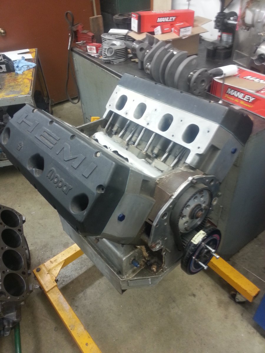

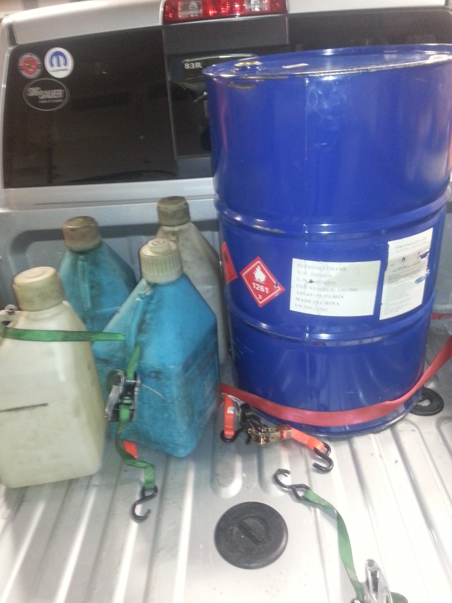

  5. Mission accomplished and then some. look at the label. the nitro available now is made in china. its synthetic. schumacher racing has cornered the market. gone are the days of the good vp non synthetic fuel. the old nitro smelled better and was easier on fittings. nitro is a strange commodity. the prices can vary greatly during a season. 14-20 dollars a gallon are common. in the post 911 world its also harder to get. when i find some thats affordable i buy it because no one has some when you need it. Just walked in the door. I got up yesterday at 4am to start all of this. I have more pics for later today. 20160103_034051.jpg 20160103_034127.jpg

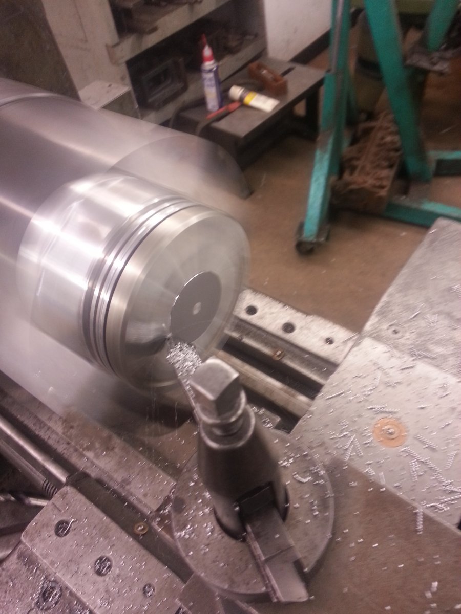

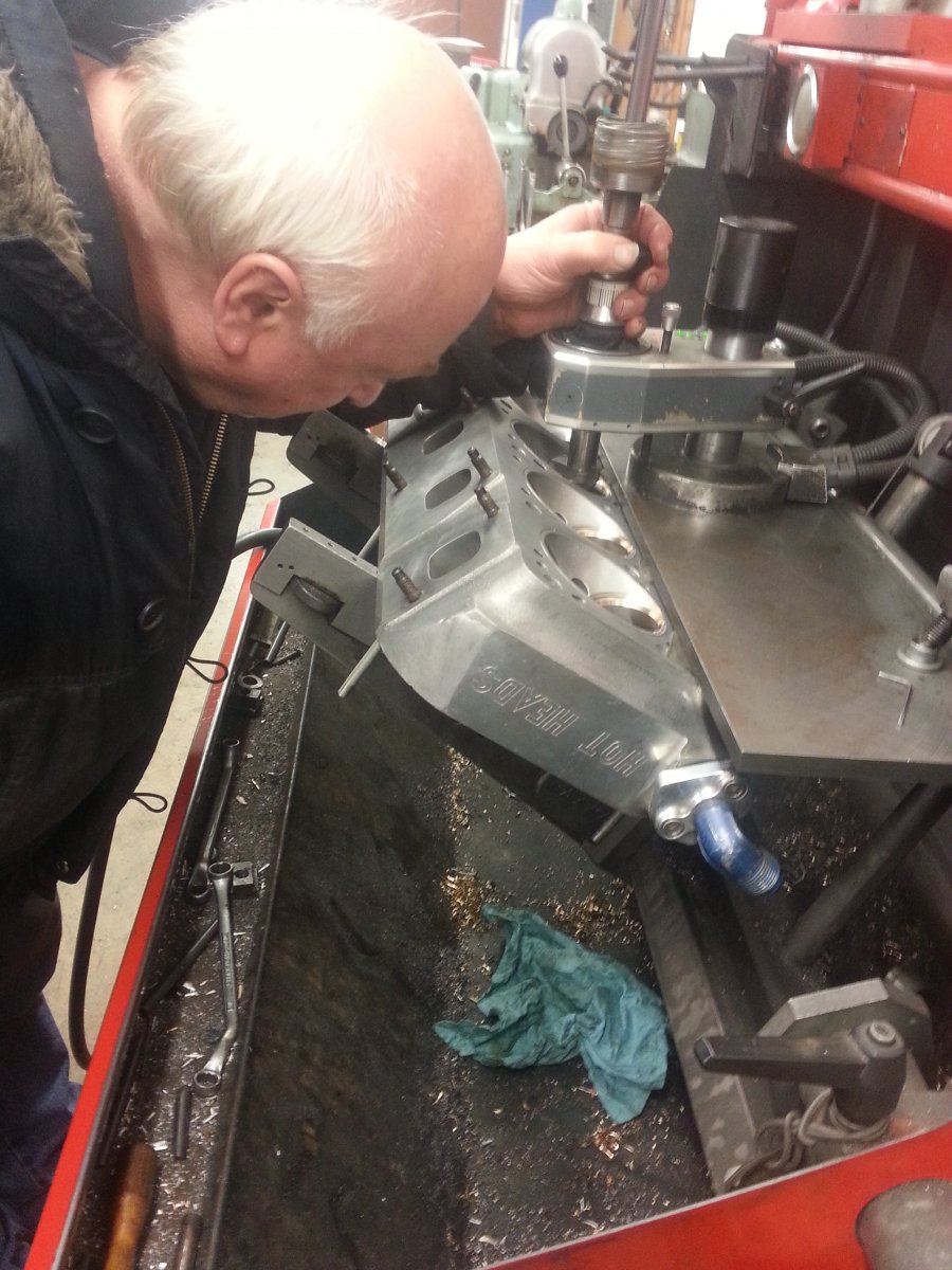

  6. One of the many things to do to get ready for the nitro was to cut the pistons. I needed to drop the compression ratio down some. I first called arias pistons with the job number. They gave me the minimum dome thicknesss. We double checked the thickness to see how much could come off. The pistons were put in a special chuck. The fingers grab in the oil control ring groove. I then took .o25 off. This gave us 4ccs. The thickest part of any piston is above the pin boss. Then the lathe was set up to take a 10 degree cut. This had to be done by hand. My rings are set low on the piston so this worked in our favor. There needs to be .300 from the top of the piston to the ring. This cut gave us 7.5 ccs more. Now the compression ratio is 7.6. the pistons are weighed before and after machining. there is a formula based on how much weight is removed results in how many cc are added. 20160102_150235.jpg 20160102_154118.jpg 20160103_034302.jpg

    Why such a big chamfer on the piston afterwards, is it because of the nitro?
    els likes this.
  8. The second cut drops the compression even more. only so much can be removed from the center of the piston before it becomes too thin. We are making these modification so i dont have so spend another grand on new pistons. Controlling cylinder pressure and detonation are key.

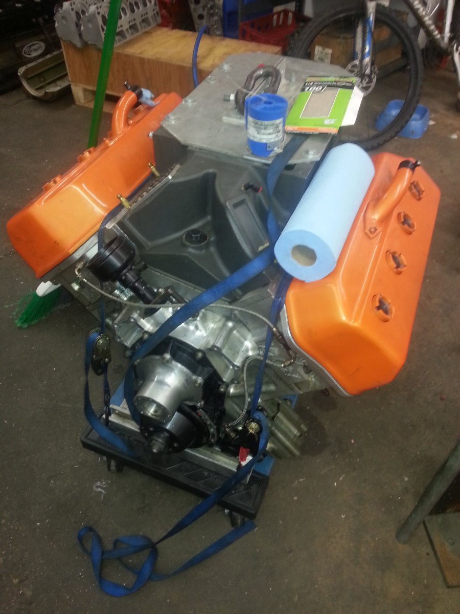

  11. 20160103_164349.jpg Now that i have gotten some sleep and got the nitro unloaded its time to introduce one of the key guys in my group. Roger lechtenburg from cedar falls iowa. There are people you run across in life that after just a few minutes of conversation you think to yourself this guy is scary smart. This is a guy who if you are both looking at the same thing sees that thing from a totally different view. He is a fierce compe***or a gifted machinest and a incredible inovator. He has won world championships in several forms of compe***ion. Both as a driver and engine builder. He invented the b-1 heads then sold the idea to koffel. those heads won three pro stock ***les alone. While i was there this weekend he was making a tractor puller head from scratch. The head weighs over 150 lbs. he has recently invented a four valve per cylinder harley head again from scratch. He has been around the faster cl***es of racing for years. He recently helped win the world championship by sevicing the four blown hemis in a customers pulling truck. He also backed up his win at the fuel altereds world championship this year. That makes two straight world ***les as a driver of a fuel altered. When i decided to go with a dual fuel system roger was the guy that got the first call to go over my plans. roger thinks its a cool idea and thinks it will work. we came up with a plan we think will work. Here are some photos of roger and a few things laying around the shop. Hemis are everywhere. There was a alan johnson pro stock hemi that just came in. A few blown hemis from a tractor puller were just laying around. there are hemi heads everywhere This is a hard core shop. this is the dragster i have crewed on for years. I just wish he lived closer. he is five hours away from me. i hold him in such high regard i feel its worth it to drive that distance so we can get the engine ready to go. we have spent countless hours working on hemis together over the years. there are a lot of possers in this hobby. i can ***ure you roger is not one of them. this guy is the real deal. TTACH=full]3099270[/ATTACH] 20160103_164410.jpg 20160102_212116.jpg 20160102_103540.jpg 20160102_103554.jpg 20160102_212318.jpg 20160102_200530.jpg

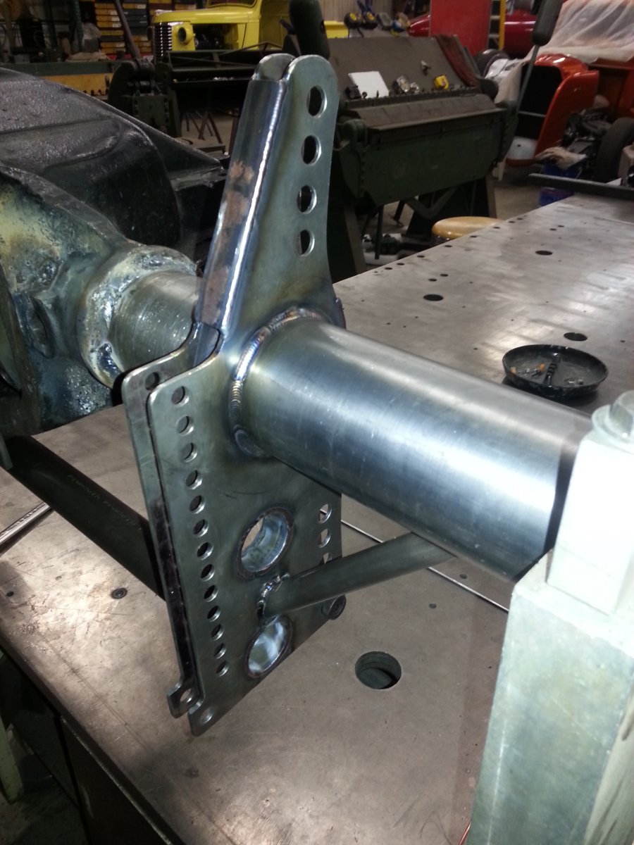

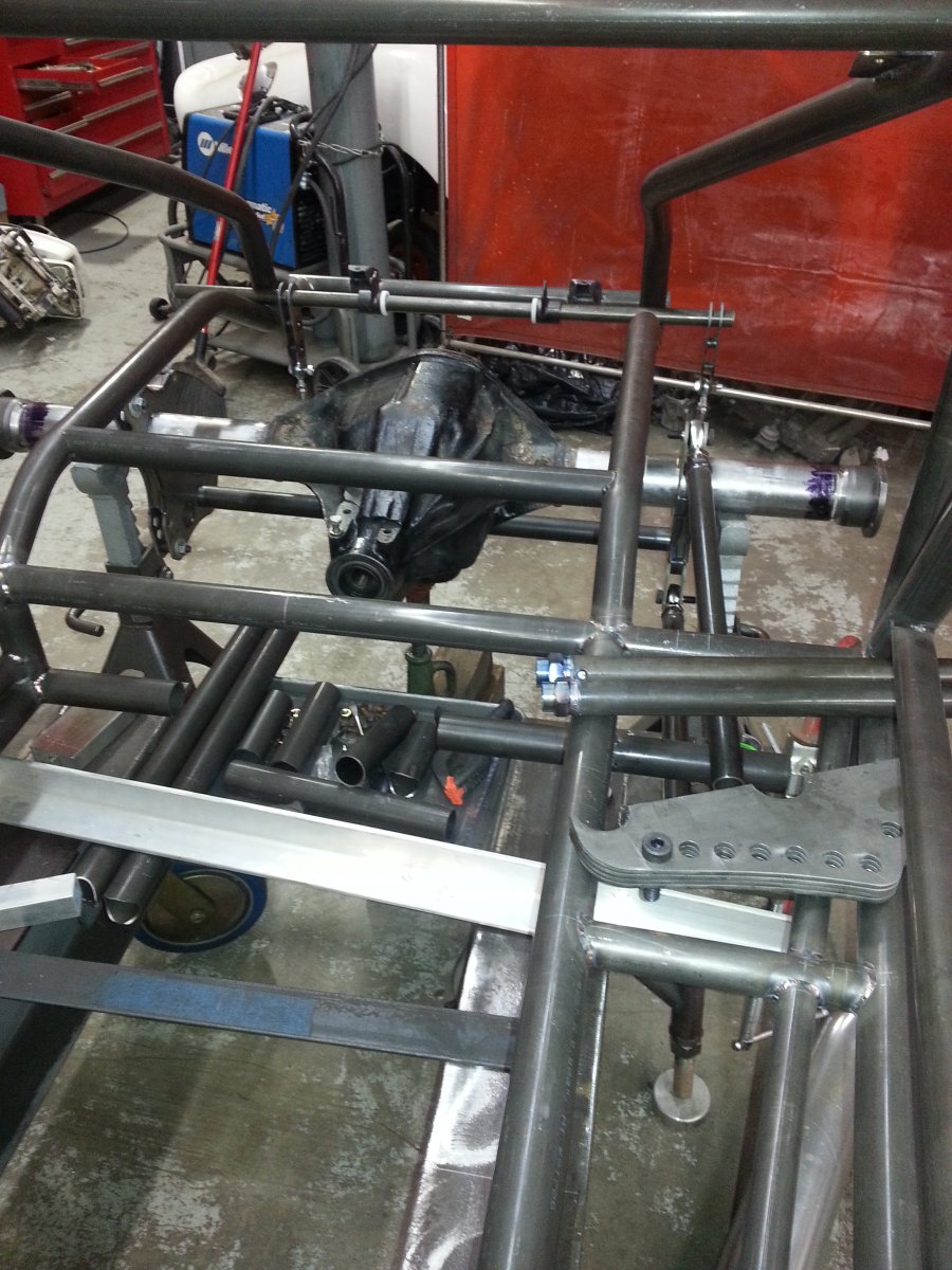

  18. 20160105_160505.jpg 20160105_160545.jpg 20160105_160514.jpg The dana housing is all welded now with the exeption of the housing ends. The tubes were stick welded with a high nickle rod. The special rod is needed to weld the cast iron to the steel tubes. The combination shock/ four link brackets look cleaner and are stronger than seperate brackets. The brackets also have wheelie bar holes. Im upgrading the side gears to accept 35 spline axles. The disc brakes were dropped off so the proper bearing offset can be determined. The pic of the rearend may look simple but there is alot going on. The rear and four link should be in next week. The anti rollbar and wishbone track locator need to be made. the rear end will be set up were the bars can be moved on the four link without having to shorten them or lengthen them. this is a huge thing as it makes adjustment easier if you don't have to redo everything every time a instant center is changed. there is a lot of engineering in all of this. the tubing bracing the brackets also serve as tie downs. this will be top shelf when its done.

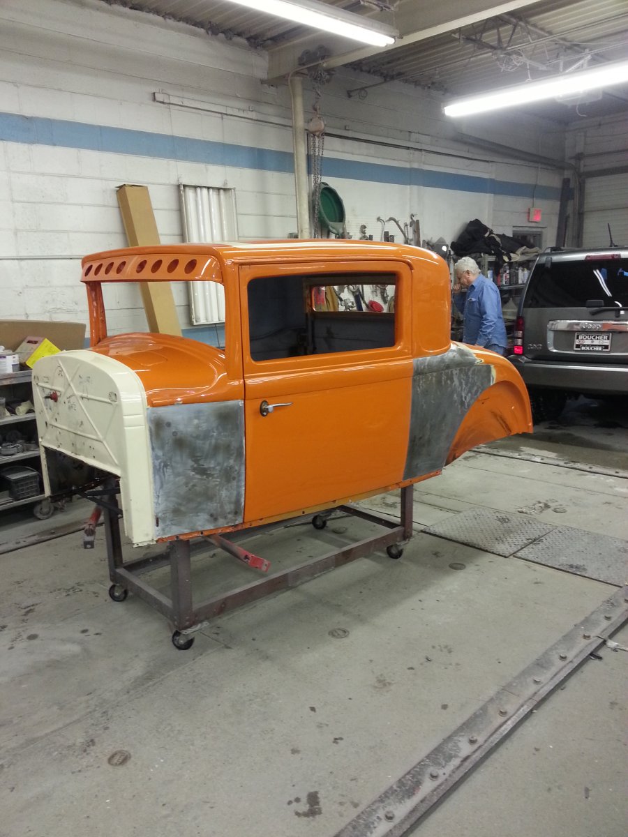

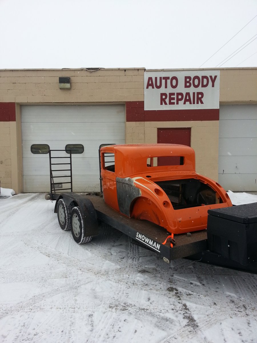

  19. I finally was able to get the body dropped off at the shop. Custom car care in sturtevant wi is probable the last place most car guys would look for a body shop to take their pride and joy. Lots of guys like to have a big name ***ociated with their build. Tv names or legends like chip fusse and boyd coddington or barris. But here in a town thats just a spot on the map has a true heavy hitter. **** woton is his name. **** has done body work all his life. He was the paint and body shop manager while working at beaver restorations in kenosha wi. **** was jack klamms boss. The shops specialties were duesinburgs; cords; lasalles; chryslers and other priceless cl***ics. it takes huge coin to do one of these cars. Think jay lenno. The work has to be perfect for this crowd. The top prize for these players is winning the pebble beach show. **** won it five times. that would be like winning the super bowl or world series five times for a sports player. thats hard to do when you think about the unlimited money funding those kinds of cars. All done without a reality tv show. His skills are amazing. **** painted the car the first time around. It was a easy choice to return the coupe to his shop. 20160111_154318.jpg 20160111_160253.jpg

    You sure do know your share of the remaining CRAFTSMEN.

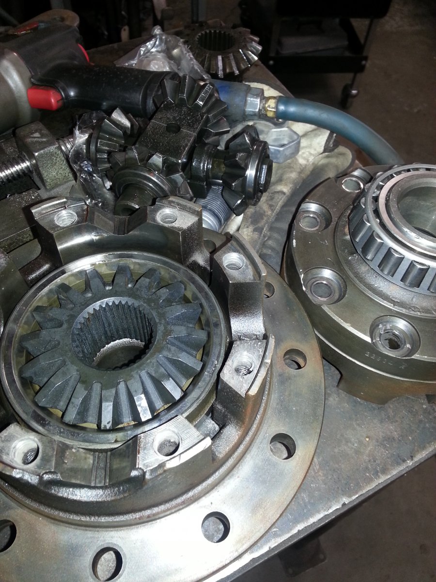

  27. The hamb goes down for a few days and now i have a lot of updating to do. Theres alot going on with this installment. First up is the ch***is. The housing ends are tacked on the dana. The trac lock now has the 35 spline side gears. The majority of the four link is made. All the aurora heims came in. The ch***is needs to come off the jig to get the front brackets on. The axles and gears are ordered. The pieces for the wish bone and anti roll bar are all cut and ready to install. While jim and john have been doing their thing i got the heads ***embled. The pic of the front bracket has me holding the bracket upside down to show how it will be mounted eventually. 20160115_160058.jpg 20160115_160114.jpg 20160115_160157.jpg 20160115_163840.jpg 20160115_161906.jpg
    wingnutz likes this.
  28. 20160115_160129.jpg The hamb goes down for a few days and now i have a lot of updating to do. Theres alot going on with this installment. First up is the ch***is. The housing ends are tacked on the dana. The trac lock now has the 35 spline side gears. The majority of the four link is made. All the aurora heims came in. The ch***is needs to come off the jig to get the front brackets on. The axles and gears are ordered. The pieces for the wish bone and anti roll bar are all cut and ready to install. While jim and john have been doing their thing i got the heads ***embled.

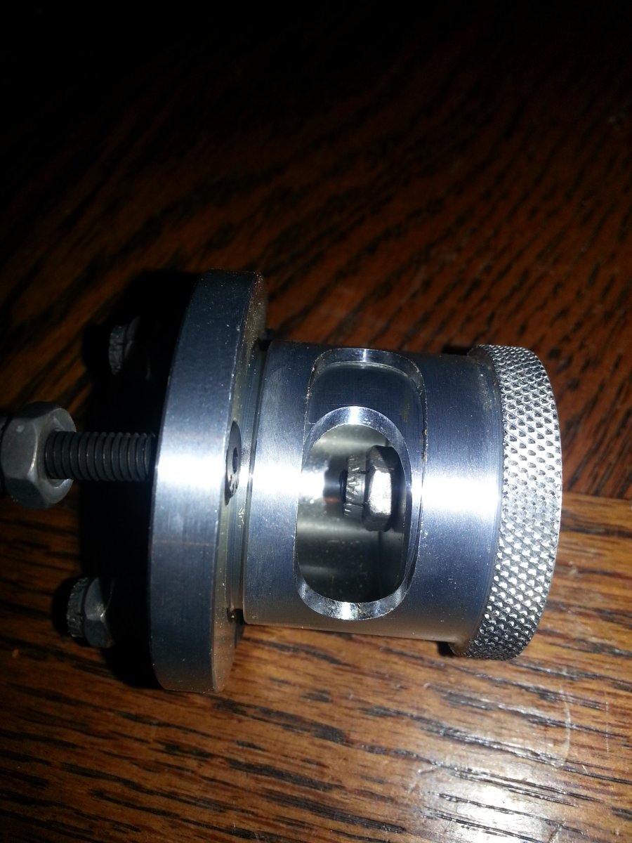

  29. Running efi on gas i have my ****erflies set at .002 this makes for a 900 rpm idle. I use a idle air control valve wired to the fast efi box. This gives a perfect idle without the rup rup typical of a blown car at idle. The valve adjusts electronically letting in more or less air. When i switch over to nitro i need to have more rpm. It would be simple to just give the idle screw a few turns to get the desired effect. The problem is when i go back to the gas i not only would have to reverse the idle screw i would have to redo the settings in the computer. The throttle position switch would need to be reconfigured everytime the screw was moved. The tps switch is a touchy thing. So thats were the mechanical idle valve courtesy of roger stanke comes in. Its plumbed into the four port hilborn below the ****erflies. The valve can be turned to allow more air into the engine bringing up the idle rpm. The tps switch is not effected because i no longer need to turn the idle screw. The valve becomes a adjustable va***n leak. It can be turned by the knob or with a arm attatched to a cable from inside the car. Most blown nitro cars use this valve or something of this sort. They are also used in injected applications. This valve will save me alot of time. Stanke motorsports offers parts and specialty tools for the hemi racers. They have parts for all three generations of hemis. 20160114_203414.jpg 20160114_203432.jpg 20160114_203356.jpg View attachment 3108572

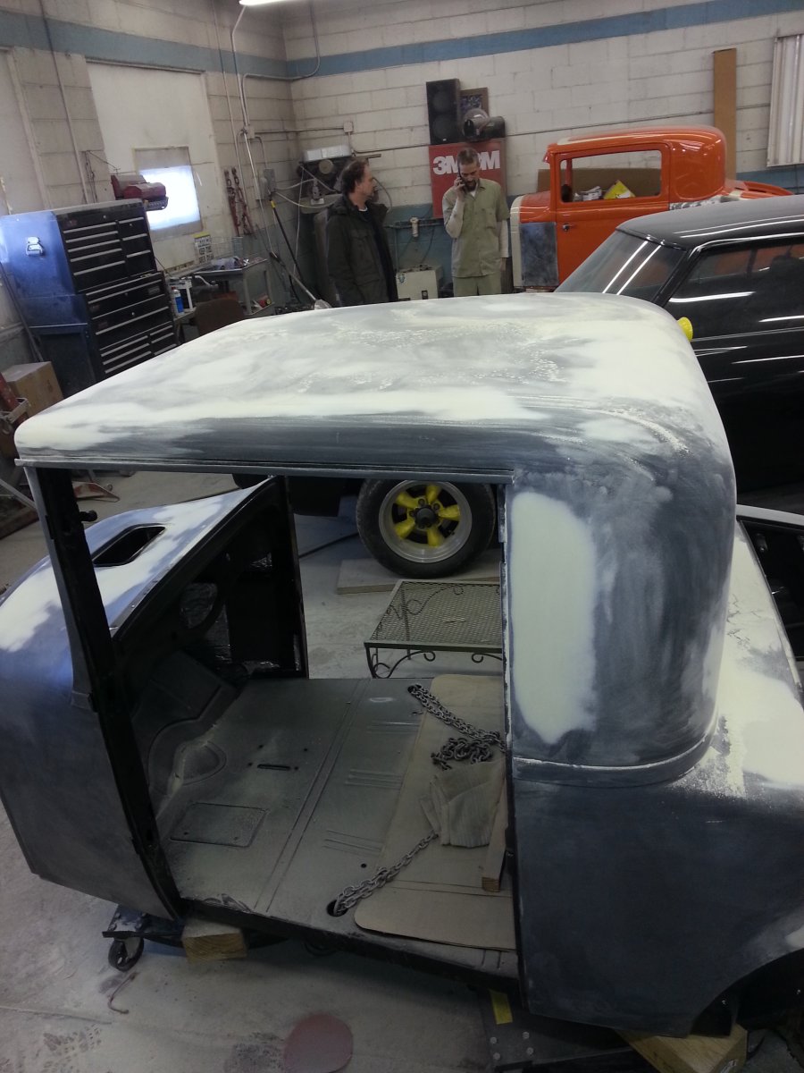

  30. 20160112_094045.jpg 20160112_094242.jpg 20160112_094336.jpg 20160112_094454.jpg When i was dropping off the body **** was working on a 30 dodge coupe. Mopar guys know how rare these bodies are. Its very unusual to find two at a show let alone two in the same body shop. There is a big differance in the roof and size of the doors between a 30 dodge and a 31 chrysler. The differance might go unnoticed without them being almost side by side. I also took a few pics of ****s award winning restorations. One is a 34 packard. one is a 34 duesenberg. one is a duel cowl phaeton. big beautiful cl***ics. .
