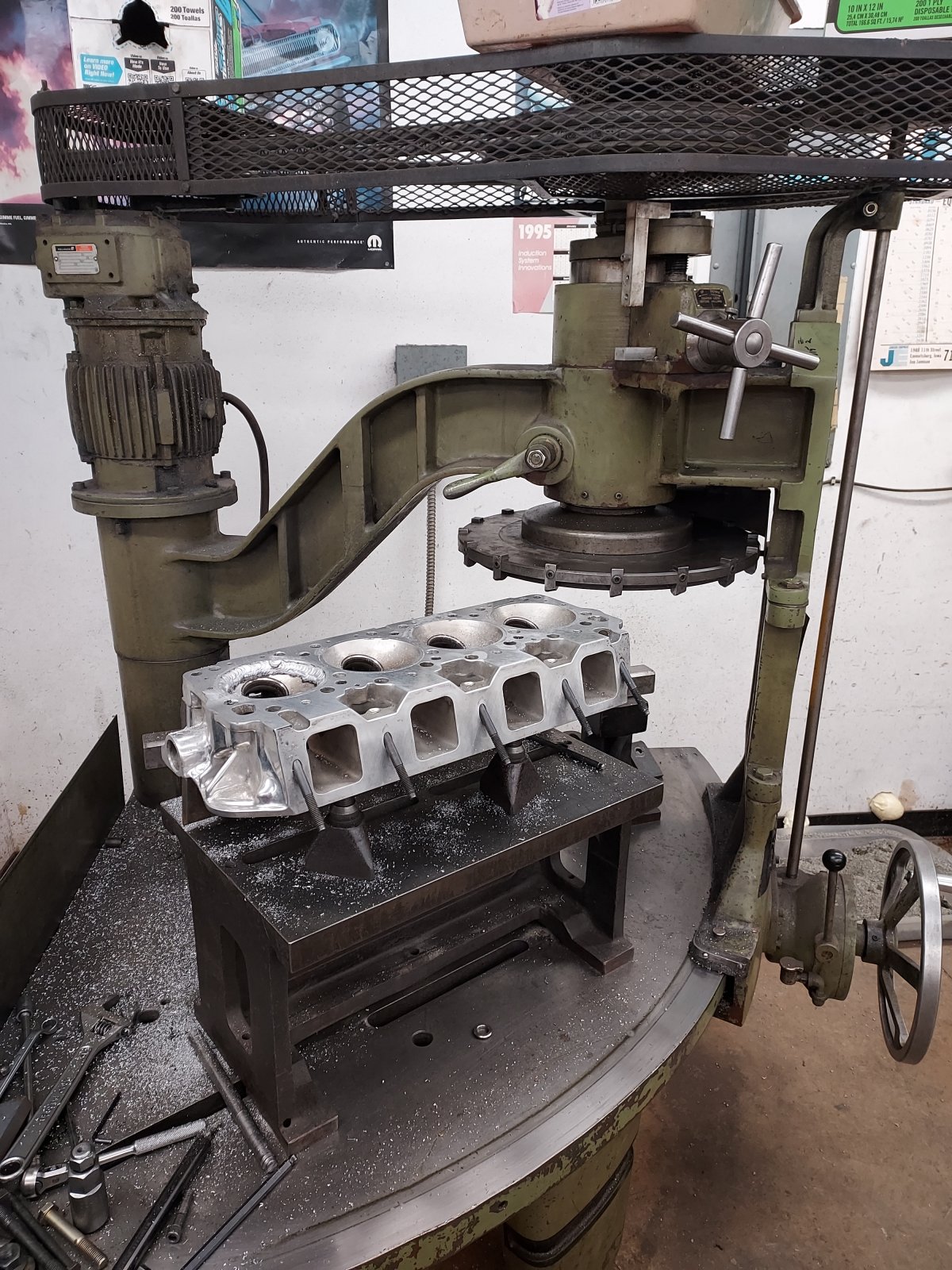

    What do you use to machine the welds? I mean the tooling. I ***ume you do it on a Mill, is it a CNC program or ?
    Damned interesting!
  4. 20211217_155433.jpg Its done on a surfacer. A big wheel with cutters spins cutting off material. Nothing special is used on the welds. This machine will cut it.

  6. The cutting wheel has a hole in it. A indicator is dropped through the hole at all four corners 20211217_162413.jpg . The supporting blocks under the head are screwed up or down. This is how the head is set parallel to the wheel.

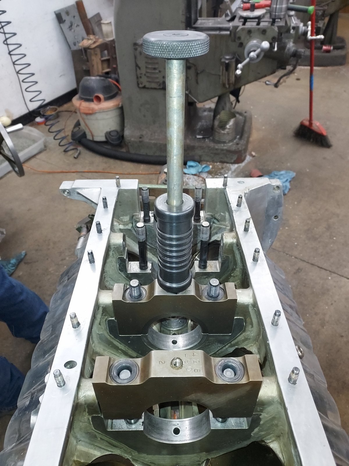

  14. The chambers get cut with special tools. Nothing is cnc. The depth of the cutter is set based on a undamaged combustion chamber. A stop is set then the table is moved to the damaged chamber. Some hand blending is usually required. New seats and o ring grooves along with a light touch up on all the other seats and its done.
    The sleeve bores and registers were cut tonight. This is a very time consuming job. It has to be perfect. There are no second chances. 20211217_200322.jpg 20211217_210809.jpg First thing in the morning the sleeve bores will be honed to size. Its only 18 degrees outside so i put the sleeves on the back deck to cool and shrink overnight. The block will be heated with the big propane torch so the sleeves drive in easier. When the block temp normalizes it will be decked. Then cam bearings go in. I have the cam with me to check the fit.
    When i get home the block will go to my local speed shop to check the align bore and hone the new sleeves to size. The sleeves are so hard regular stones will wear out. Diamond stones are needed for this job. Last thing is to re install the deck pins.

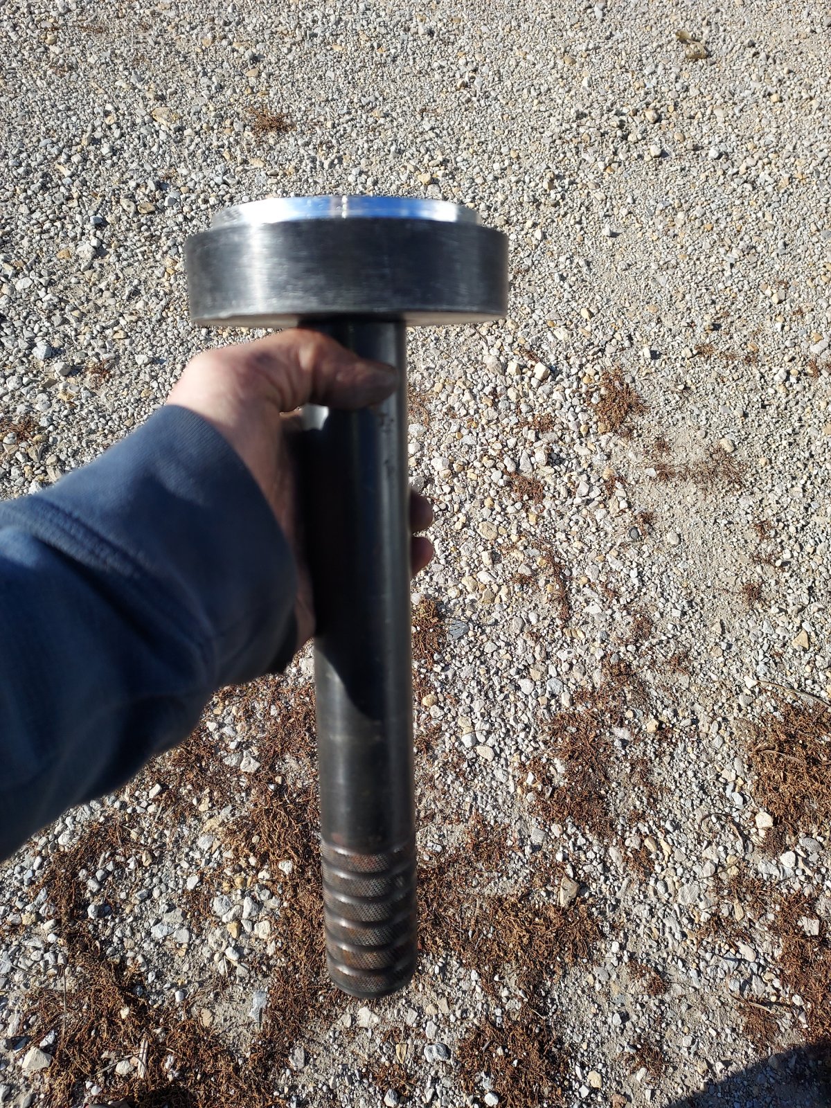

  20. 20211218_104108.jpg A ridgid hone cleaned up the sleeve bore. A torch heated the block. Wd-40 on the sleeve helps it go in. After lining up the index marks it was driven in. It was then pushed outside to cool. When it returned to a normal temp the sleeves were hit again. If its too hot the other sleeves can move up. Now they are set. Its time to surface the block. Here a few pics of the tools of the trade. 20211218_092433.jpg 20211218_093734.jpg 20211218_103917.jpg 20211218_104034.jpg 20211218_104043.jpg

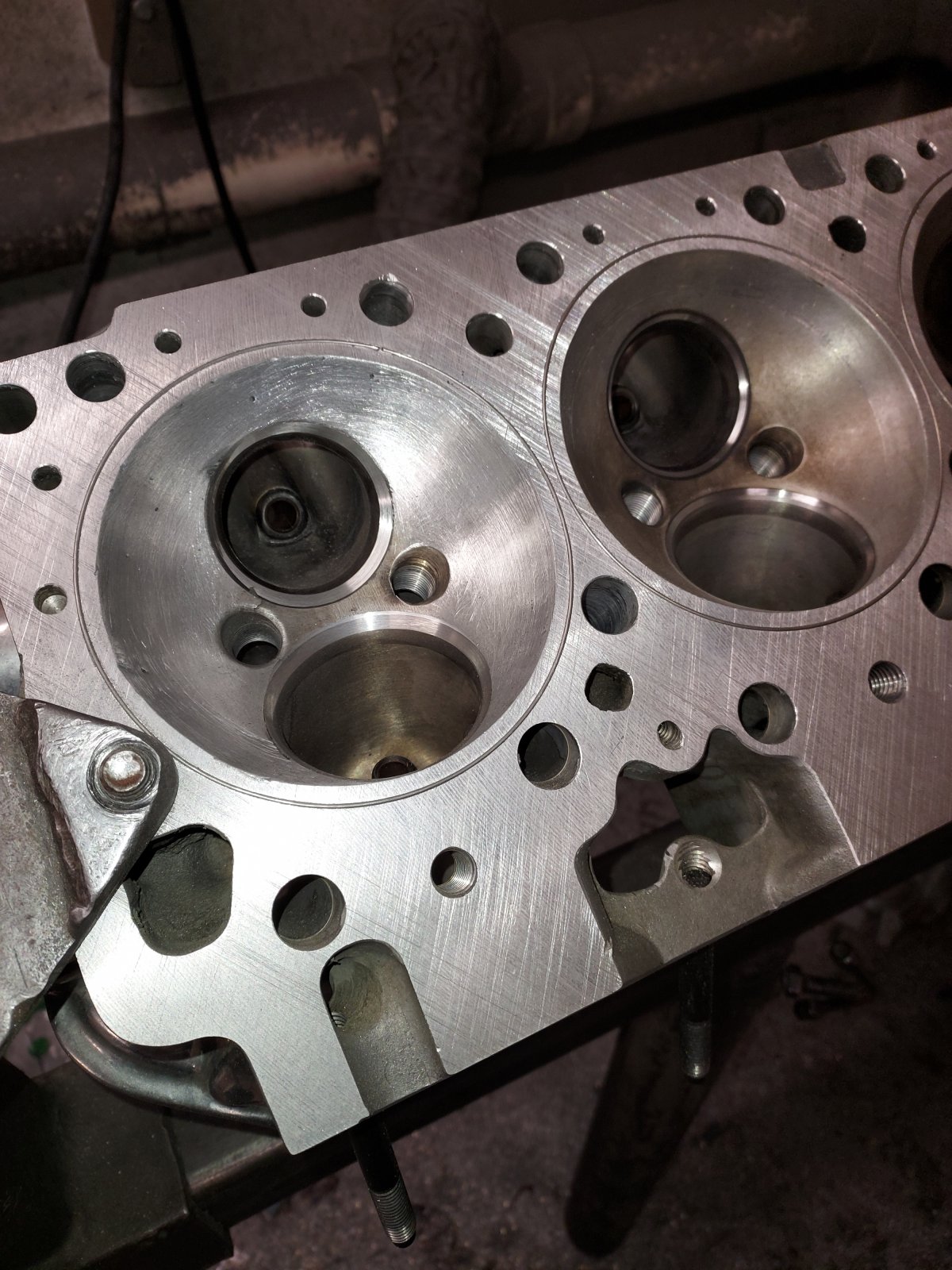

  28. Heres that nasty combustion chamber now. New o ring receiver grooves have been cut. Its a very delicate procedure to get them in correctly.
    The seats in the repaired chamber need to be replaced. They wont clean up unless the valve gets sunk. Overall lookin good. 20211218_210906.jpg
