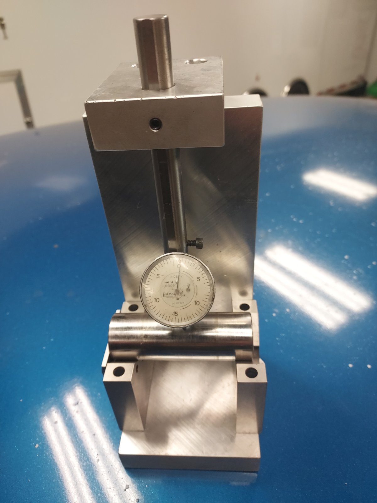

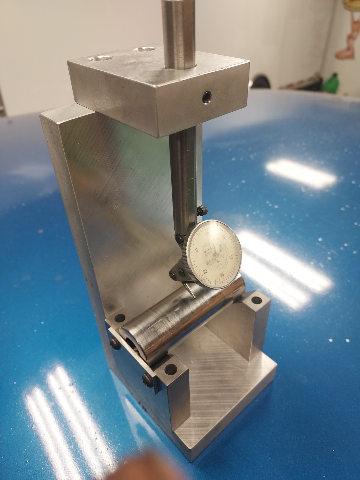

  6. My friend and neighbor Jim Barton stopped by a few weeks ago. I mentioned i needed a wrist pin checker. He is a tool and die maker so he said let me see what i can come up with. Today he stopped by with this. Its so nice. He said Merry Christmas. All the flat surfaces were ground. Its a piece of jewelry. The pics dont do it justice. 20211222_175914.jpg 20211222_175907.jpg

    Wow, you've got good friends there! So tired of flimsy tools. That ought to do it.

  9. And its bent .003 i have new pistons and pins on order.

    As a retired machinist I can say unequivocally that this took much more than a couple hours of work.

  11. He certainly went above and beyond what needed to be done. He is very proud of what he made and im very proud to own it. Jim is 76 and still works part time at a machine shop. He takes pride in everything he does. This tool will last me a life time.

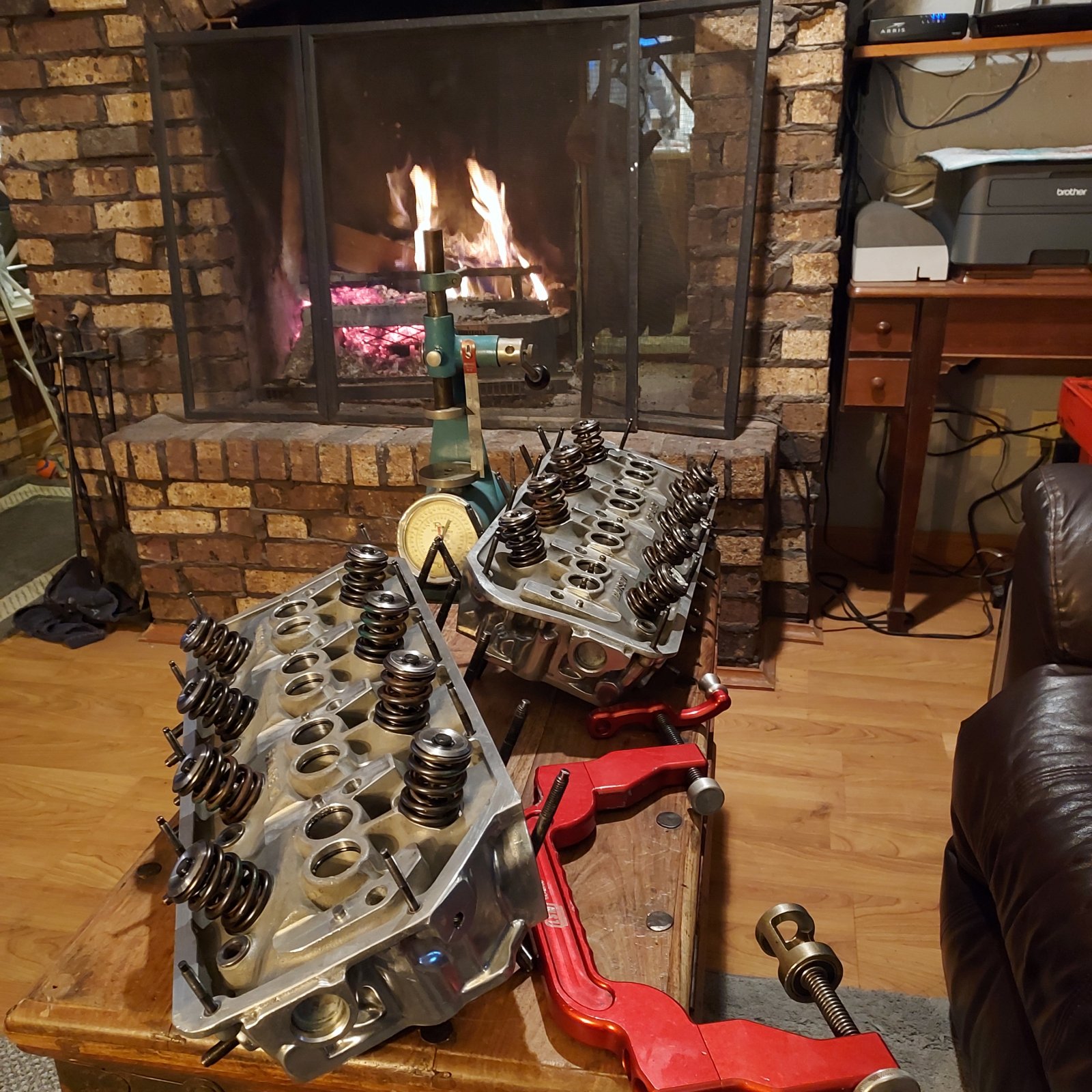

  28. 20220115_170644.jpg Getting some things done on a cold day. My buddie Roger Lechtenburg dropped off the freshly machined heads Thursday. I put them together by the fireplace today.
    Over the off season i upgraded the bellhousing to a Browell. Its been upgraded with a right sided starter pocket and a relief to get at the converter bolts. It has a fresh recert and is ready to go. The 360 degree protection is way better than the open bottom Bruno unit.
    With the huge bolt together aluminum converter the more square shaped browell fits better. The Bruno tapers alot in the back creating clearance issues. Stay warm everyone. 20220115_165421.jpg 20220115_170516.jpg
