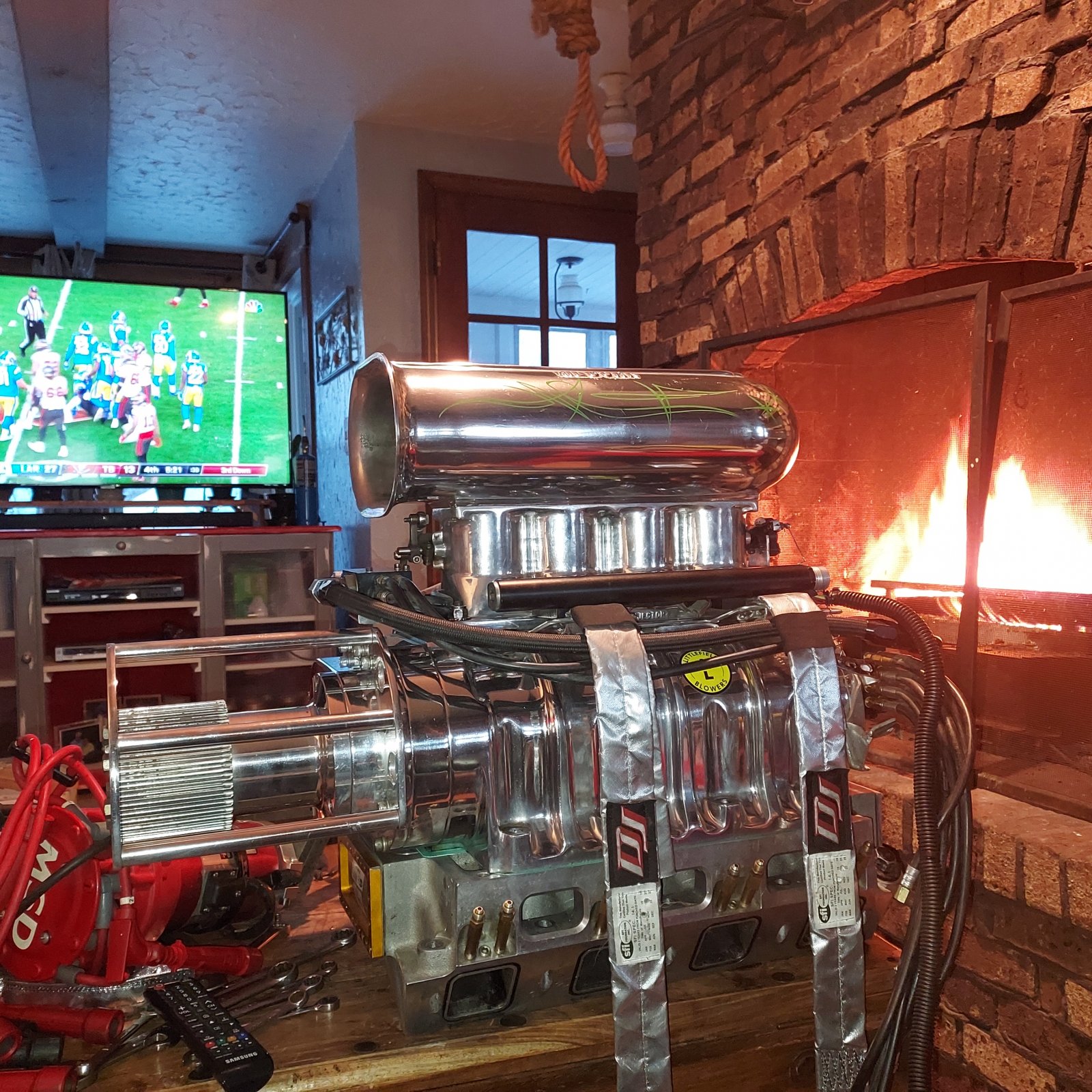

  10. A little football and a fire plus a whole lot of polishing in the family room. 20220123_165729.jpg The entire induction came apart for inspection and cleaning. New o rings will go into the manifold they a old and flat. Its a good way to spend a cold wisconsin afternoon. I like shiny things
    mad mikey, enloe, Stogy and 9 others like this.

    ^^^^ Nice, but why not a pic of the SF v GB game;)
    Beautiful room and I’ll ***ume house you have.
  12. The pack played Saturday.
    Moving parts into the house helps with the boredom that comes with polishing parts. My wife doesn't care. She is cool.

  16. as long as the parts don't smell like brake cleaner or leak oil she is good with doing things in the house. I have most of the engine in a extra room. I pull out parts one at a time and clean them up. its a major operation going through all of this stuff. there is so much polished aluminum and magnesium that needs attention. its all worth it when its all clean and back in the car. it kind of reminds me of the hurst cars or ivos cars. cars that could be just show cars but also race.

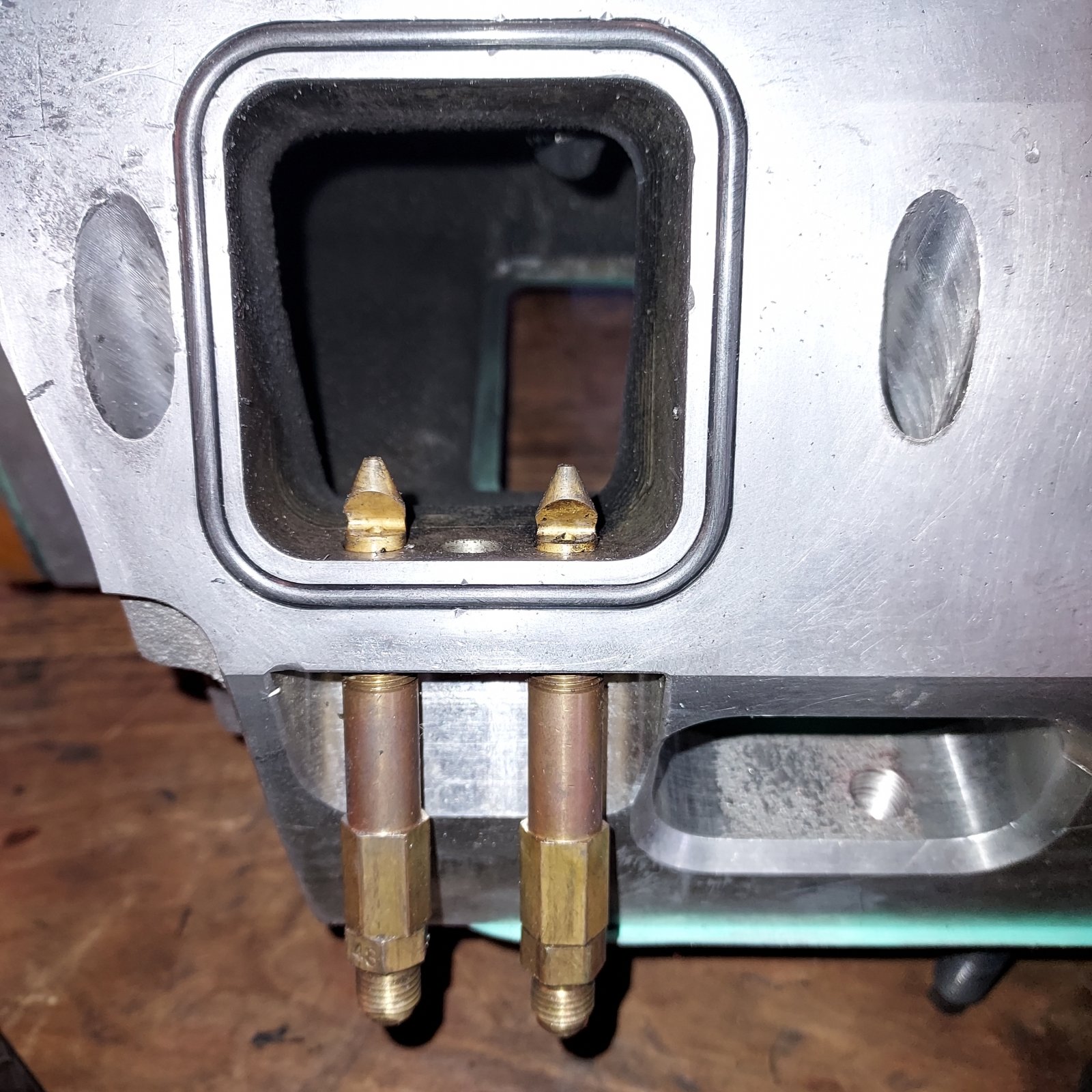

  17. Todays nitro fun manifold maintenance. A inspection and measurement of the burst panel for stretching was followed by a o-ring change. When the o-rings feel and look flat and are no longer above the deck its time for replacement. The blower studs were checked out. They are aluminum and are somewhat fragile. If the engine should backfire the studs are designed to break letting the pressure escape saving the manifold. The nozzles are inspected for obstructions. The o-ring and gasket on the top of the manifold will be replaced. 20220125_161257.jpg 20220125_161309.jpg 20220125_162444.jpg 20220125_162625.jpg
