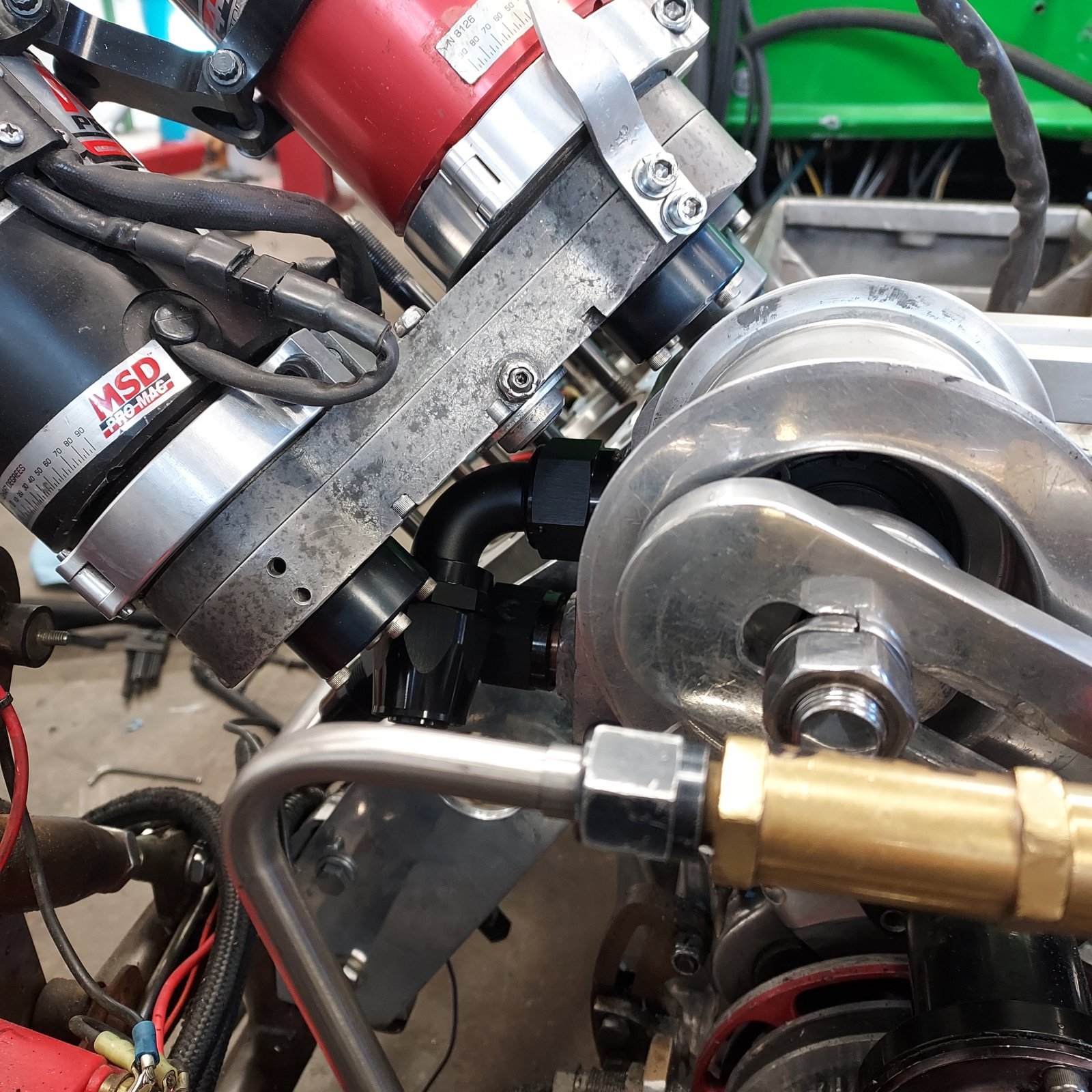

  1. It may not look like much but this is two full days of work. The new pieces went together just fine until i tried to put the mag in. Everything had to come apart. The blocks that the fittings screwed into were removed. The fittings were welded on without the blocks. This gave me a half inch. The p***enger side of the ideler bracket was re shaped. The fittings on that side were re positioned. It was alot of fitting then machining and repeating it over and over. Once a decision to cut something is made its very hard to go back and start over like nothing happened. The five pounds of **** now fits in a one pound bag. If it was easy everyone would be doing it. 20220327_184858.jpg 20220327_175408.jpg 20220327_185031.jpg 20220327_184907.jpg 20220327_181034.jpg 20220327_184851.jpg

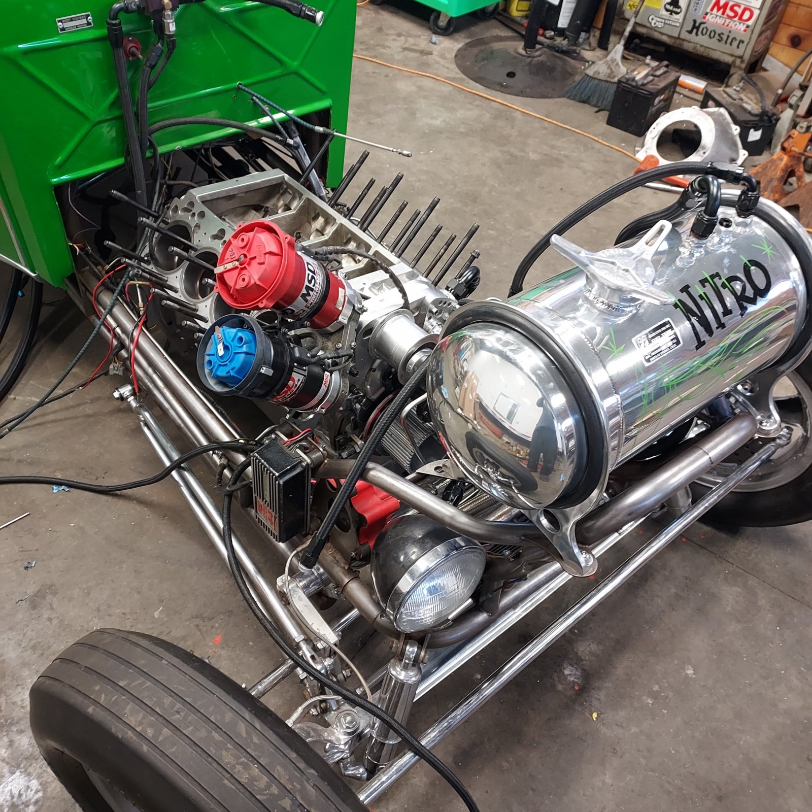

  4. I spent the whole weekend hooking things up. The radiator is in with new 16 lines. There were alot of possible routing options for the coolant lines. With a large selection of different angled fittings getting the right fit was possible. Now im just waiting on rods. Everything else is done. I ordered them last October. 20220403_182740.jpg 20220403_182815.jpg

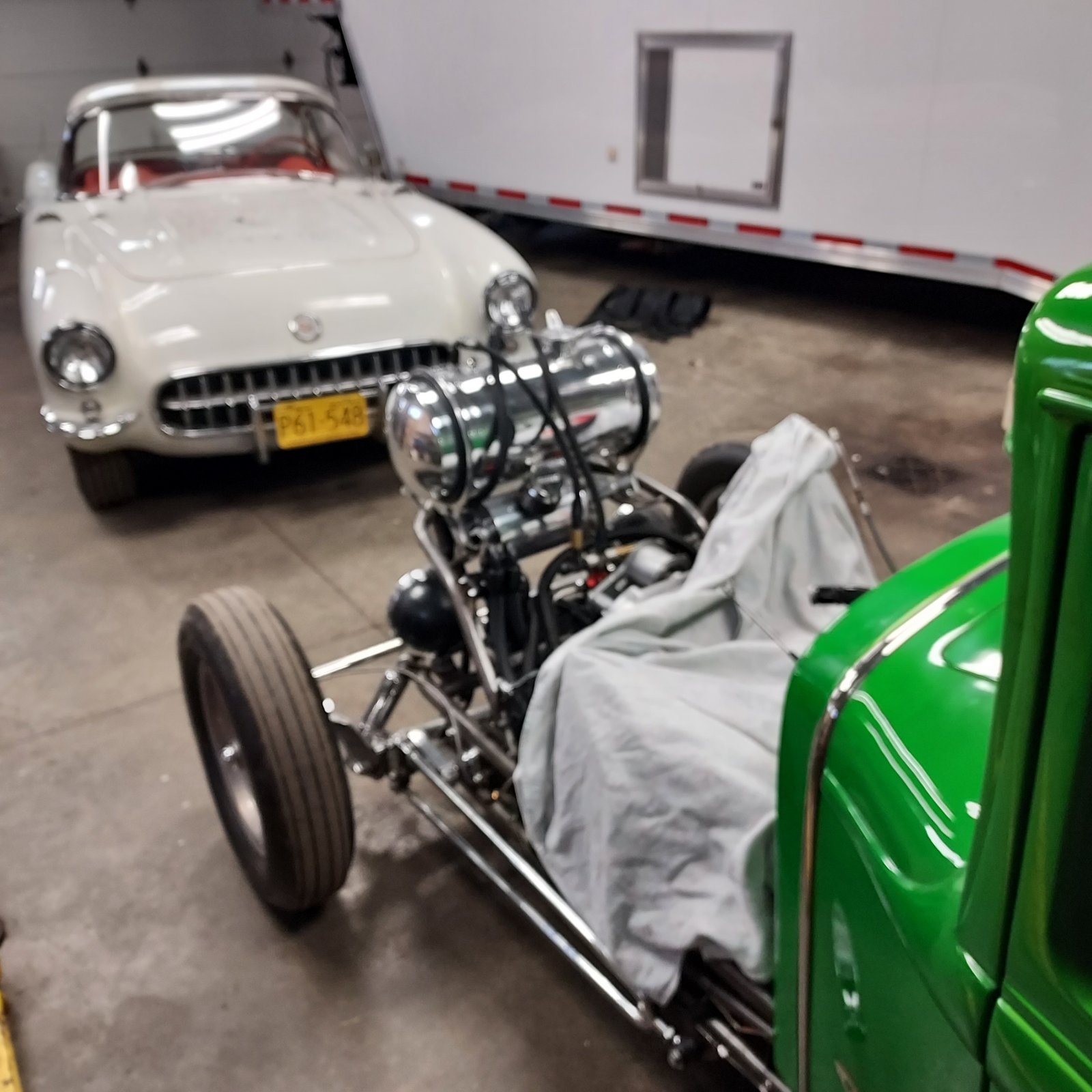

  5. I have done all that i can do until the rods show up. Im moving on to the barn find 57 vette; the Chevelle floor and getting the trailer ready for this season. 20220410_185602.jpg

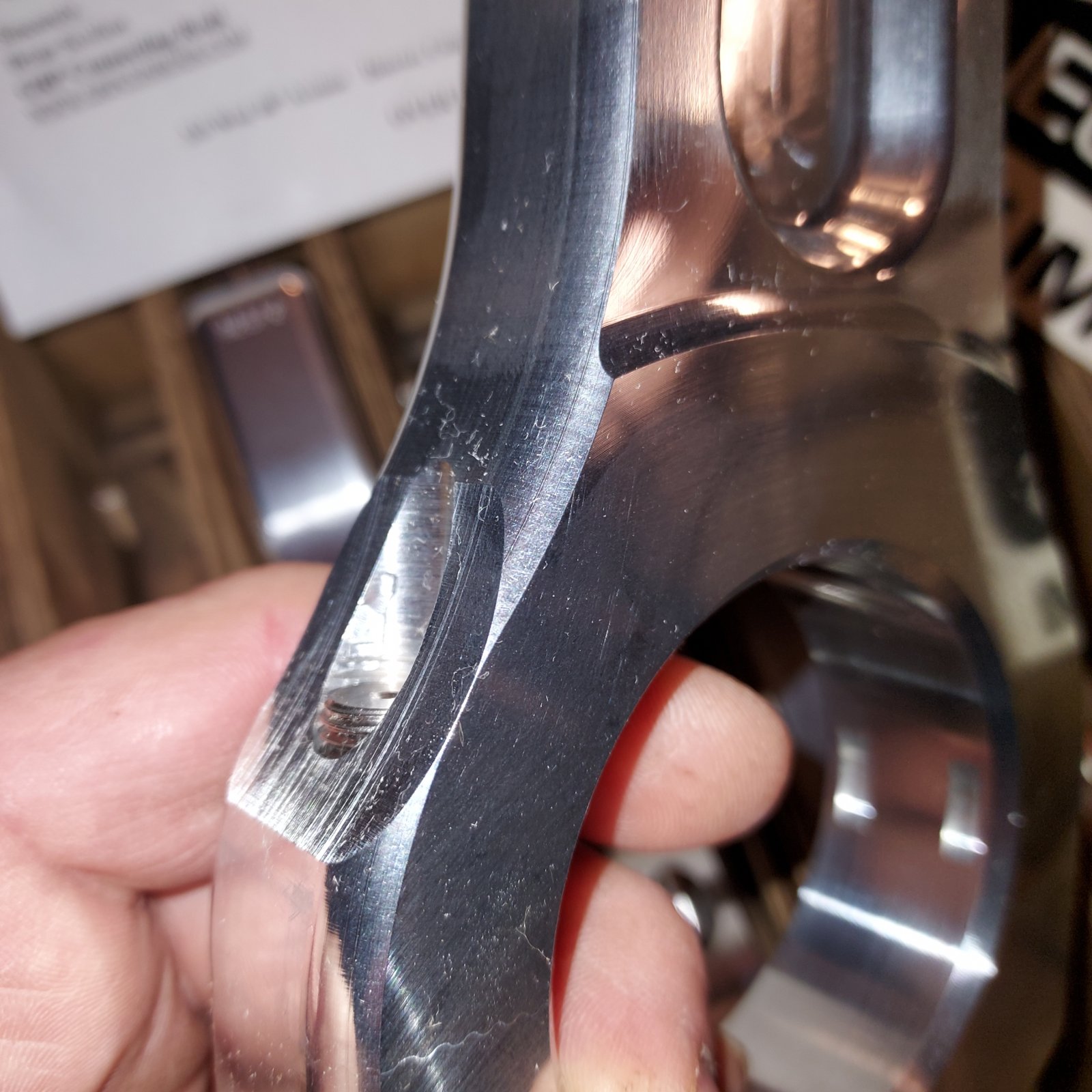

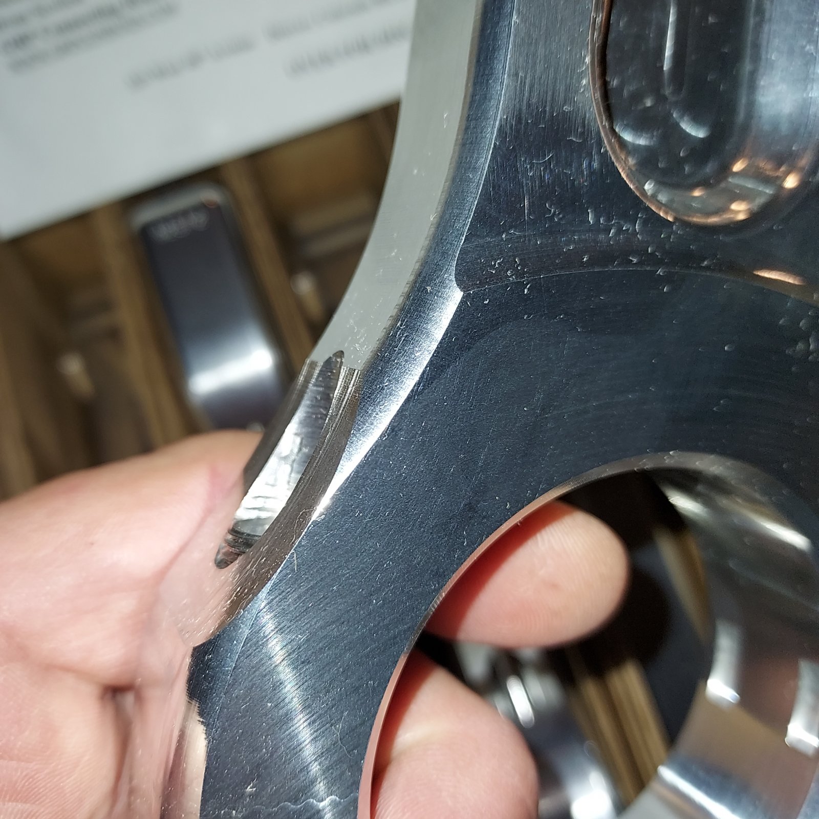

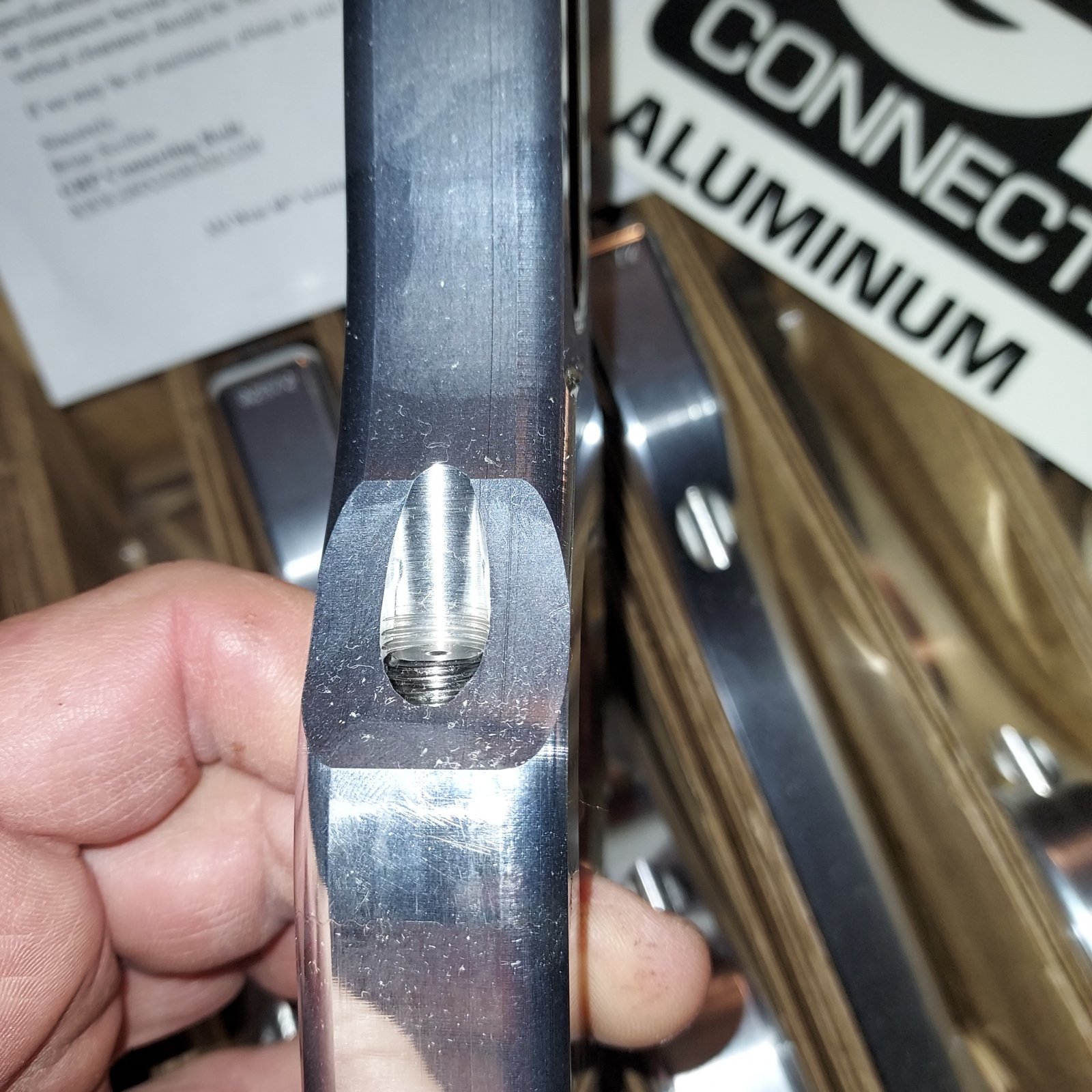

  9. Finally the rods that i ordered last October have shown up. Like my rods in the past they are GRP rods. They are cut from aluminum plate. They are .100 longer than a stock hemi rod to move the piston up away from the cranks counter weights. I use a block with the cam in the stock location. All big show fuel cars move the cam up in the block. The reason for this is the exhaust lobe will hit the rod when the cam gets in the .700 lift range. To fix this the rods are ordered cam cut. The big end gets machined for cam clearance on one side of the rod. The big stroker cranks and big aluminum rods can create all kinds of clearance issues. I almost forgot to mention last years price was 1250.00 this year its 1450.00 dollars. The big hemi will get finished this weekend. You might hear the thunder. 20220505_205548.jpg 20220505_205603.jpg 20220505_205607.jpg 20220505_205612.jpg

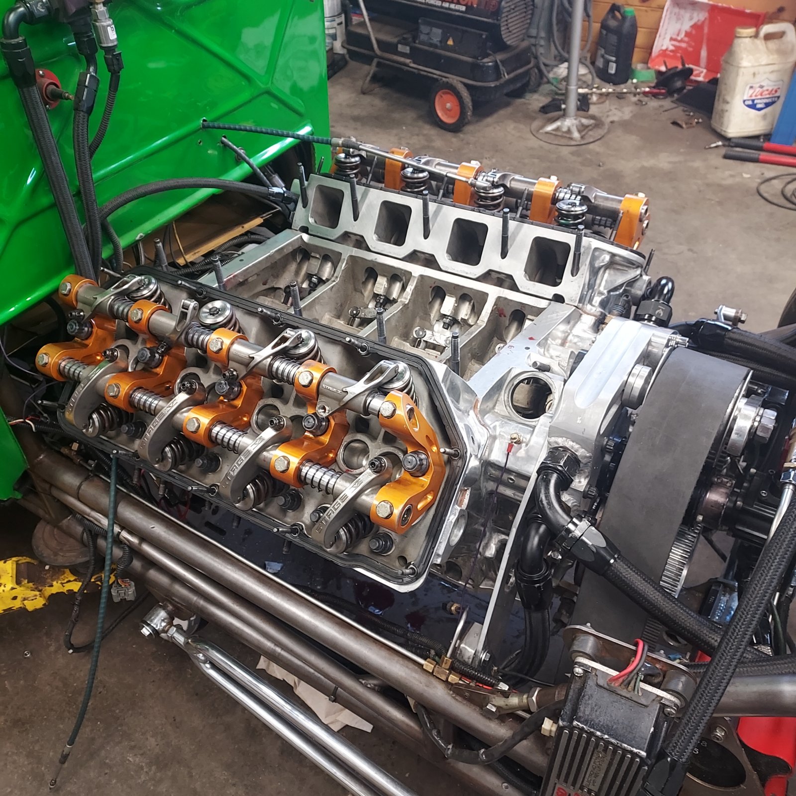

  11. Its time to build a nitro hemi. The bottom end is done. The top end goes on tomorrow. Hopefully a fire up Tuesday. 20220507_110107.jpg 20220507_110237.jpg 20220507_225925.jpg 20220507_180310.jpg

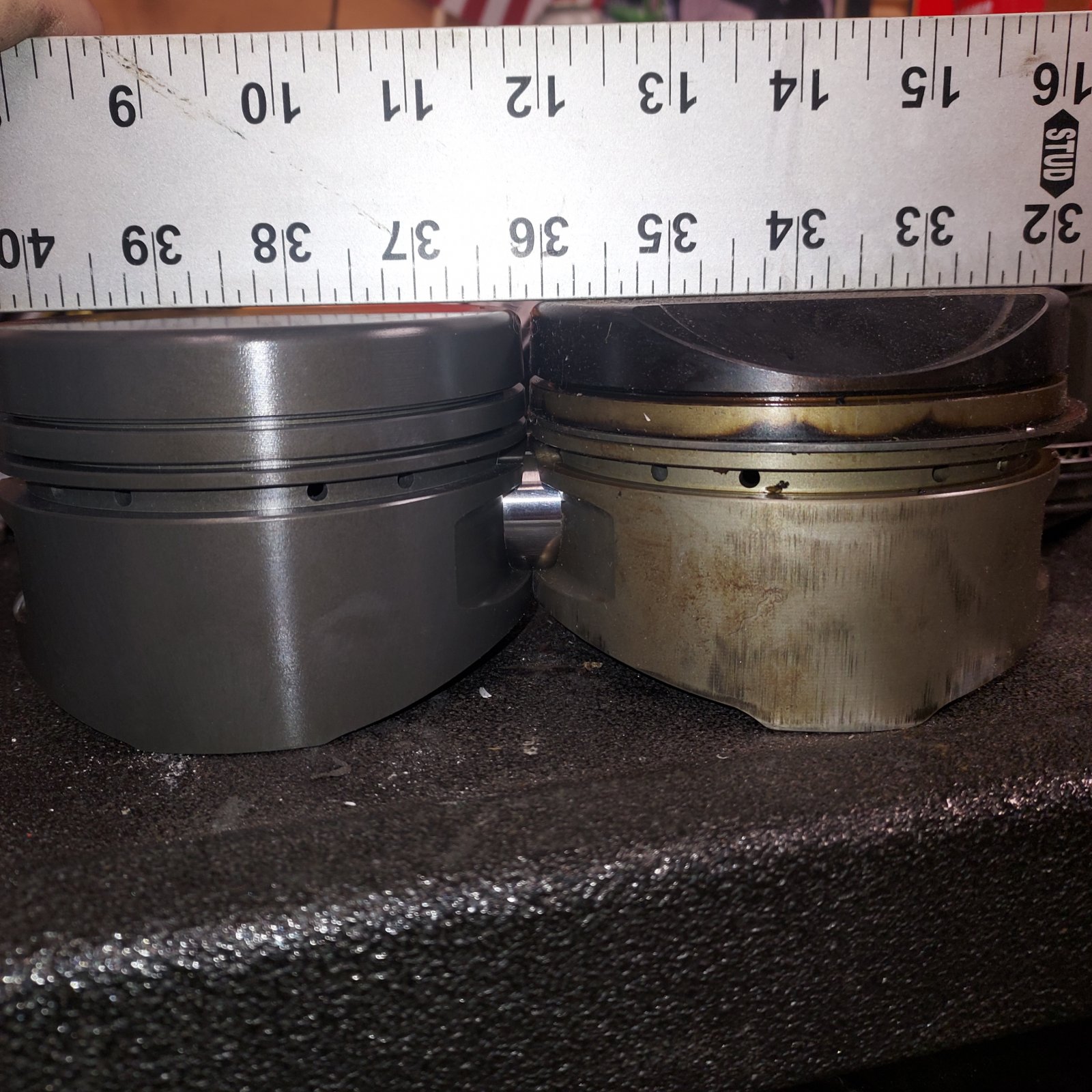

  12. I lowered the piston height .100 This dropped the compression from 7.5 to 6.8. This will hammer the bottom end less when i set the timing at 50 degrees of lead.
    I put a pin in the new piston and the old one to show the difference. The rings are in the same location. If i like this new set up i can put all of the old pistons in the lathe and cut them down to match. 20220506_204212.jpg

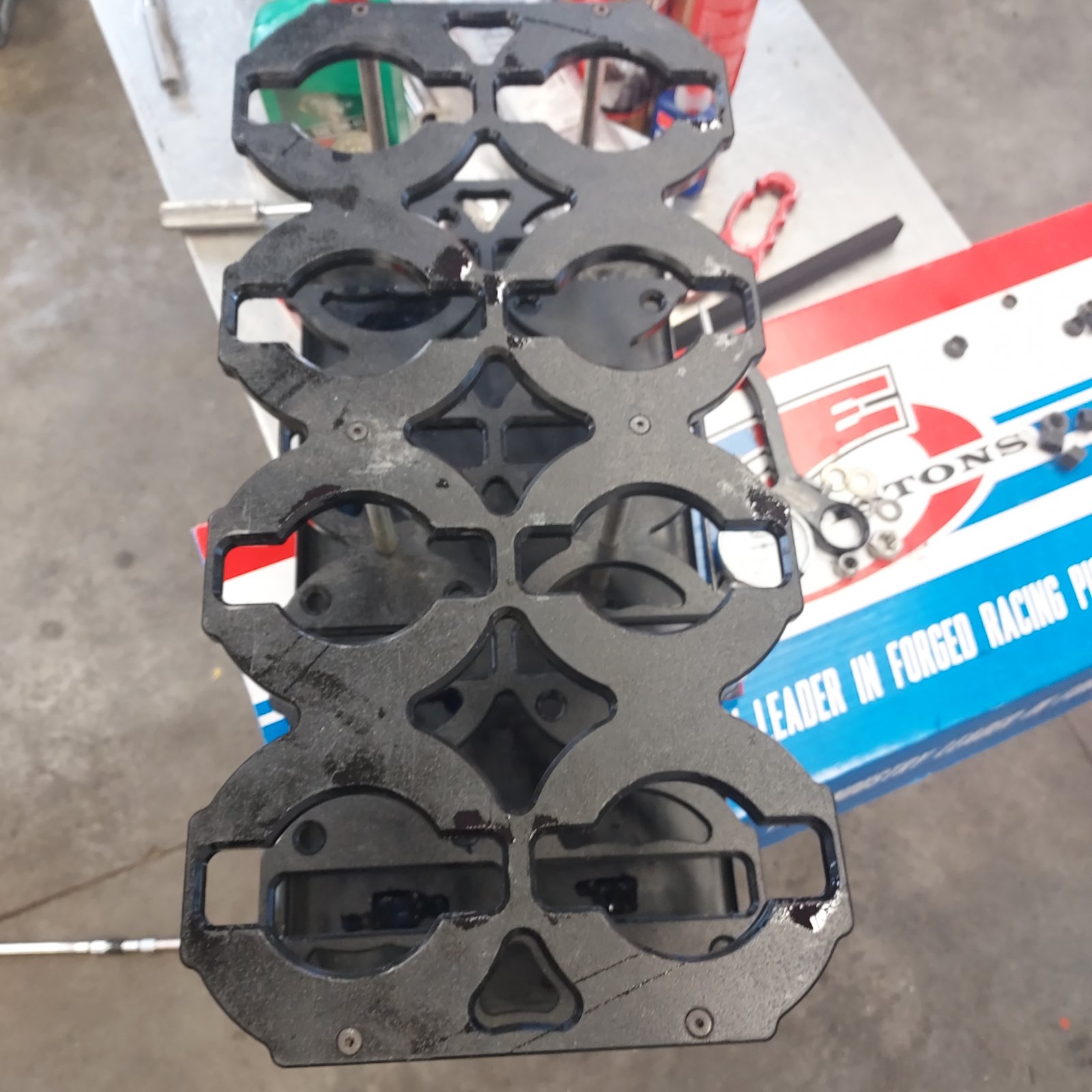

    I'd like to see a better picture of your piston/rod organizer/holder.
    Something you made?
  14. I will get you a pic. Its from wizzards warehouse. It holds the the rod ***embly and bearings. There are holes for the rod bolts and caps. Its plastic coated so it wont scratch the rods. A nice high quality piece.

    That piston rack IS nice. Thanx!
