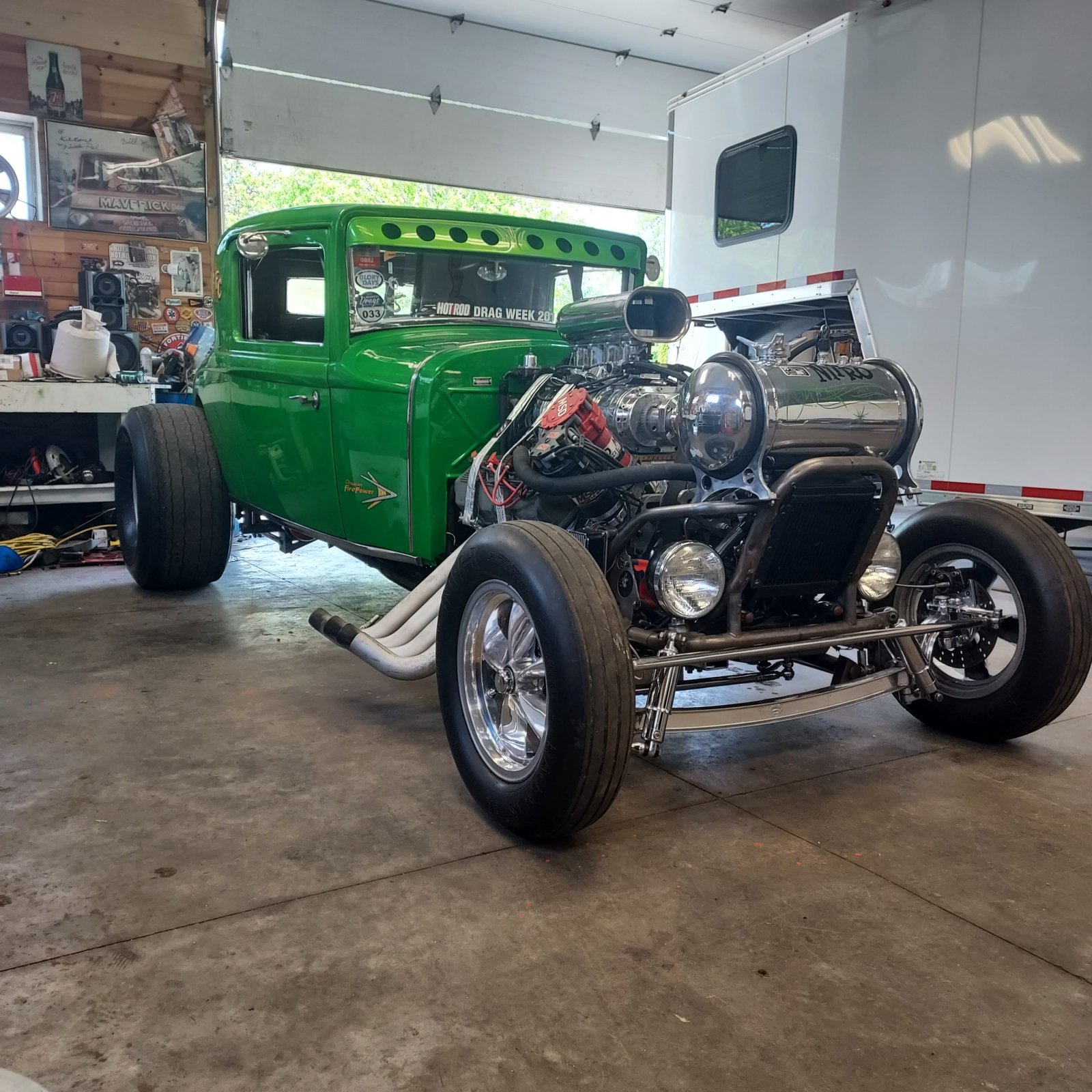

  10. I got home from work and went right into the shop. The battery was charged and it fired right up. I need to do some adjustments and some clean up. It might make the local cruise in saturday. 20220511_193902.jpg

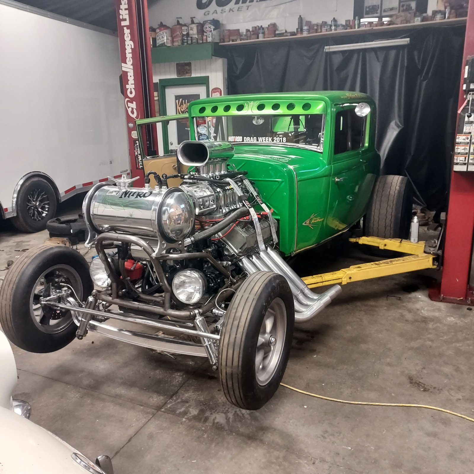

  19. This pic says alot. The double wall zoomies are on along with the diaper and trans blanket. Time to burn some nitro. 20220616_122951.jpg
