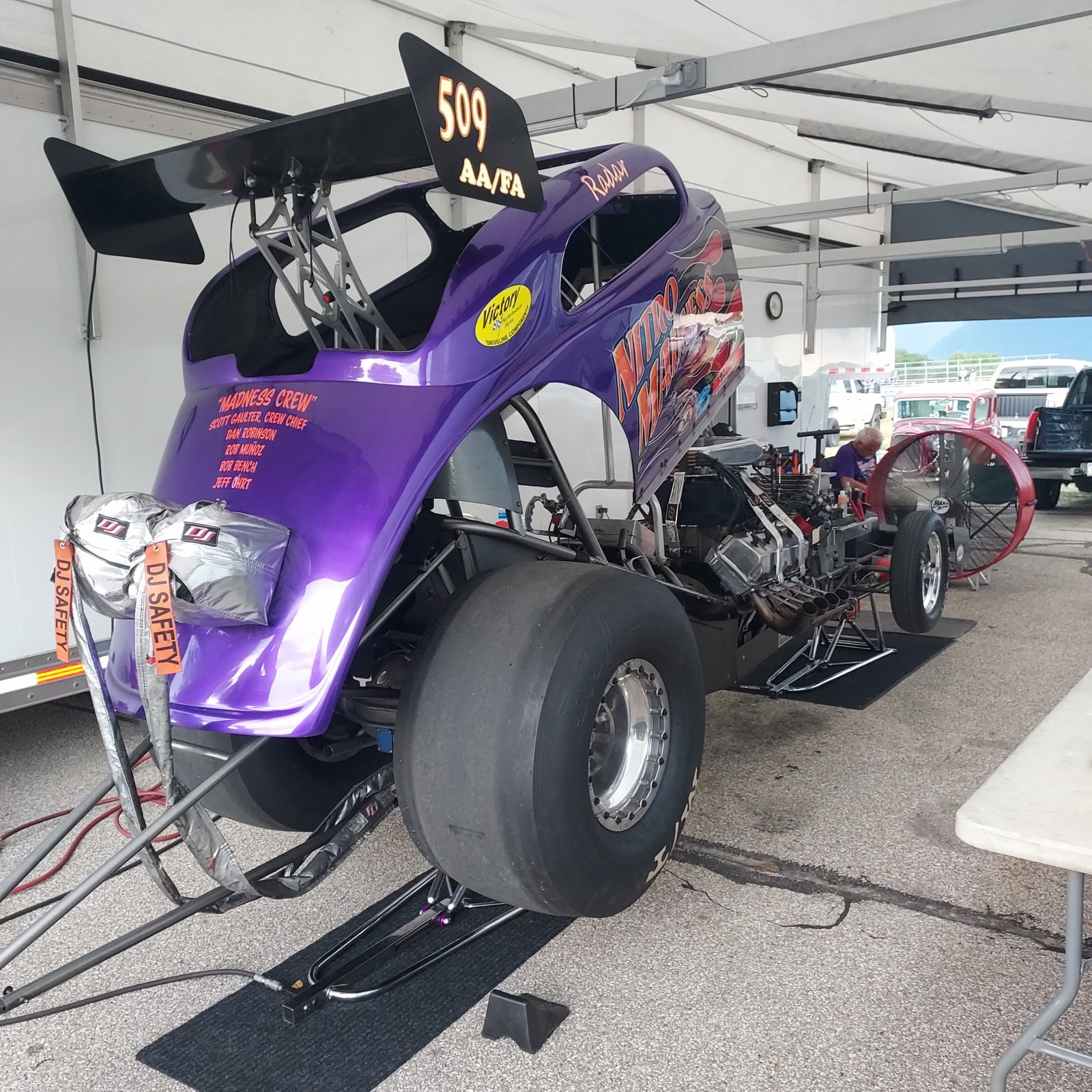

    Man that’s a great photo
    Jet96, racer-x and Stogy like this.
  6. Man,,,,,look at that pic,,,,,,,a blown Hemi Nitro fuel coupe,,,,,,waiting for combat !

  8. Fuel altereds are the undisputed bad *** hot rod. A nitro burning altered is the ultimate hot rod hands down. In the early 60s the had a fuel coupe cl***. The various cl***es morphed into a fuel altered cl***. They changed over to center steer cars and sported wings. They are considered the hardest cars to drive. Anything can happen on a p***. Lane swaps are not uncommon. Here are a few of this weeks contenders.

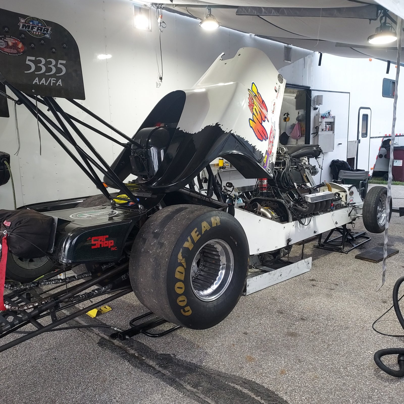

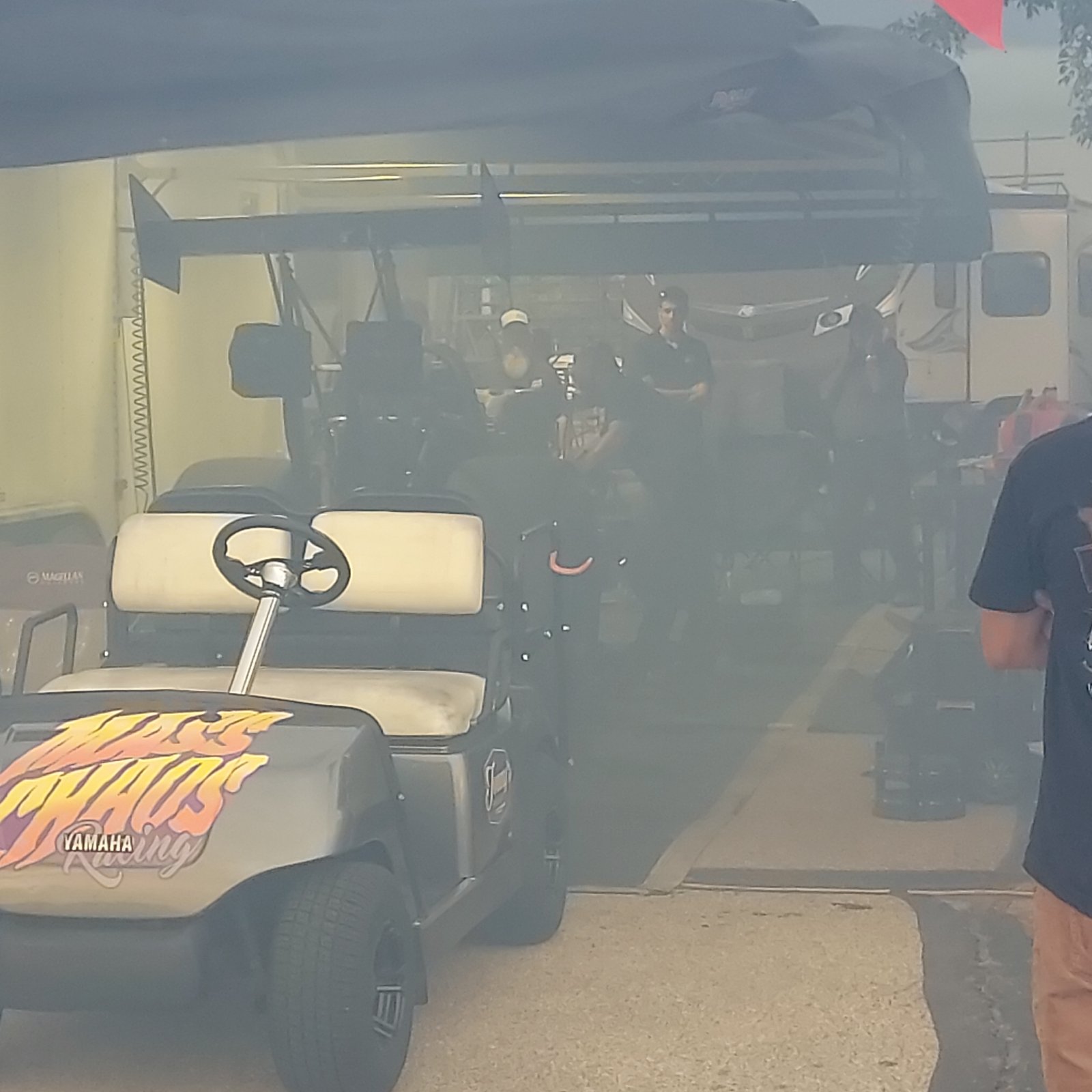

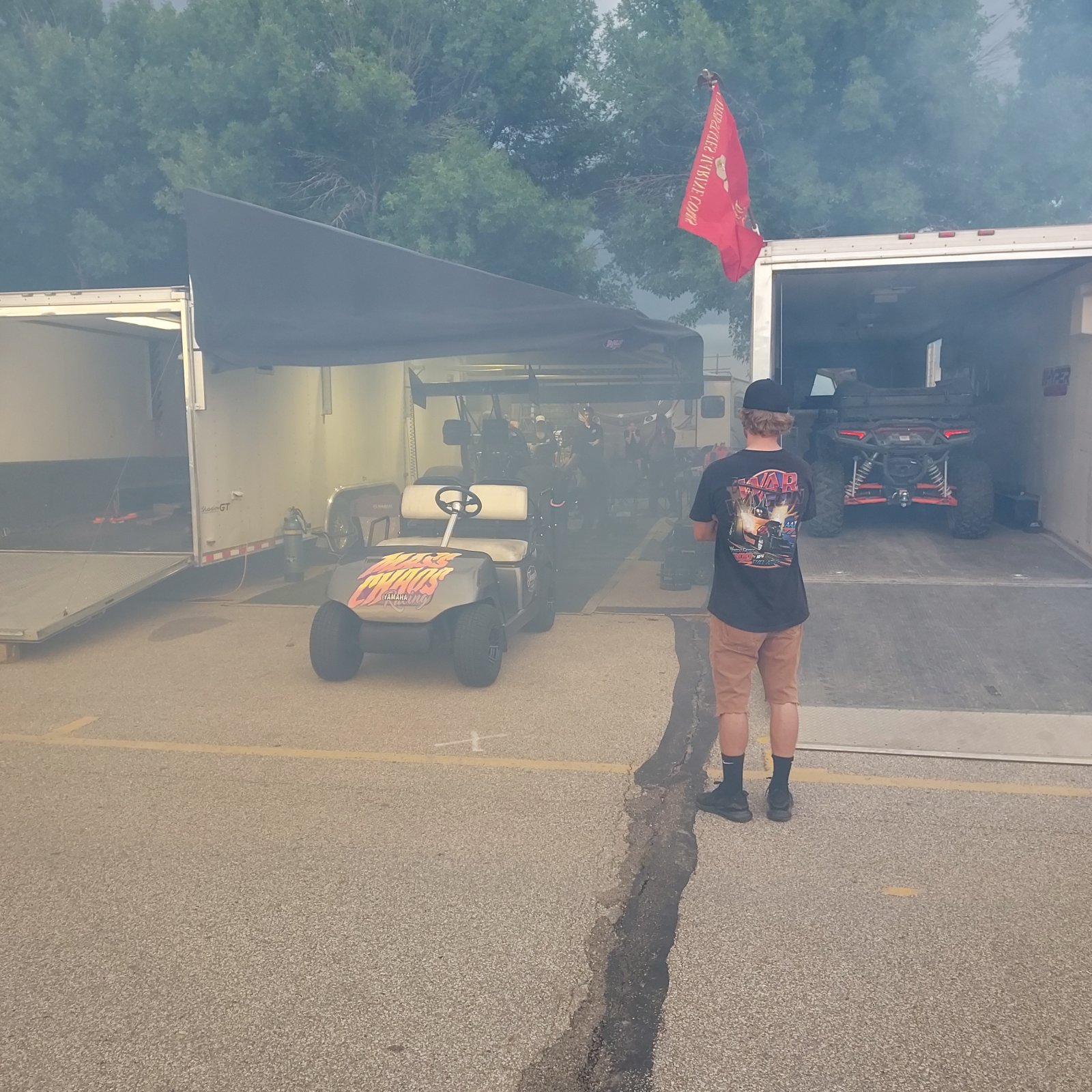

  10. 20220819_174120.jpg 20220819_174124.jpg The funky haze of a nitro car firing up never gets old. 20220819_175521.jpg 20220819_174347.jpg 20220819_174327.jpg 20220819_174308.jpg

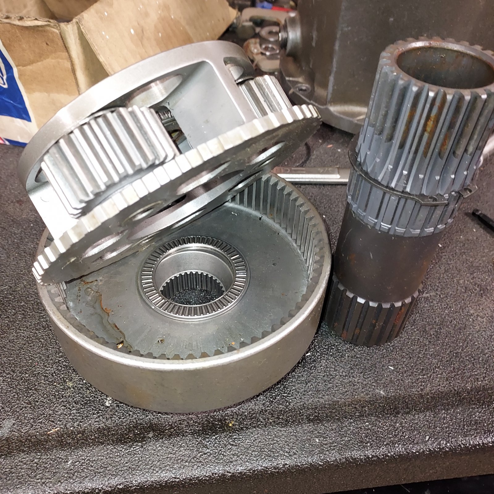

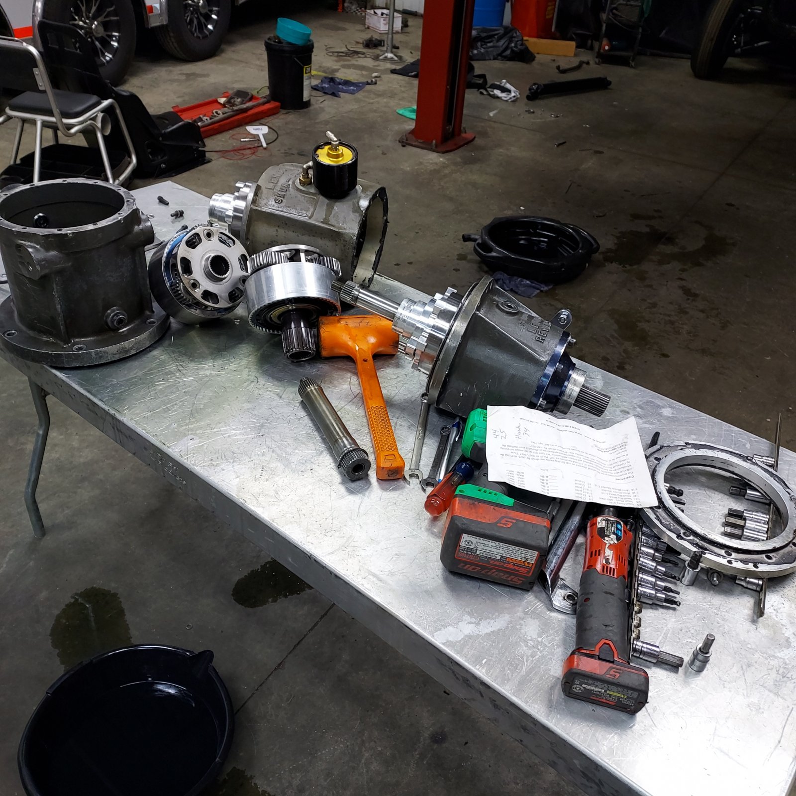

  12. Friday qualifying was rained out. Saturday we made two qualifying p***es. With all the new found horse power its very difficult to control. The car gets out of shape at the hit. I have maxed out all of the suspension tricks. I had a long drive home to think about whats going on. Its all very similiar to what my 65 awb did. That car was also uncontrolable. I cured that car with a first gear change in the lenco. I started with a 230 droppling it down to eventually a 1.81 ratio.
    Thats the current gear in the coupe. I just happen to have a gear set on the shelf that will give me a 1.675 that should calm things down. The nice thing it doesnt cost me 20220822_205810.jpg 20220822_205823.jpg 20220822_205852.jpg 20220822_205922.jpg any cash.

  14. Im very confident this is the way to go. The question is it enough. I will try it and if its not enough i will make another change. Too bad lenco got rid of their exchange policy years ago. For a hundred dollars gears could be exchanged. Now they need to be bought at over a grand a set.

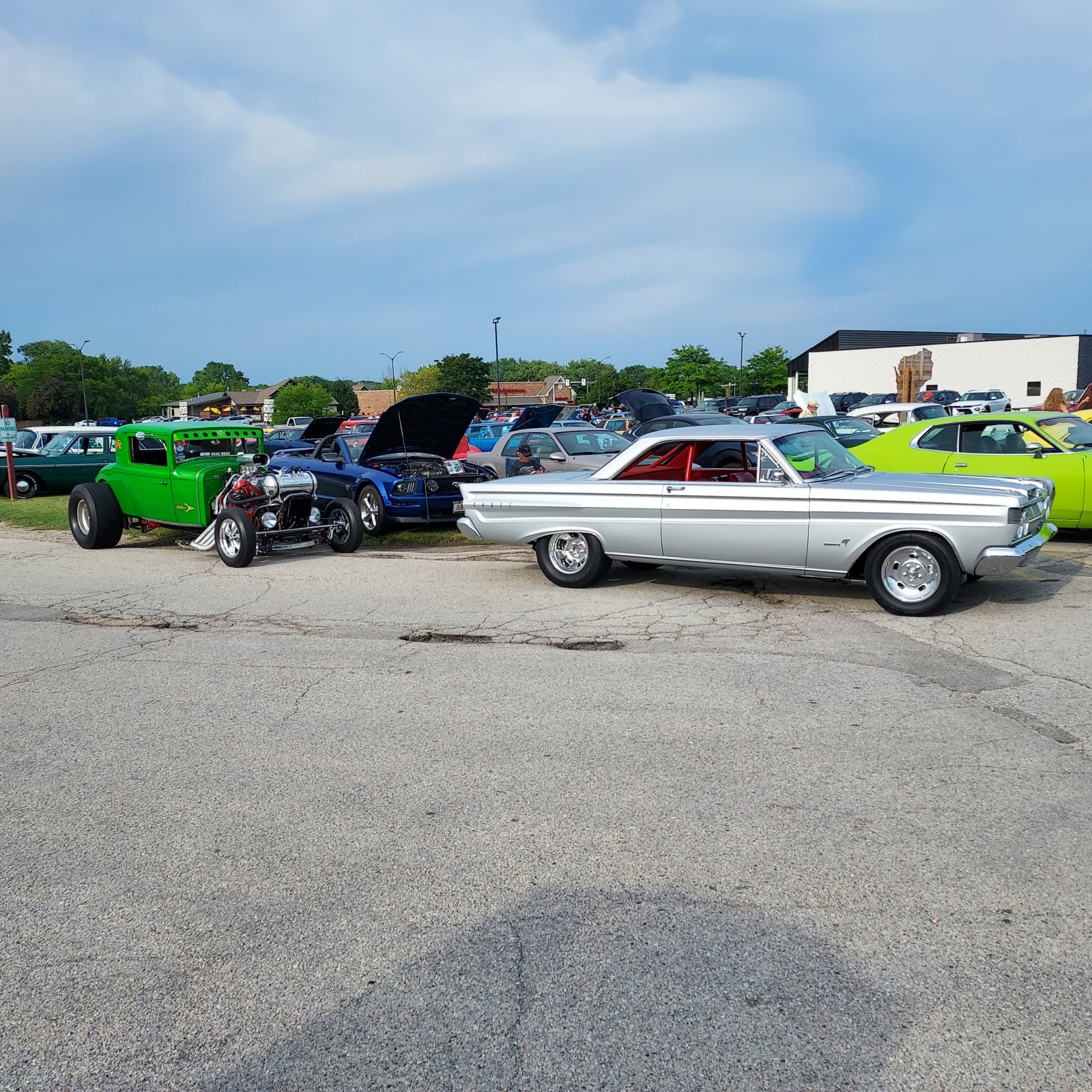

  15. I was bored today so i converted to car back to a street car. I drove it up to the local saturday car show. I can tell by the way it drives the first gear was changed. 20220827_170510.jpg

    Seems to me I have seen that silver Comet somewhere before.........

    Only 3 planet gears, I would of thought 4. Maybe not enough room.

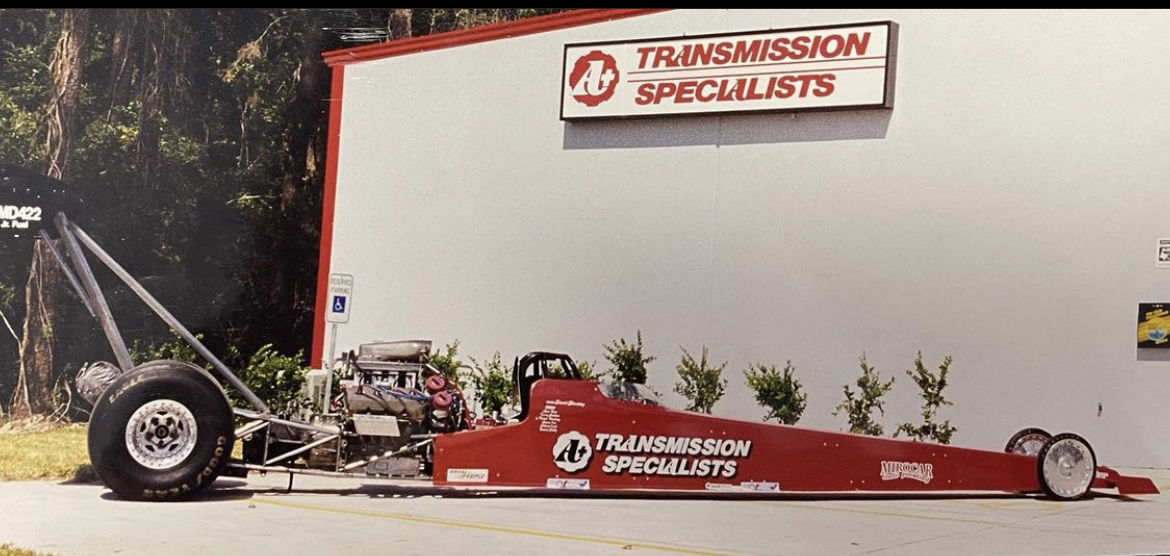

    Name one compe***ive car, running a significant load of nitro with a torque converter. Kyle Smith is turning TAFC upside down right now with a converter combination he and his father have worked their ***es off on- on alcohol of course. Anyone that I know that has tried it shows up with a clutch after being frustrated and entirely unsuccessful.
    Here is the A/ Fueler I campaigned this was pre nitro percentage rules, We ran the can.:

    That Dragster looks to be a Hard tail & long wheel base Big tire & TA/FC ( converter) in one of last 2 races on west swing I'm sure in semi or finals shuck tires or blew them off, again 125 inch wheel base hard tail big tire, Well Funned team look @ there inventory of parts & data , Apple & Oranges .

  27. Is that red dragster street legal? Can it pull a trailer? Does it have a fuel tank big enough to go a few hundred miles? How cool does it run in city traffic when its 90 plus degrees outside. Can it haul a crew member? Is it liscensed ***led and insured? Can it p*** a dmv inspection? How does it drive at night? Does that rigid suspension shake your teeth out after a eight hour drive? Where do the street tires get stored so they are available when it rains? Speaking of rain how do you stay dry and does it have a windshield wiper? Anyone with a cell phone and a debit card can build a race car. It takes a whole lot more to make a fast real street strip car. Its very obvious your compairing apples to oranges.
