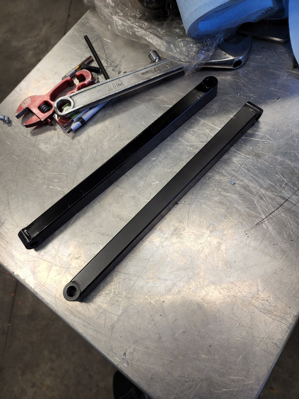

  9. My friend Howard Kaye came over and took some measurements so he can make some struts. Who better to do the work than a guy that worked at R+B Ch***is from 68-72 building some of the most famous cars ever. At the fall out i plan on making a p*** with the 1.67 ratio. Then a p*** on the 1.33 ratio. I will then put the struts in for a p***. It will be interesting to compare time slips. If all goes well the can will be tipped and the mag will be given a twist after the testing is done.
  10. 20220901_103024.jpg View attachment 5500871 The deed is done. Howard dropped them off. He even painted them. We will see what happens.

    kabinenroller
    If Howard made them I know they are strong enough. Probably 1/4” wall tubing.

  12. He used .125 tubing. Plenty strong. They look very nice. I'm very fortunate to have friends like this. It's cool to have a connection to R+B from the past. The place was legendary.
  13. You going to swap slicks when you use the struts? Different slicks like different suspensions.

  16. I don't have multiple sets of slicks laying around so I will use what I have. That being the spec tire used on all nhra legal front engine dragster. Ita a M+H 16x12.5x31. It's a soft forgiving tire. I run a inner tube to stiffen the side wall because my car is heavier than a dragster. Until I run it I won't have a direction on what the car needs. After some p***es a evaluation will happen.

  19. My old fuzzy brain seems to remember from my Bantam days that when I switched from sprung to solid I needed different slicks. Something about the compound, maybe?

    I would think that with the solid struts the slicks the Brian runs will be just fine he might possibly have to adjust pressure a bit but without testing who knows. they are the spec tire for nostalgia dragsters so I would think they will be just fine
  24. I don't plan on running the struts on the street. I would like to keep my fillings.

    Did you two apply some sort educated guess algorithm for the length on this first try? Do they emulate regular ride height or something along the ideal squat upon launch and not that over compressing car gets all crazy stuff. Or… do the shock mounts on the axle and possibly ch***is allow enough adjustment positions if not fine tuning?
    If that .125 wall chromoly bends then you’ll know it is making even more big power!
