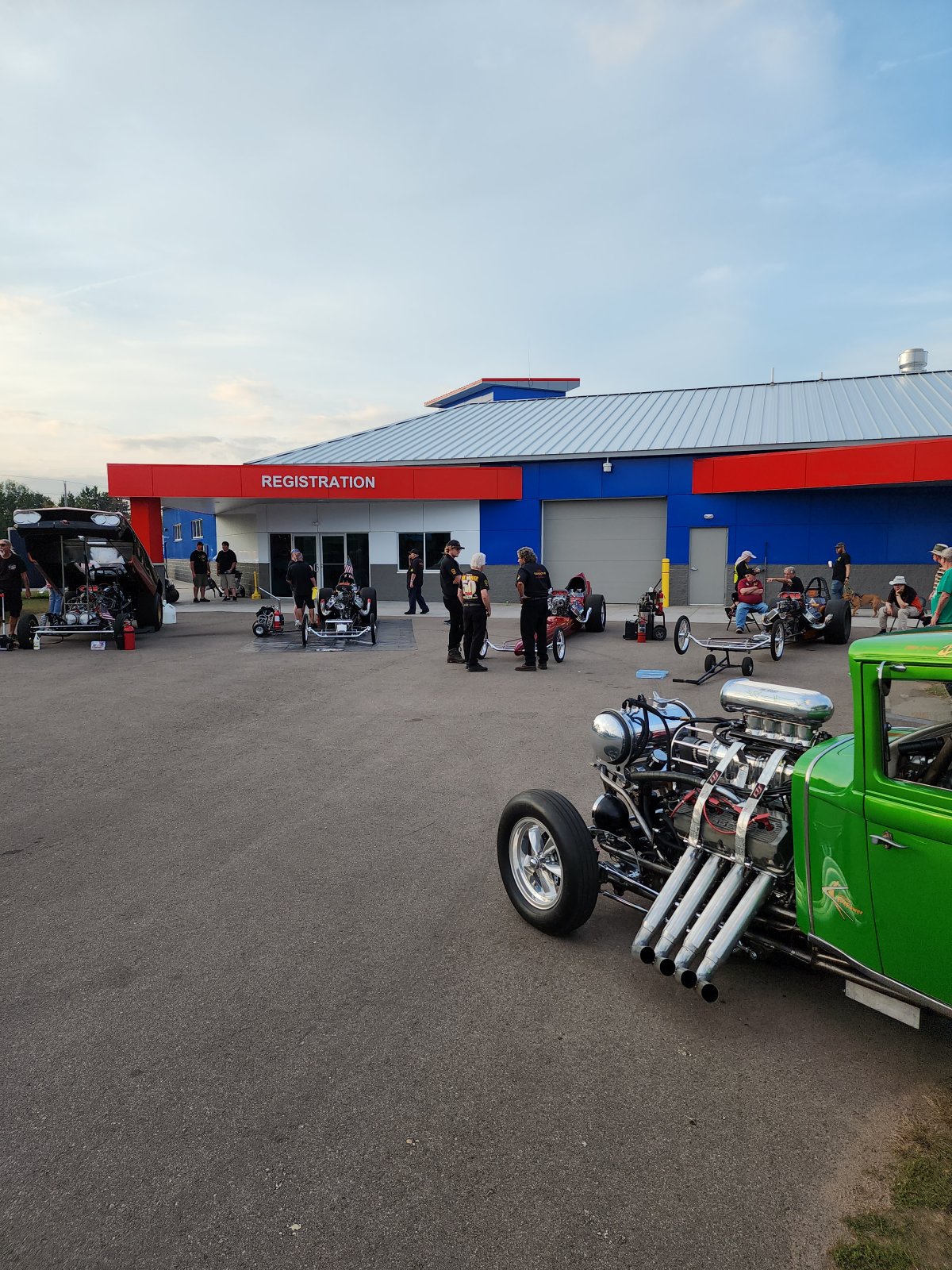

  10. All set up ready to go at Rock Falls for the fall out. Relaxing tonight. 20220915_212456.jpg 20220915_212436.jpg
