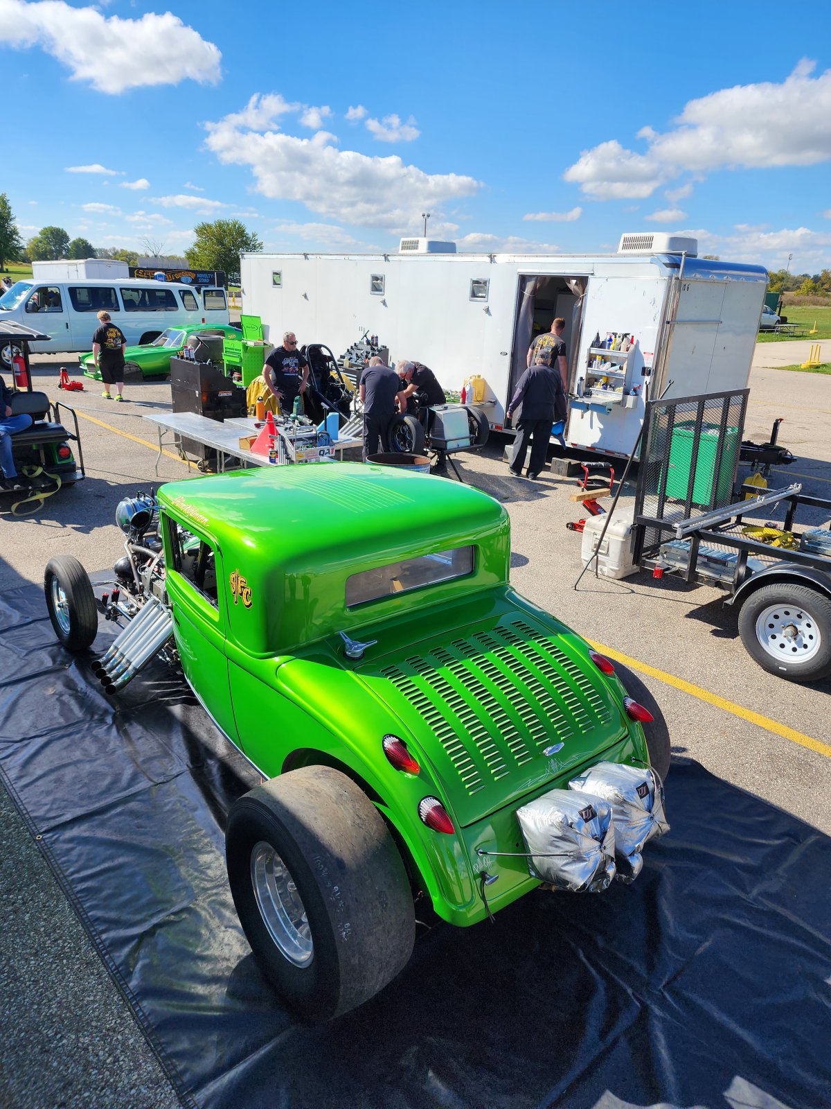

  14. 20221001_111219.jpg The new four link setting worked. The car goes from a to b without using the whole lane. The new tires also helped. After the first p*** I leaned it out some as it was too rich. After the second run I upped the nitro to 87 percent and the timing up to 48. It shook the tires hard at the hit. I drove through it only to drive into a track surface that was going away. It was the final points race for the snow mobiles so the track wasnt the greatest by then. The air temp and track temps cooled down by this time. The videos were gone over with my ch***is friend. He said the new ic is good but the rear shocks need to be set a little softer. All in all a great day. Anytime you can test and get useful information without setting the car on fire or throwing a rod it's good.
    If I can figure out how to post the videos I will share them.
