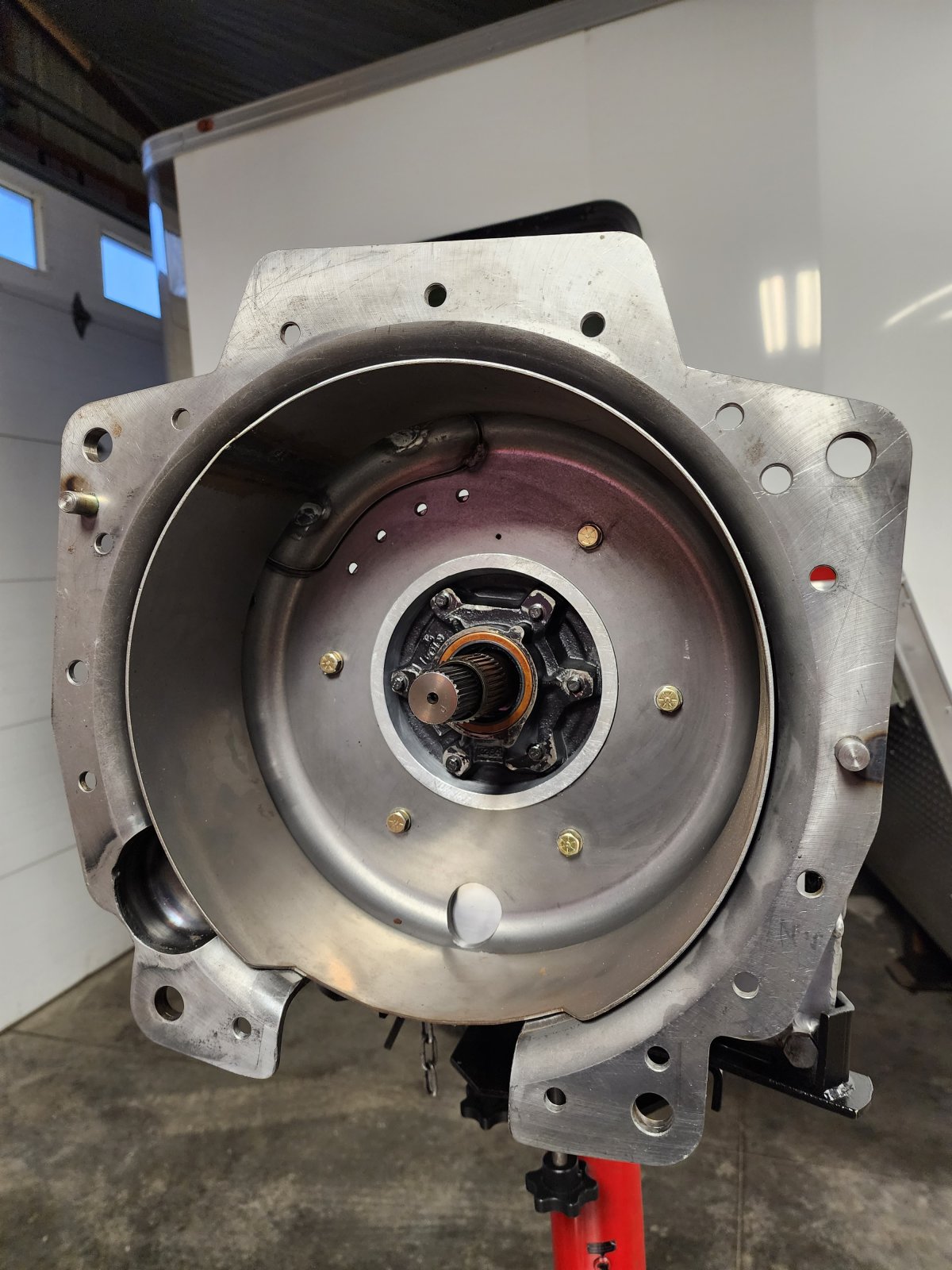

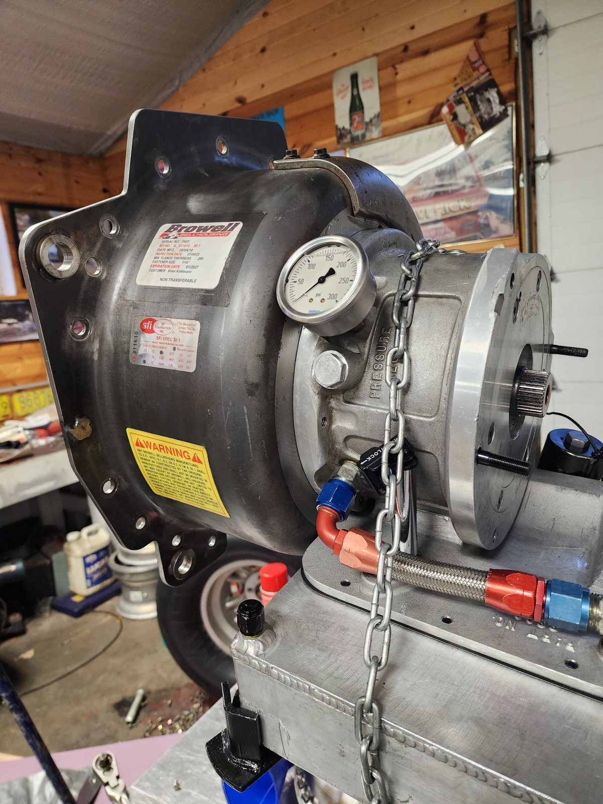

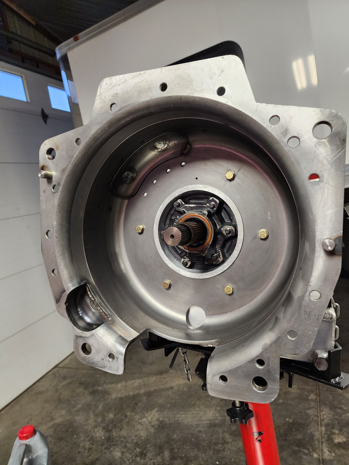

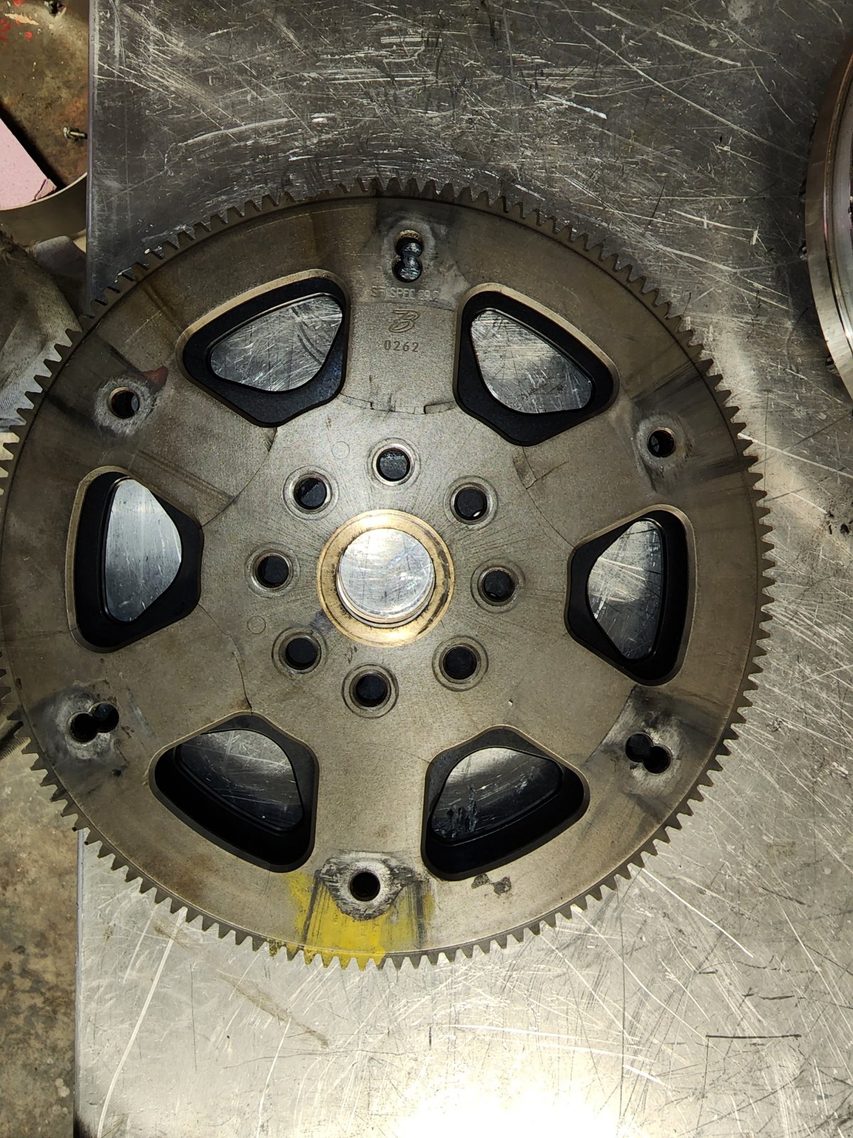

  7. I received the new flywheel as planned. I placed them over each other to see the new design better. There is much more material in the areas the other one cracked.
    I took a few pics of the bellhousing liner. Most on this site don't see these kinds of parts so I thought it would be interesting to see them. Clutch cars need the liner. Converter cars don't. I remove mine to save seven pounds. A single bolt holds it in place. These bellhousings are sfi safety rated. They require regular inspections and recertification to be legal to race. It may sound excessive or alot of extra bs but when your strapped into the car and something goes wrong it's all worth it. 20221014_173636.jpg 20221014_173720.jpg 20221014_173402.jpg 20221014_173328.jpg 20221014_173431.jpg 20221014_173337.jpg 20221014_173345.jpg

    Looks like they also added more material to the crank flange area by reducing the O.D. of the bronze bushing in the center.

    Guessing some harmonics get transferred through that piece.

    Noticing what looks like witness marks on the bronze bushing in the center of the failed flex plate I went back through the thread to find a picture of the front of the converter and how the new smaller bushing would match up with the converter. I would imagine there is supposed to be some clearance there as well even while ballooned.
    While looking back I found this photo from March 22 (post 4912). Not trying to be critical cause you certainly had your hands full back then, but looks like it had at least one crack back then.
  12. The hole for the bushing is the same size. The new design flips it. The flanged side of the bushing is now on the crank side. The mounts on the converter prevent it from bottoming out onto the bushing. The converter growth moves it back toward the pump in the Bruno unit. The .150 clearance is to prevent pump damage.
    Tomcat11 good eye. It looks like it might have been starting to crack at that time.
    I just need to put the trans back in this morning and it's a runner again. No trips to the track this weekend. The weather is bad cold and some rain. I don't like to race the car when it's below 55 degrees. It's dangerous. The track can't hold the power.
