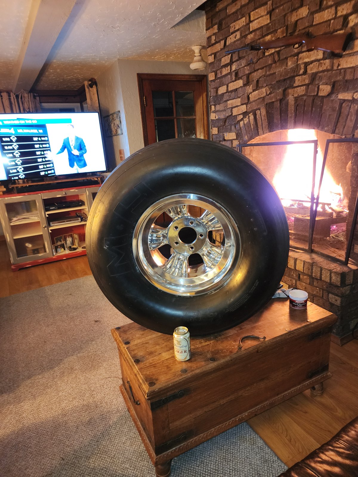

  27. It's that kind of night. Cold snowy weather here in se Wisconsin. I bring everything into the house that needs polishing. Next up the zoomies. 20221115_180147.jpg
